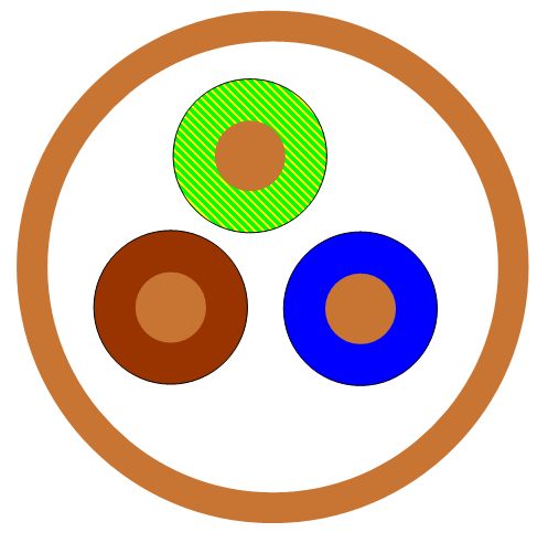

I certainly agree copper pipe and it's compression glands look like MICC, and give a good effect.
Also, seen it used in olde worlde pubs for wall lights.
15mm pipe, if painted, can even look like the old slip tube used in old houses with old wiring.
I suppose even microbore piping looks even more like MICC, yet getting conductors down that could be a problem.
However, since many on this site would understandably go beserk about using a blue water pipe to house cables underground, how different is this scenario?

Also, any argument that you shouldn't use copper tube as conduit in case someone thinks it's a water pipe would rule out the use of MICC, in case someone thinks it's a microbore CH pipe.
according to my trusty Casio, 3 x 1.5mm² singles 35% fill a 10mm microbore tube. Can't help thinking it would be a PITA to get them in, though.
