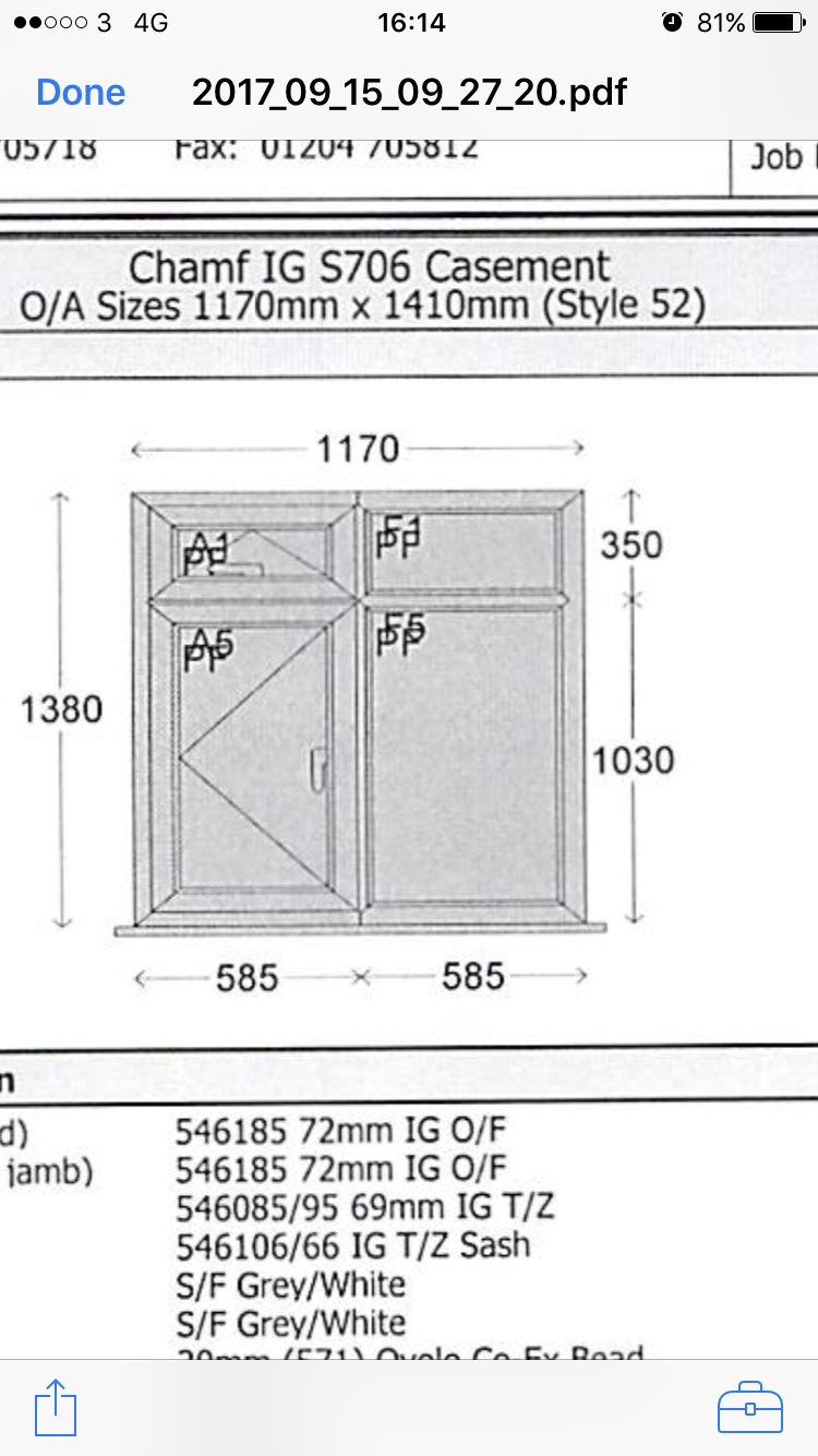

Are the hinges the same? I've got this window on a bedroom and want to order a similar one for a dormer loft conversion, if it qualifies as a fire exit.

It looks a tad narrow to me, if the bricks are metric it makes the window about 1130mm wide which would probably make the clear opening a bit smaller then 450mm. It needs to be min of 450mm x 750mm or min of 0.33 metre squared and min 450mm in either height or width. If you can get the side hung sash to be that, then it will qualify. Otherwise you need slightly wider window, or set mullion to one side so you have equal sight lines rather than mullion central in frame.
Your not far off at all Notch (y)
This is that window:
The loft one will have 3 slightly wider (650mm) windows and be the same style. I could easily climb out of that one.
