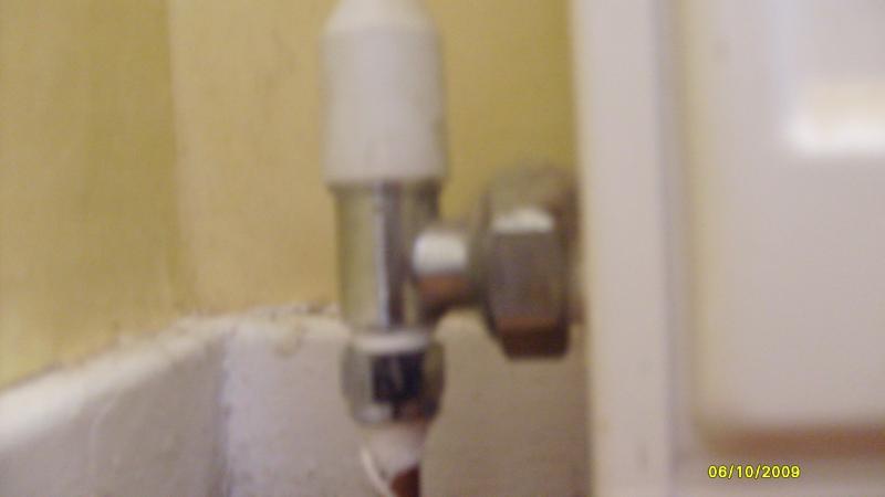

So - can anyone tell me what I am likely to find when I take the lockshield off - just an ordinary 8mm olive? -and where can I get the olive/reducer thing for the thermostatic valve and what is called?

8mm-15mmm reducing olive from one of the sheds? Seen one on B&Qs website but it was 3 piece (had a normal olive with it) (like the image posted) and the one that came off the other rad was 2 piece -no ring olive.
Trying to take a pic - but waiting for camera batteries to recharge...
Make of Thermostatic valve is Danfoss and it is definitely 8mm microbore and the valve looks 15mm...
Lockshield definitely looks like 8mm ....the nut is about 10mm wide...
Will post pics when batteries are charged...
The newer ones come as one piece, when you tighten them up you'll hear a crack and it will go loose, just nip it up a bit more.
Here are pics -
first is the reducing valve off the fixed radiator...pipe is mashed cos I was trying to get it out to see if there was a ring olive underneath...but measured it first - so it is 8mm
And white stuff on lockshield valve is PTFE tape (I know a pointless exercise...but I had to try something...)

Went to grahams today got normal 8 mm olives - but the reducing olive looked a bit different from the one I had...only two pieces but taller at the point where they fit in the valve ... The guy there said it would be ok - unless my thermostatic valve was a Danfoss...which of course it is... he told me the only place to get one was to ask a plumber for one of his spares...
Unbelievably luckily I got one ... I saw a plumber getting something out of his van - stopped and asked him ...and he gave me an identical one - very very very nice people plumbers :D :D :D :D :D :D
But does anyone know where I could get them in the future....if two have started leaking more will surely follow...and I would like to be more prepared... and can't count on being so lucky (I should have asked the plumber guy but was just too surprised to think of it....)

sadly the guy in grahams is talking balls
danfoss trvs come in 15mm (with a 15mm olive)
or 8/10 mm (with a 15 to 10 and 15 to 8 one piece reducer), the ones sooeey was talking about
you will get the one piece reducers from any big shed or merchants
