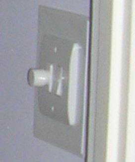

Hi - I need a switch plate which can operate a light with extractor and also other lights with dimmer function. I know that the fan cannot be attached to a dimmer but I'd ideally like only one switch plate with one of each type on. Any idea if these are available and where I might be able to get one?

You can buy dummy dimmer modules, they look like a dimmer but is a push on push off switch.
You then buy a two gang dimmer in the style you like.
Then remove one of the dimmers and fit your switch module.
I've done what you want in our nursery, MK grid array with a dimmer for the uplighter and the main ceiling light/fan on a normal switch...
Without waking little 40 watt this is the best piccy I have...
Thanks for the pic 40 Watt Spark. I think the MK grid is the best looking so far - thanks to those who suggested - I think this is the way to go.
