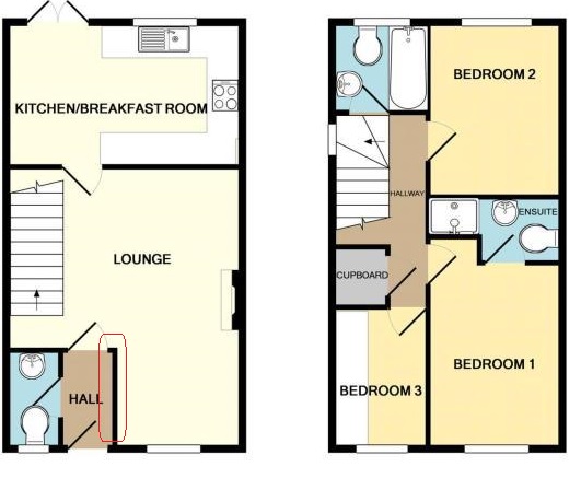

Hi,
Just bought a house with a tiny tiny almost pointless hallway. I would like to knock the wall down to remove the hallway but I was surprised to find breeze blocks behind the plasterboard when i cut a small hole. Can anyone advise if they think this is a supporting wall?
Wall to be removed circled in red:

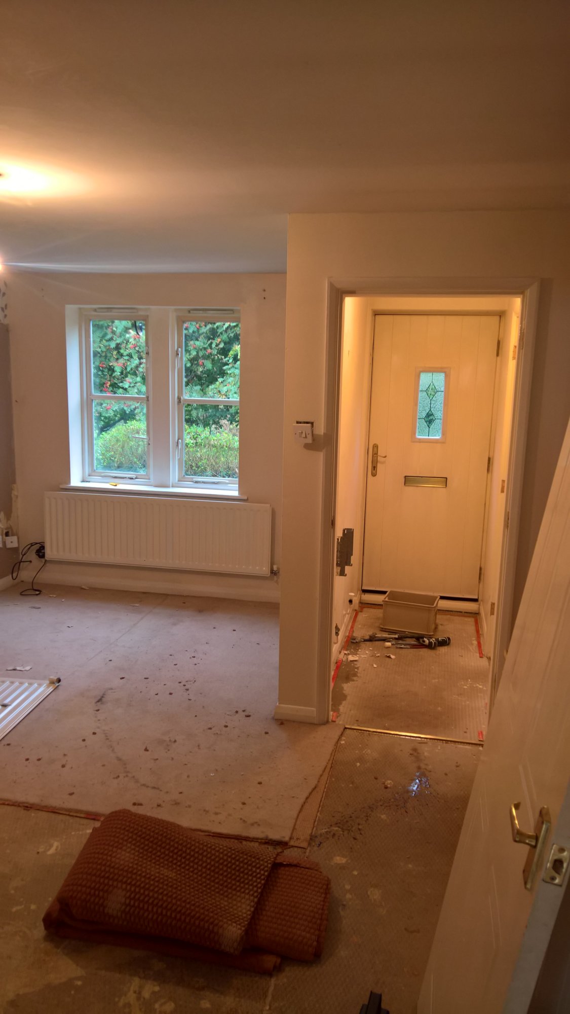

Photos:
It shouldn't be, but the joists will be going from left to right, and as long as none of them are resting on that wall, then you should be fine. Also, there should be a double joist at the start of the stairs, that will then support a stringer going along the side od the stairs, that then supports the joists going from the stairs to the opposite wall. I hope you can get my drift.
Ok, so lift floor up from upstairs and ensure no joists are resting on the wall? Why would they use breeze blocks on that wall?
Yes to the first point, and no idea to the second; but that's why you need to check, in case they've been lazy, and used short joists wherever possible.
You also need to check that the wall between bedroom 3 and 1 and subsequently the ceiling in the bedrooms or your roof isn't supported by the hall wall you intend to remove.
Its possible that this hall wall adds sufficient bearing to the joists to resist this bedroom wall load whether that is breeze block or just studwork.
You really need to look both under your upstairs floorboards and up in the loft to determine the load path. Simply looking under the floorboards isnt sufficient by any means.
Calculations may be required depending on what you find. However if you post pictures the need for calcs can be determined relatively easy.

Ok, had a builder round and lifted up the floor. The joists were resting on the wall, the joists span all the way to the other side though - they are not cut near the wall.
The builder believes the length of the joists is just under the limit to run without support and thinks it will be fine, not sure what everyone else thinks?
Also the wall for bedrooms 3 and 1 is not above the wall, its about 150mm before the wall

If the joists are continuous between the two side walls and one piece then they are not bearing on that hall wall.
