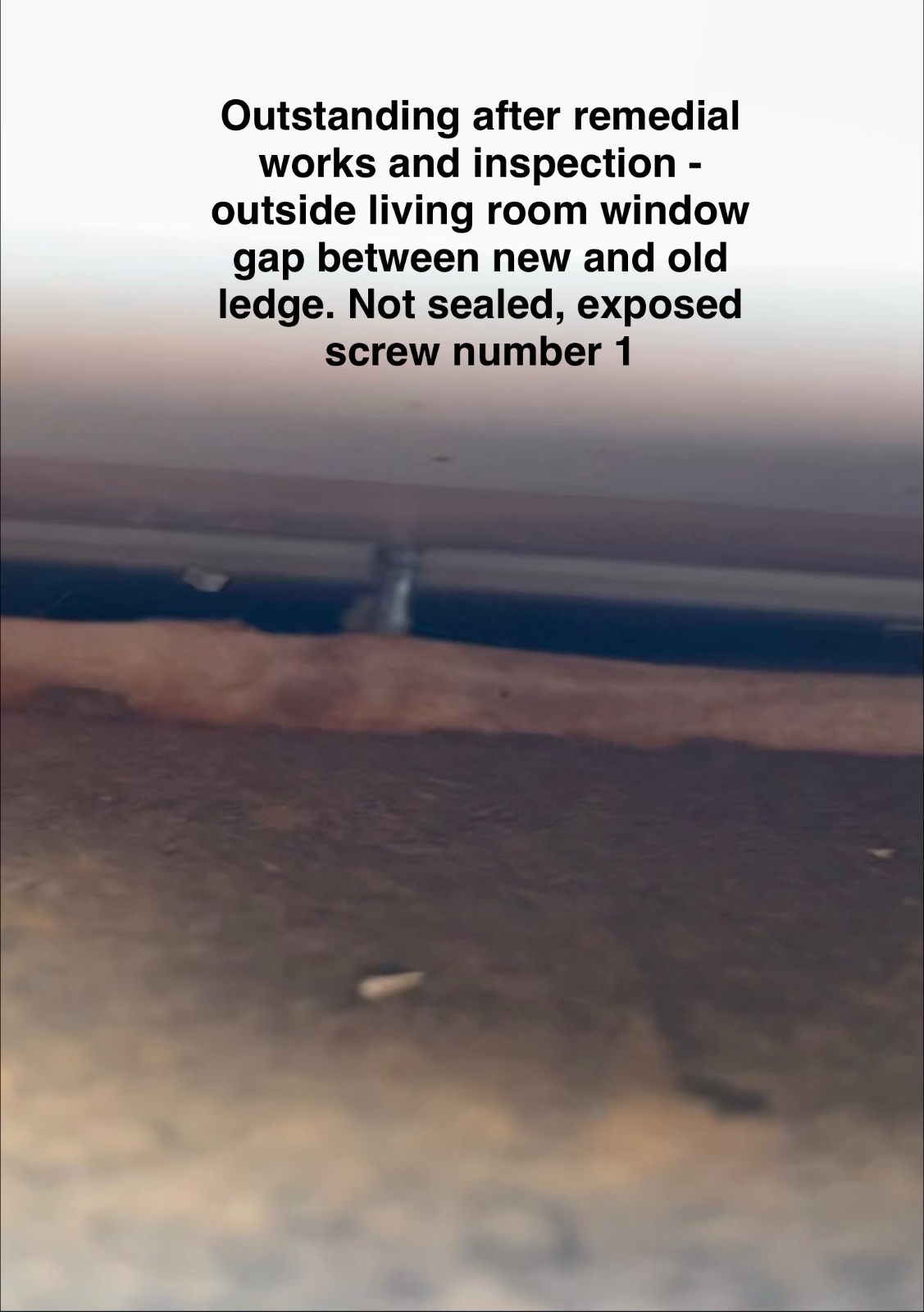

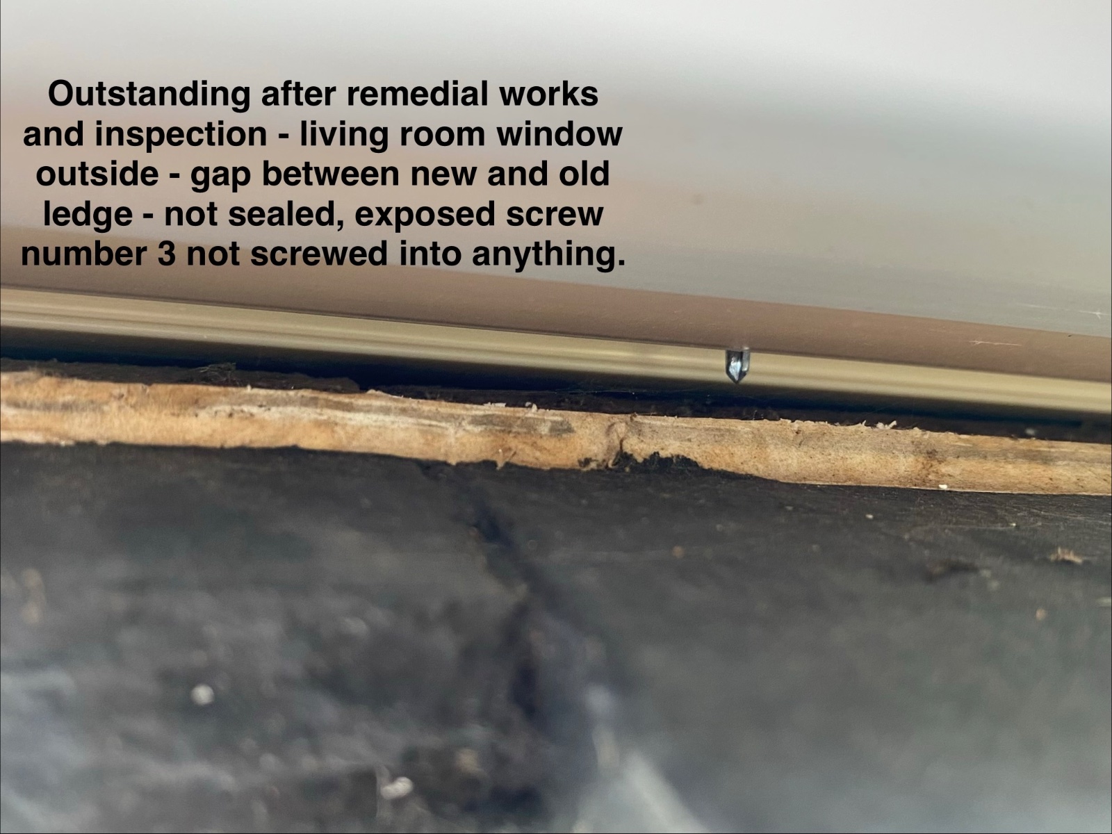

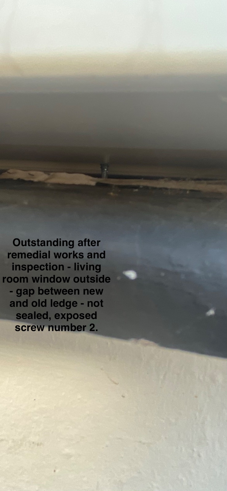

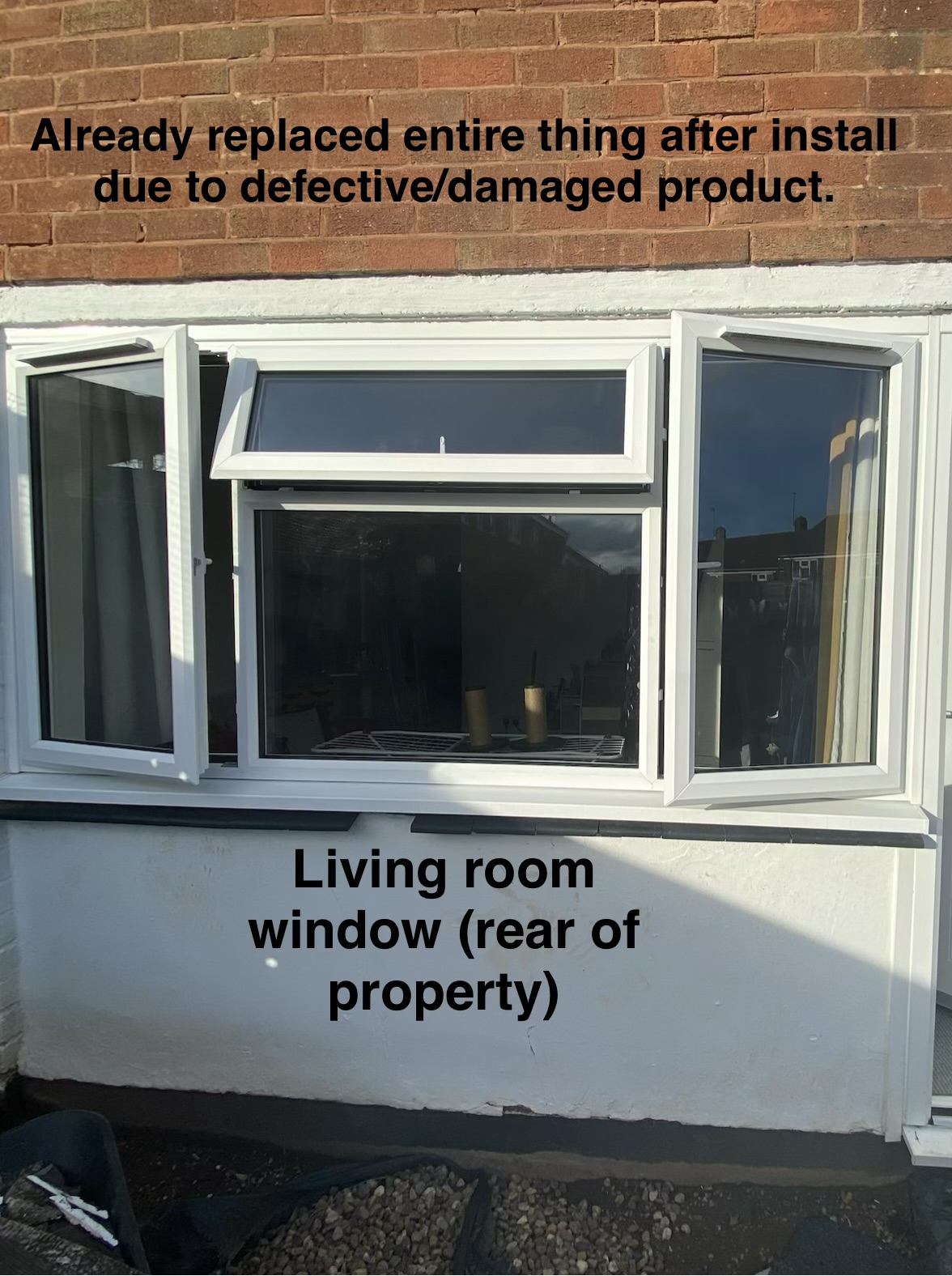

Update to say that things are still outstanding. 3 failed attempts given to them to identify and rectify issues. They quite childishly decided to renege on fixing what’s outstanding, claiming they are happy, post inspections, with the install. Note I got out into my back garden for the first time in a while after they decided that was their official stance, and I discovered more issues.
I’m just a tenant for a well known housing association and Anglian are their contractors, yet for some reason I’ve had to do all the chasing in this for more than 8 months and counting.
Photos included of the outside of my living room window which is what I noticed after they said they’d gone above and beyond to appease me and could do no more.
I’ve opened a case with the Housing Ombudsman and contacted fensa, but can you imagine the state of the parts I can’t see? The parts they didn’t forget to hide. Or of the ones on thousands of other properties they’ve installed over the last 10 years with their £21mil contract.
It's been left unsealed because they can't get their silicone nozzle in because of the quarry tiled cill, not your problem I know but as a service engineer I know exactly why it's not been sealed, maybe been better off using a 85mm stub cill and not that 150mm

Yes but at the very least the screws should penetrate at least 40mm into concrete/brick/masonry.
You’re right that it’s not on me, they should have communicated with each other about what to do rather than just leave it like that. The housing association are ultimately responsible for their contractors and I’ve no doubt they would have instructed Anglian to cut corners, it’s just the way Anglian have acted about my raising the issues and they failing to meet reasonable adjustments by thoroughly inspecting everything to identify issues. Dishonesty throughout from all involved, it’s gross behaviour.
