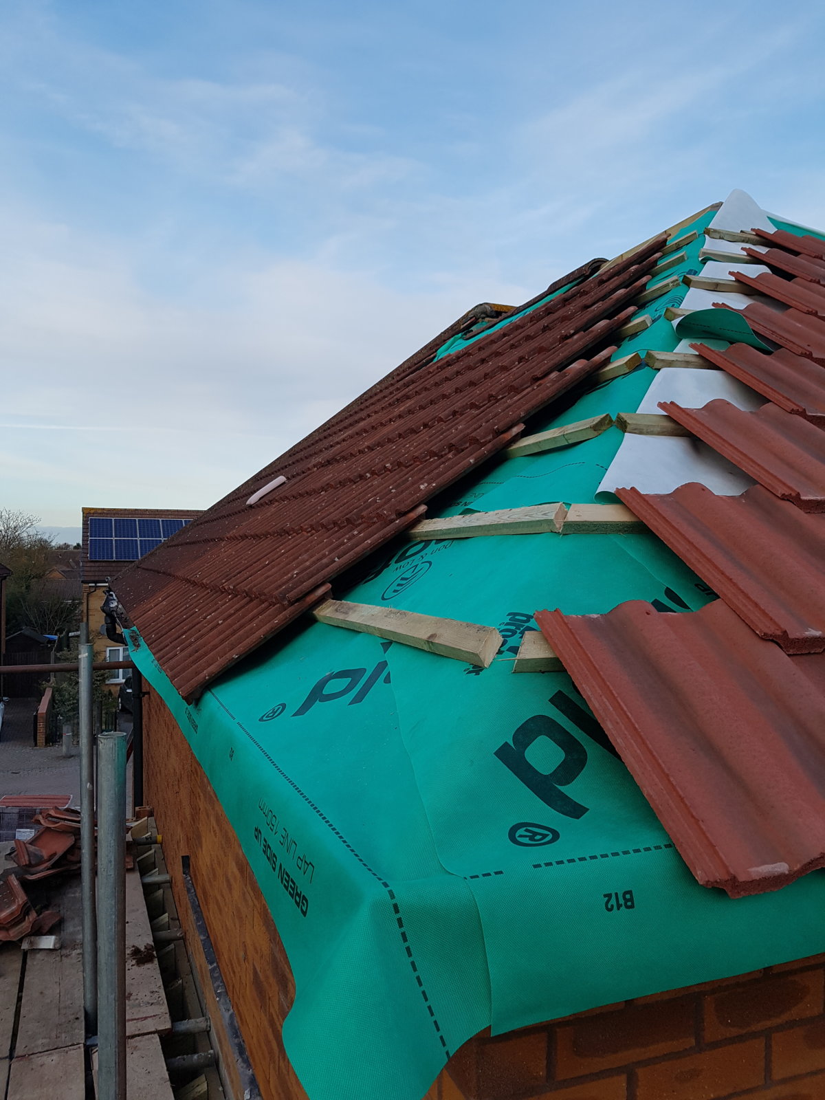

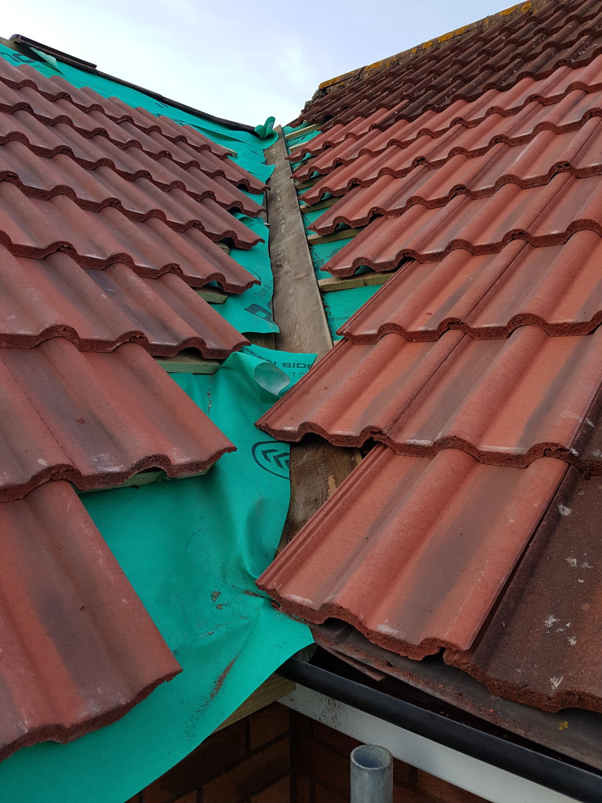

Any advice welcome.
Roofers have been and felt looks folded over and likely to cause pockets and possible pooling.
Should I be worried or are they likely to correct this going forward and I shouldn't worry just yet?
Many thanks

the hip picture makes no sense.I expect water to run under the folded back laps.

If they have left the valley like that then I hope there isn't much underneath.
It may yet be.
Unsurprisingly the roof is leaking in the current rain. Builder summoned to explain and point out damaged felting, and odd choice of build order.
They spend this week attaching tiles and measuring fascia, I would have thought should have got felting right, then the valley and eaves trays. Then maybe put some tiles on. Then ridge tiles, and then maybe worried about fascia and guttering.
