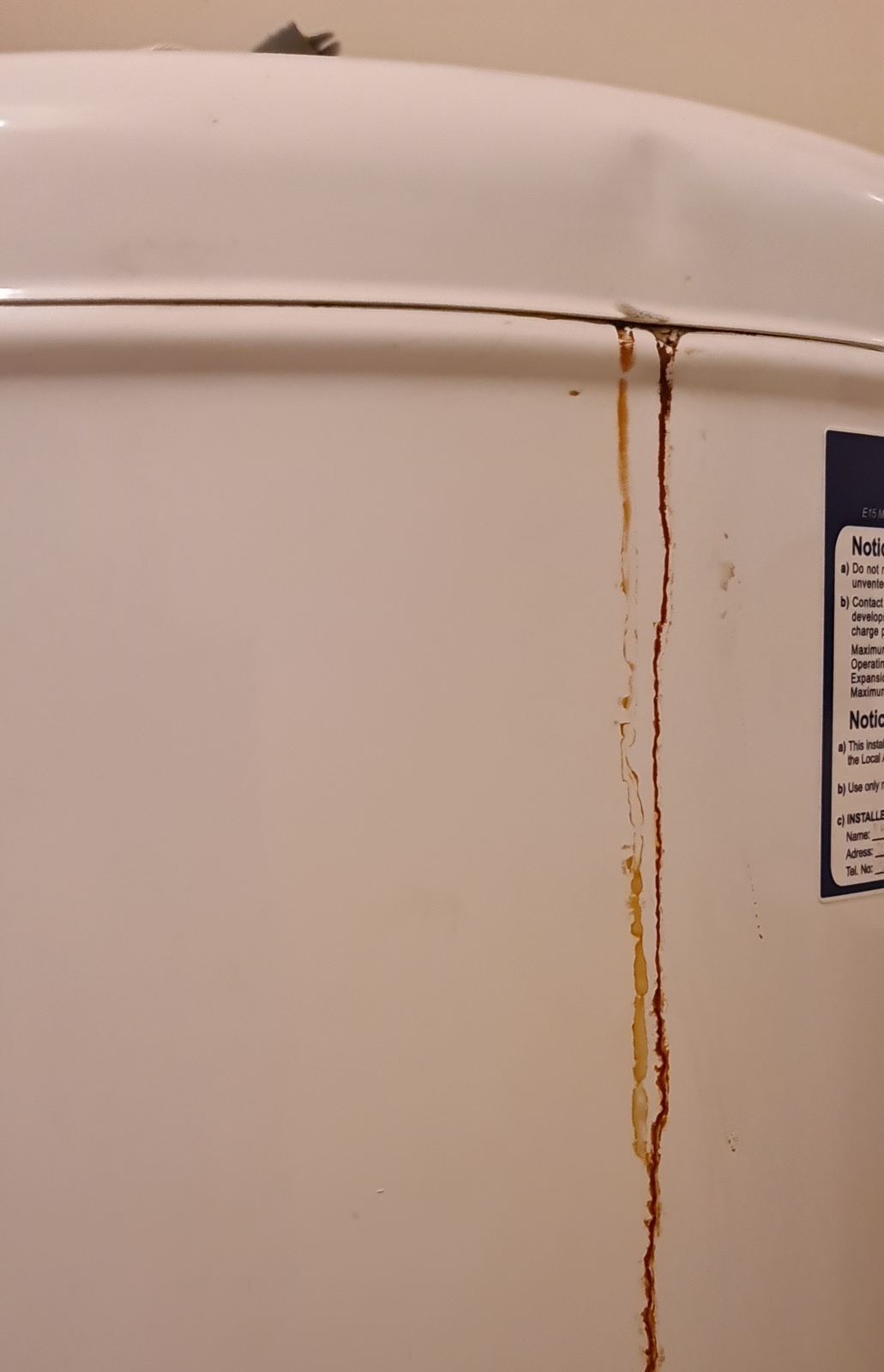

Hi,
Pretty sure I know the answer, but I presume this means the cylinder is done with and needs replacing? There is a small amount of water coming out when the hot water is on (it's system water not the hot water).
The dent was there when we moved in and appears to have been done before or during install, looks to me it's the reason for the failure?

Post a pic of the top...it may just be the top connection leaking and the water's run over the insulation corroding the steel outer jacket (that's only there for appearance).

Deffo leaking from the join. The top connection is sound.

Engineer is coming tomorrow to look at it. It's definitely rusted, checking it over it's rusty at the bottom too in quite a few places.
Funnily enough it is an OSO, I take it they are known for this then? It does have an internal bubble. Last time it was checked it was ok and everything has been working fine as far as I know (no expert though!)
Looking at the photo, it's had a good dink put in it, directly above the leak, at some time in the (recent?) past!
It was there when we moved in 5 years ago. It's about 12 years old. I suspect it was done before fitting or by the installers as there's a few other dents that wouldn't have been done by a householder owing to where they are. Easy to get away with I suppose as it'll last long enough to not come back to haunt you. The installer is no longer in business. Not much of a surprise lol
The dent is in the outer casing.....and would have little effect on the inner tank. In fact many of us happily screw our pipe clips into the outer shell.
If the top connection really is sound then the inner tank has probably failed.
I am one who screws backplates into a UV:).
That dink/crease in the outer skin has obviously created an escape route for an inner leak (y)
