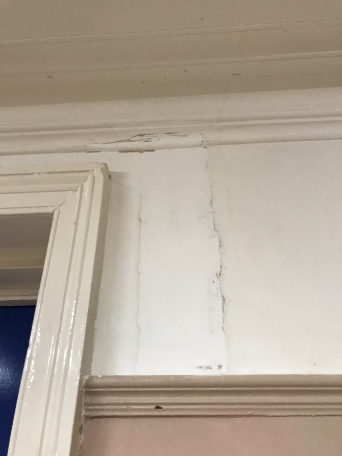

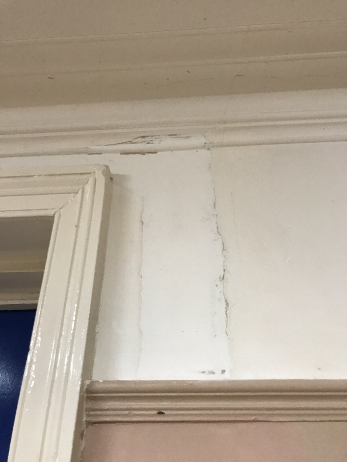

I repair my own chases and they are not visible after a coat of paint. I’ve certainly never needed to reskim a wall to hide my chases.
I would expect most good electricians to do the same.
Judging by the standards of your work that you post on here, I can believe that. Sadly in my albeit limited experience, most electricians and don't measure up to that, in so much as pretty much all the "made good" chases I've seen have been to a lesser or greater extent, visible. Just my experience though.
This is before painting obviously. It’s really not difficult to do invisible patch work as long as the existing plaster is somewhat sound. This is ~150 year old plaster.

View attachment 224498 This is before painting obviously. It’s really not difficult to do invisible patch work as long as the existing plaster is somewhat sound. This is ~150 year old plaster.
Thanks for posting this example RF. Do you often find 150 year old plaster in good enough condition that it would be pointless to redo it? Some developers take everything out regardless of the condition

If the plaster is 100 years old, covered in old paste, chipped and cracked - and you want to paint it, then a re-skim should be considered.
But if in good nick, or you're having paper, then consider keeping it.
People do seem to re-skim pre-war houses during renovations now if they want emulsioned walls.
I can't recall a time ever when someone has re-skimmed a room or a whole house ONLY because I've chased out the walls for electrics (although there was one occasion when the plaster was so shot to buggery that massive chunks dropped off revealing A LOT of brickwork).
Generally unless there has been water damage or some sort of structural problem then it’s usually been in pretty good condition in my experience.
The property in the picture has been fairly well looked after with regards to pointing and roofing / gutterings etc. There is an odd patch here and there which sounds a little hollow but overall there’s nothing wrong with it at all.
I certainly wouldn’t hack all the old plaster off just for the sake of it. Especially if you have nice old covings which you want to retain. The only thing you’ll gain from that is an invoice from a plasterer.
... It’s really not difficult to do invisible patch work as long as the existing plaster is somewhat sound. This is ~150 year old plaster.
You might have fun in my house. Other than for newer stuff, I have two types of (ancient) plaster, both of which are 'interesting' to deal with - one type resembles 'sand', and the other resembles a cross between reinforced concrete and cast iron! I think that a fair bit of it is still 'original' - which makes most of it about 125 years old, but some around double that age.
However, I agree that, even with those interesting materials, it's generally not difficult to do essentially invisible patching.
