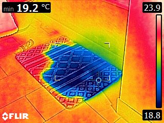

If it is a leak thermal camera would identify it relatively quickly.
A decent unit would be really helpful - even before any staining happened you should be able to see it.
You can also make it easier by blasting the heating then starting to investigate, the leak area will change temperature slower and be quite obvious.
I'll attach an example, this bath mat felt totally dry, but one side was a little wet.
