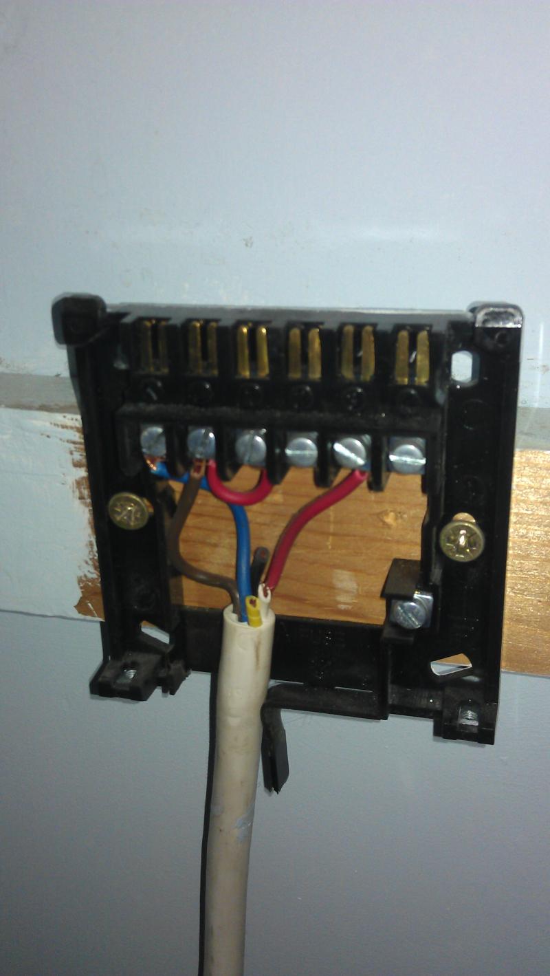

I'll take some photos of both ends of the cable.
The pics must show the terminals each wire is connected to.
Here is a photo of the RF unit, and the wiring inside...

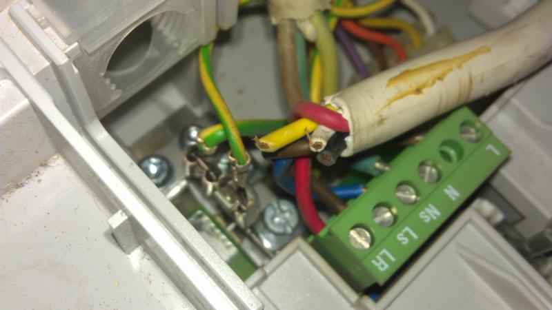

Now, I couldn't get the boiler front panel off unfortunately. Is this photo enough to go on?
I need to know which terminals on the boiler the wires are connected to. I can make a guess, but I would rather be certain.
Which model Worcester boiler do you have? If it's a recent or current model, this is how it should be wired:
Receiver - Boiler
L ---------- L
N --------- N
1 --- ----- Ls
3 --------- Lr
At the moment the receiver is getting power from the Ls terminal, which is alive only when the timer says so. The receiver needs a permanent supply to L and N.

The boiler is a Worcester Greenstar 28i Junior... and I had a look at the wiring inside, it is as follows (it was too confined to take a decent photo, so filmed it and am relaying what I see.)
RED - LR (from the SCR)
BROWN - Ls (from the SCR)
BLUE - Ns (from the SCR)
TURQUOISE? - N (from Mains, I assume)
BROWN - L (from Mains, I assume)

You need to wire as follows:
Boiler - Colour - Relay
L ------ Brown ---- L
N ------ Blue ------ N
Ls ----- Red ------- 1
Lr ----- Black ----- 3
Ns is not used.
