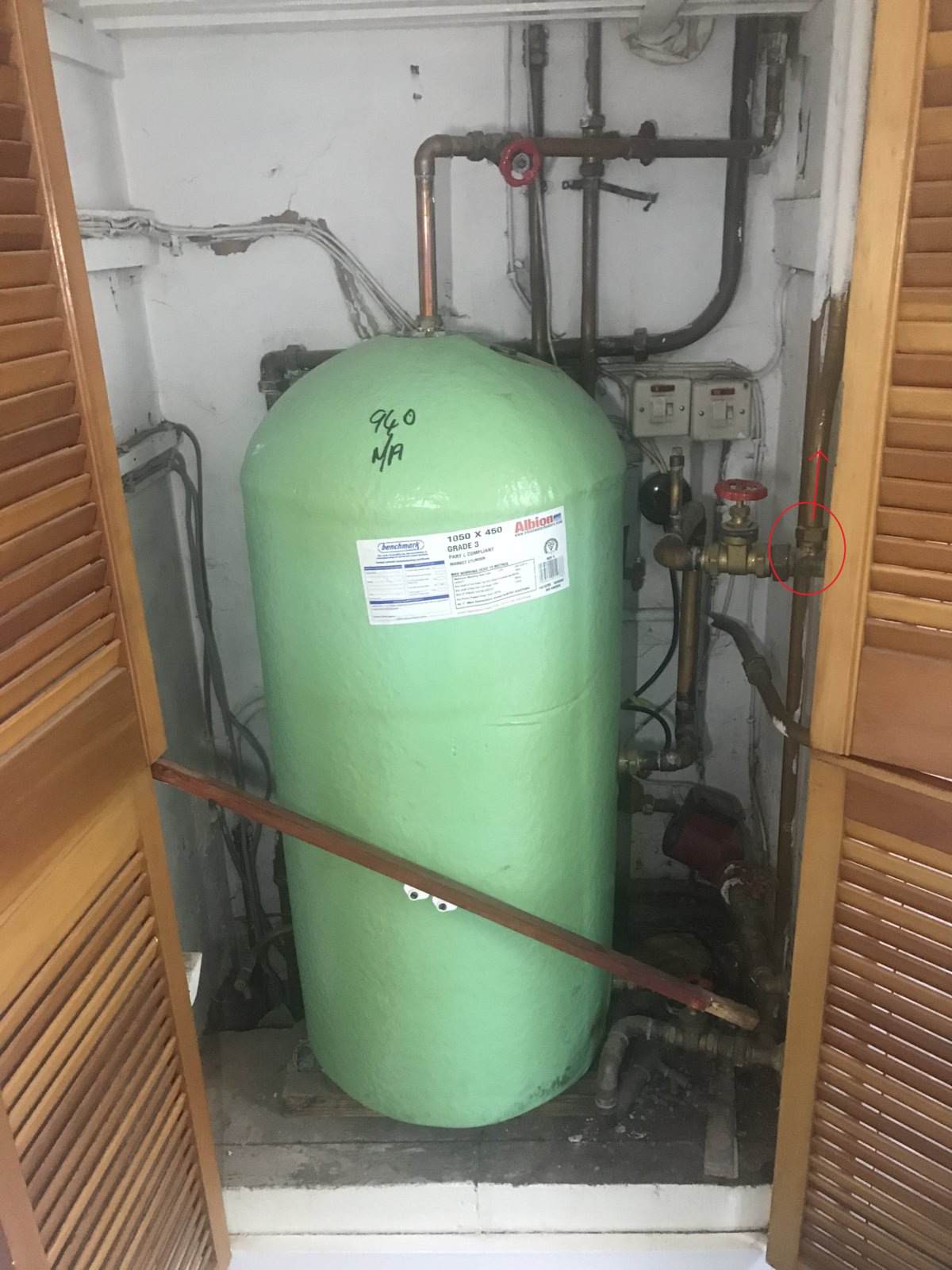

The expansion pipe looks to Tee off the HW flow (28mm pipe) before the connection to the cylinder. So I have a 28mm Flow and return to cylinder, then a separate 22mm flow & return for CH with pump on this return. The CH flow has a tee in it, with a zone valve on one leg which serves upstairs, this is controlled by a separate thermostat.
I was thinking of doing the following
1. capping the 28mm feeds as they come into the cupboard and just after the expansion pipe on the flow.
2. remove pump off return
3. install new pump on flow
4. after pump a a bypass to return and Tee to split CH & HW
5. Zone valve on HW flow circuit before connection to cylinder
6. Add additional zone valve on heating flow for downstairs
7. put magnetic filter on return
8. get it wired up
you will still have to make a permanent expansion pipe from the boiler to the F&E tank, before the HW zone valve or when the HW is satisfied you will not have an expansion for your system
That makes sense. Could I put in the expansion pipe after the pump or does it need to go before the pump? I could then connect this to the existing expansion pipe further up in the cupboard
better before the pump but if not feasible after will work, yes connect to existing but dont tee it in you will have to blank off the connection to the HW coil above the T piece, good idea to put an air release point where you blank this off

I'll draw up some diagrams and annotate pictures if I decide to do it, just to be sure I've got it right. I think the rad in the bathroom is run on the HW circuit and looks like it comes off the vent pipe as well, but would need to check again
Would vent pipe be on the flow or return in my current system?
should be on the flow and if an old system you are probably correct the bathroom radiator was often connected to this to act as a heat dump and you could warm towels on it

This is the existing vent pipe which is tee'd into the 28mm flow on the HW circuit. If i cut this just above the tee and put an air release in it and connect the rest of the vent pipe to the pumped flow before the pump? the 28mm tee will be capped on the end which currently goes to the cylinder
