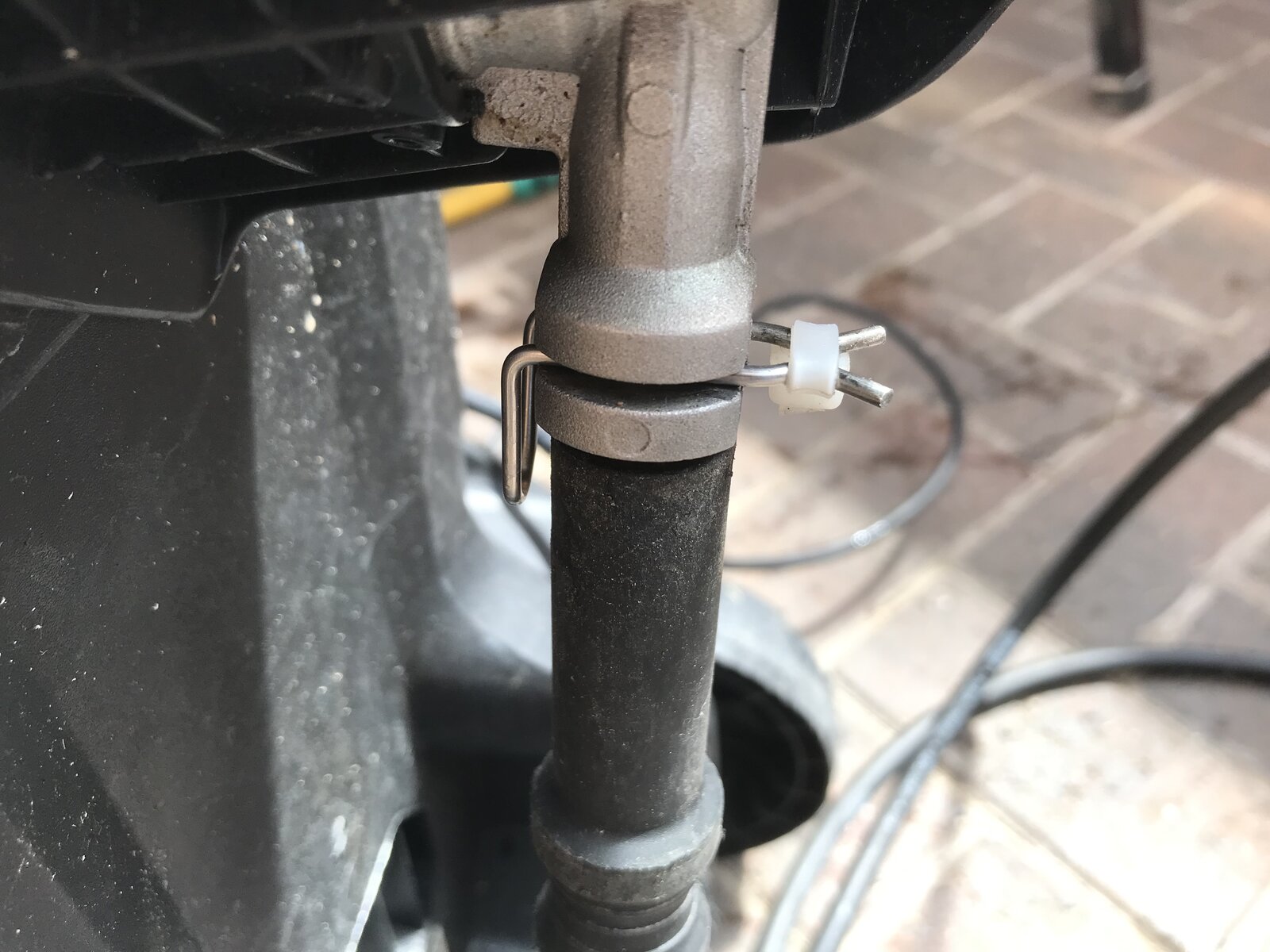

In-laws dropped off his pressure washer which keeps blowing the high pressure lance connection where it leaves the main body .
Held by a C clip which does not hold in use , tried new clips but same problem .? Only had 5-6 uses so unlikely to be worn .

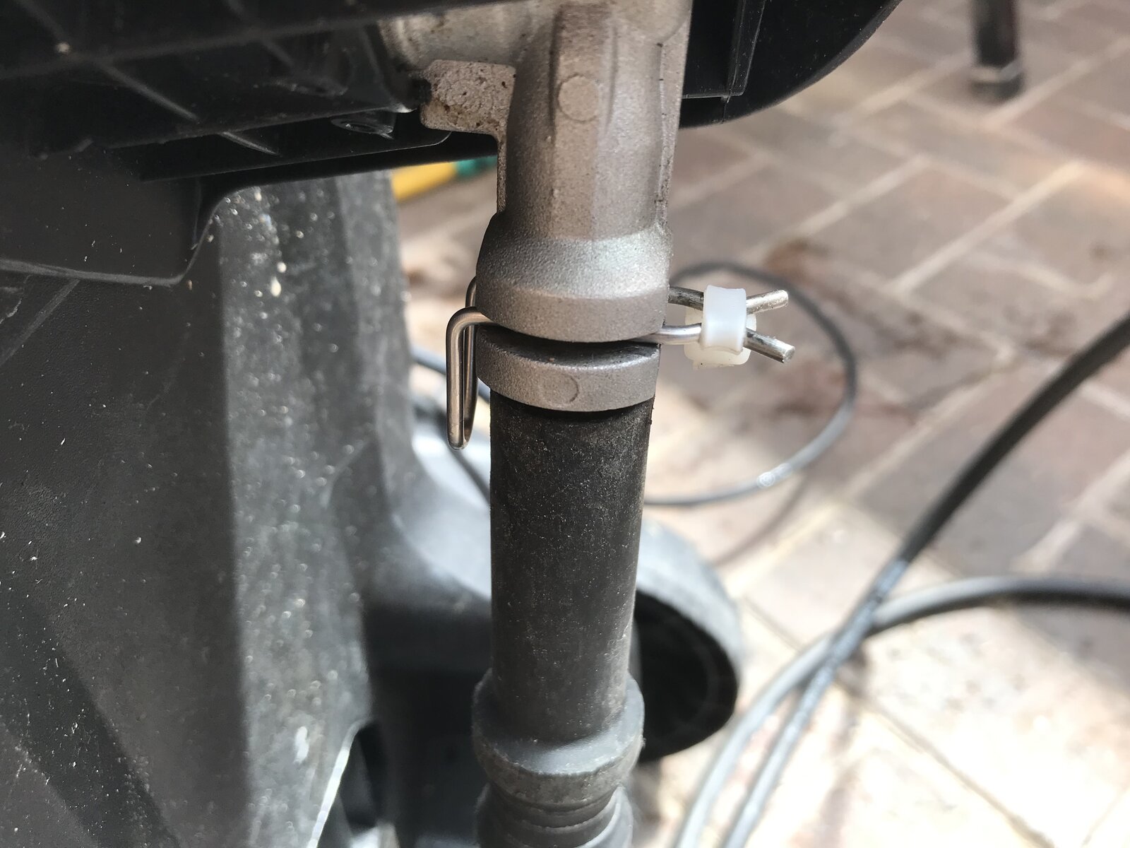

Hi I have the Same problem with my K5 tTy this it seem to have worked for me firstly I put the C clip in the vice and squeezed it to make a tighter fit then I put a cable tie on the end to keep the pressure on the clip I put the clip on from the back for better access

Have pestered Karcher and they have agreed to collect and repair foc, will be interesting to see what they do.
How did it go then? I’ve had both of my pressure washers repaired by Karcher and they do give a good service.
