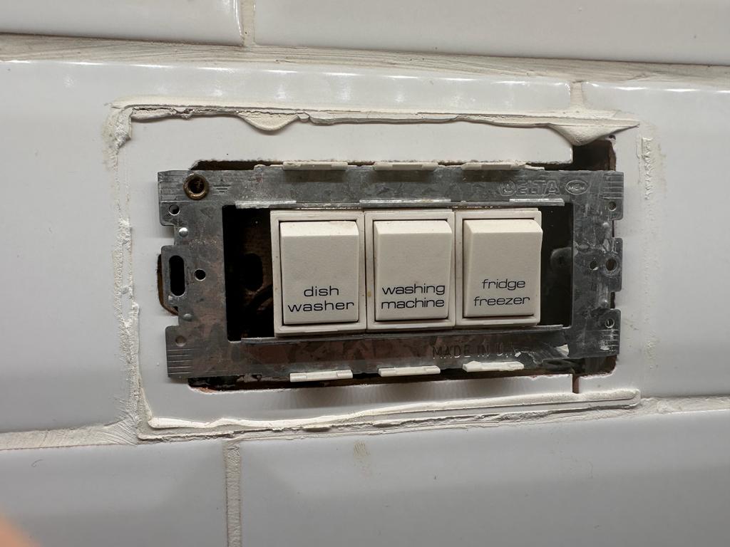

Hi all, thanks in advance!
We are having a kitchen make over including new switches/sockets

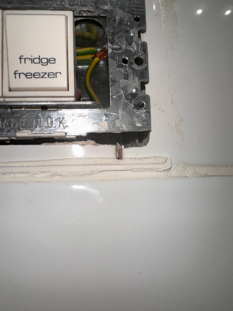

We have 3 appliance switches as pictured, when we bought the house there wasnt a dishwasher in the kitchen and still isnt so we were hoping to simplify this switch to just the DW and FF. We are going for the BG nexus range
My question is what module would be required (if this is even correct) A SP vs DP? (https://westbasedirect.com/products/r12) or something else entirely, fused spurs??

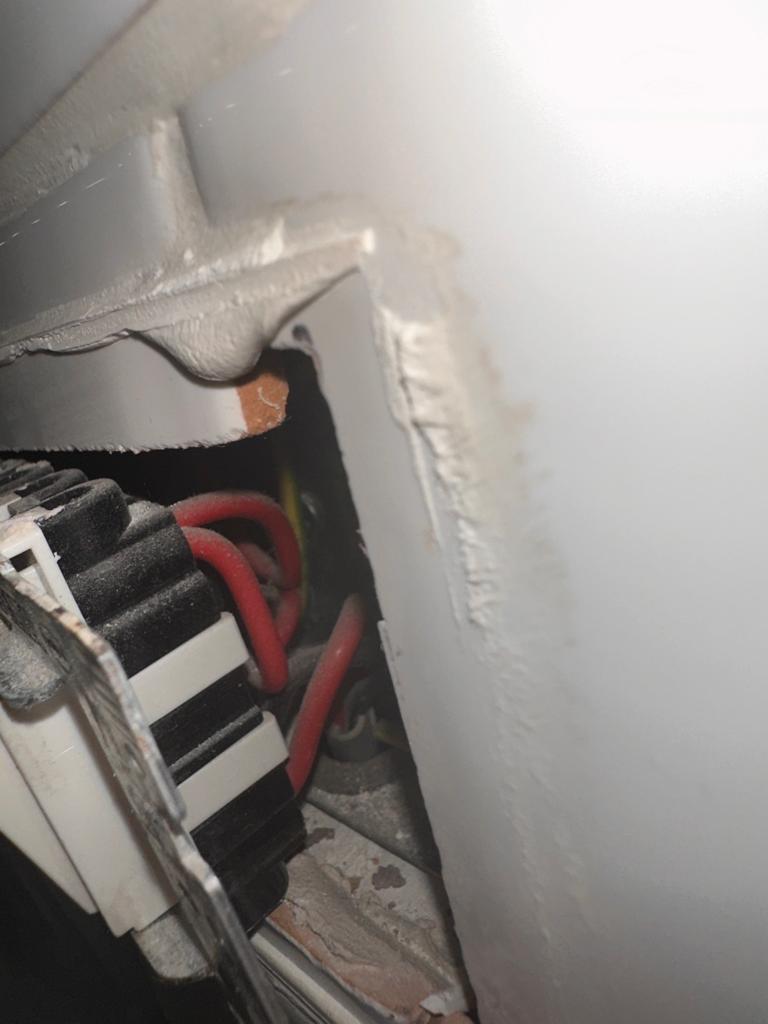

Have tried to look at the back of the current switches but don't seem to pull out much

The existing is old MEM DELTA grid switch. you'll only find knackered ones on FleaBay.
Best bet is to change the whole grid plate and the two (DP) switches that you need. BG sell switch plates with DW and FF labels.
