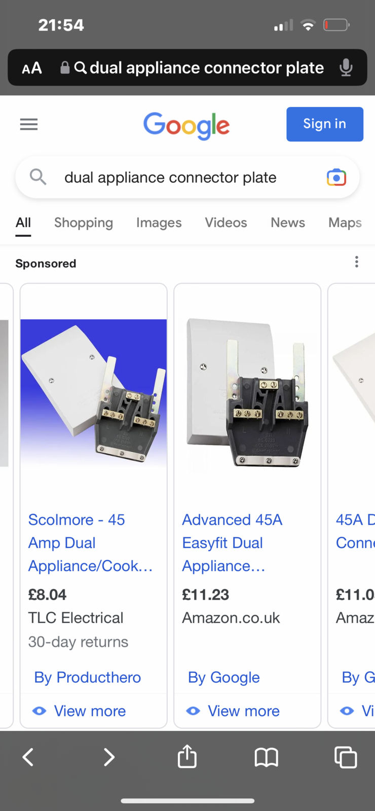

I was thinking that the setup (if a dual appliance connector plate is used) would be;
CU >> Dual Connector plate >> cooker switch x2 >> outlet plate x2 (x2 as one to hob and one to oven)?
I don't really understand.
What is a Dual Connector Plate? and
How will you be able to put it between the CU and Cooker Switch and why would you want to?
How would it work to wire up a hob and oven to seperate cooker switches if there is only one direct feed from CU?
Essentially the question is how would the oven cooker switch get the power from the current hob setup of: CU >> Cooker switch >> Outlet plate?
The connector plate is attached, one feed comes in and allows for two to go out?

Won’t you need the dual appliance connector plate to connect the two appliances together to then feed into the cooker switch?
Or can the connection to both appliances be made inside the cooker switch itself?
The wrong way round - not that it makes a difference physically.
It is not the purpose to connect the two appliances together.
The wires and power go to the cooker switch, then the dual outlet plate, then to the oven and hob.
Well, you could but normally the outlet plate is below the worktop so that it might be accessible later for alterations
If you have a two cables from the switch to the oven and hob, part of them will (normally) be buried in the wall and fixed.
Not necessarily, but it might well be much easier with a "dual appliance connector plate"
There's no electrical reason why not (if it can be done satisfactorily), but you might find it difficult to get all the conductors into the switch's terminals (and cables into its box) - so, as above, to use a 'connector plate' might be the better/easier approach.
