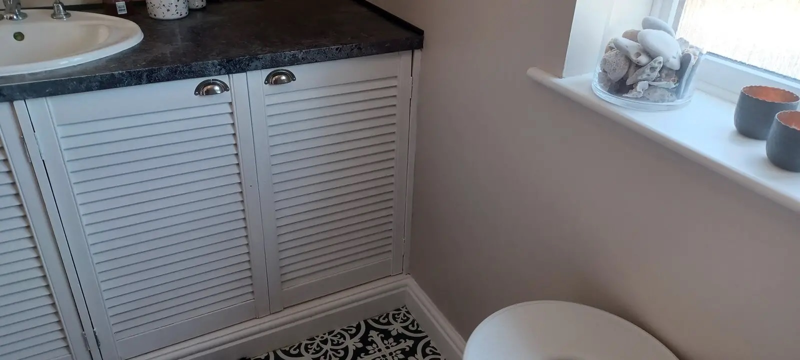

I have vinyled a worktop in a bathroom. Turned out well and lasted.
Wouldn't think it would be suitable in a kitchen from a wear perspective.

A partial pic of mine from a boiler related question on here.
Worktop would still be the best solution.
