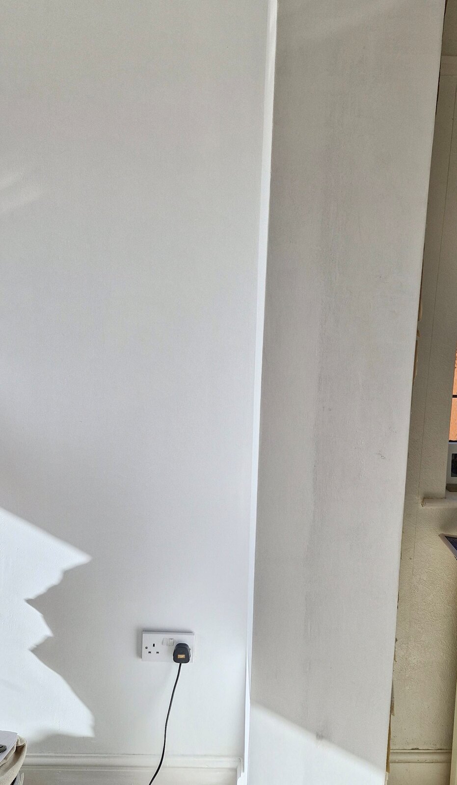

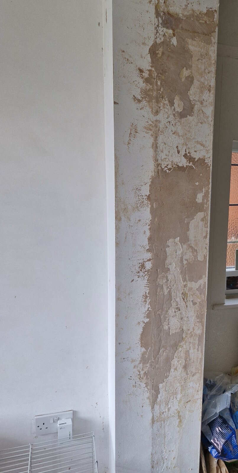

Taking all the advice on board above (thank you), I did a final skim yesterday and sanded down today. To be fair, its was a lot of work (but it was my first time using the stuff so learnt a lot). The second final skim 'picked up' within minutes, as the surface below was now porous with the first coat I had done the day before and was a lot easier to work. The guy in the video I watched was using it on new dry plasterboard, so, again, would be easier to work on that surface I would think. On the non porous surface I was using I did the base coat, flatted it off as best I could, but then left it 24 hours.
The finish is pretty good in my opinion, certainly acceptable. The pictures below show what I was confronted with when the wallpaper was removed. Did a first sand with a sanding block by hand with 180 grit, then finished it off with 800 grit again by hand.
As mentioned above, the final skim went on much easier, so less to sand off 24 hours after that. You need patience with this stuff as it does exhibit a small bit of shrinkage overnight;, do it in stages.
Good stuff for the DIY'r for smaller areas. The product does say you can plaster anything, so big areas could be done if you are skilful I guess. I think professionals wouldn't use the stuff just because of the time it takes but, speak as I find, I found it good once I got used to it.
