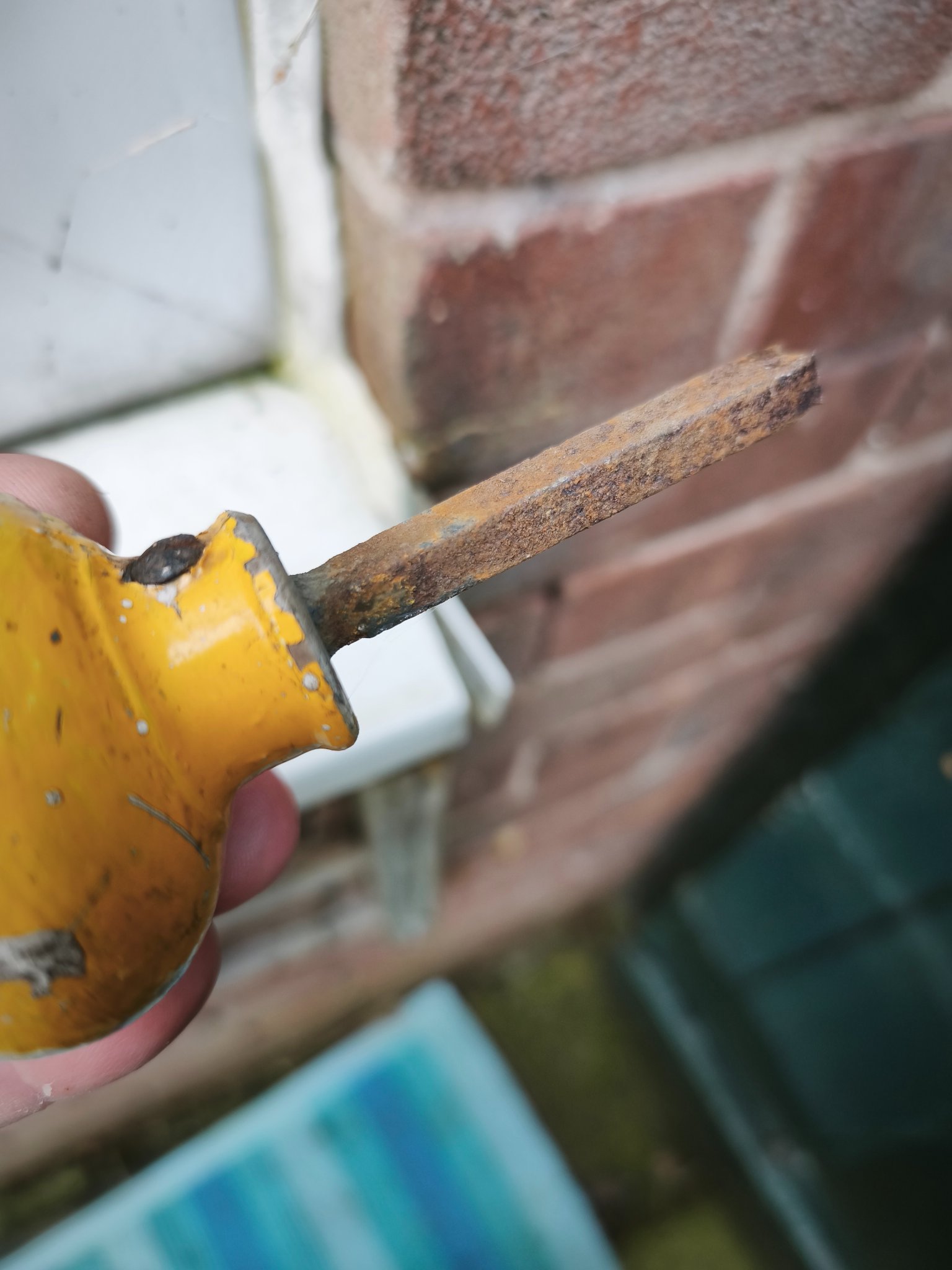

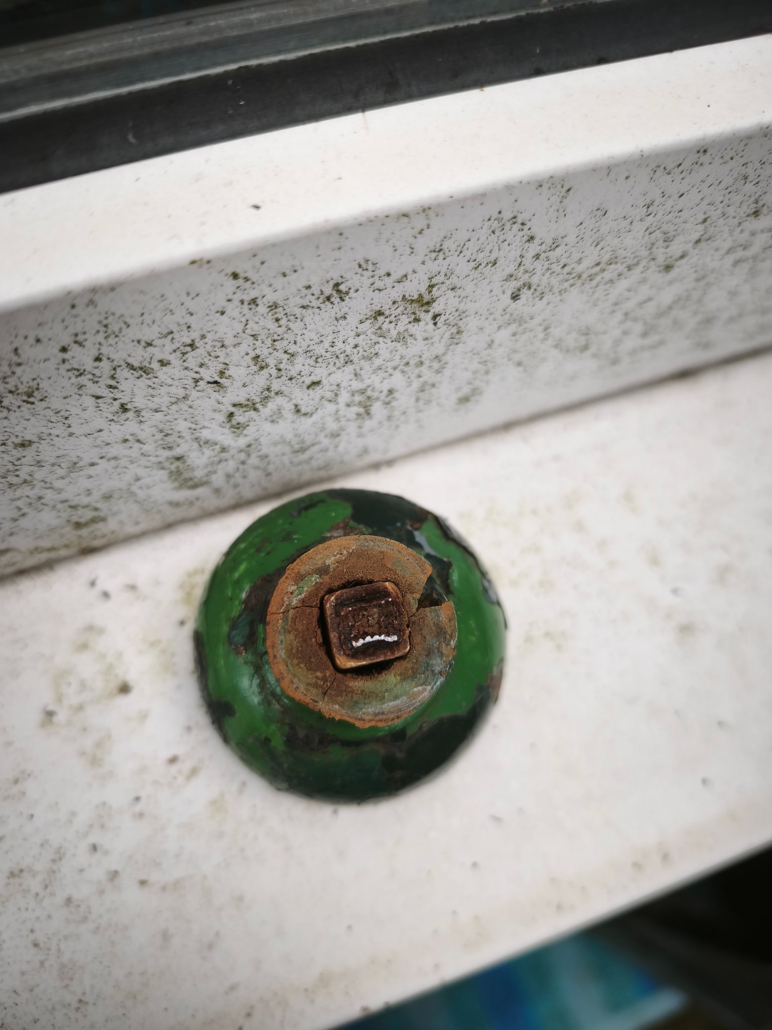

The garage door knob was hanging on by a thread and snapped when I turned it.
Trouble is, the bar is badly corroded and will not come out.

You can probably hammer the old spindle out with a drift, after squirting WD40 in, but this may damage the lock or latch. What has it got?

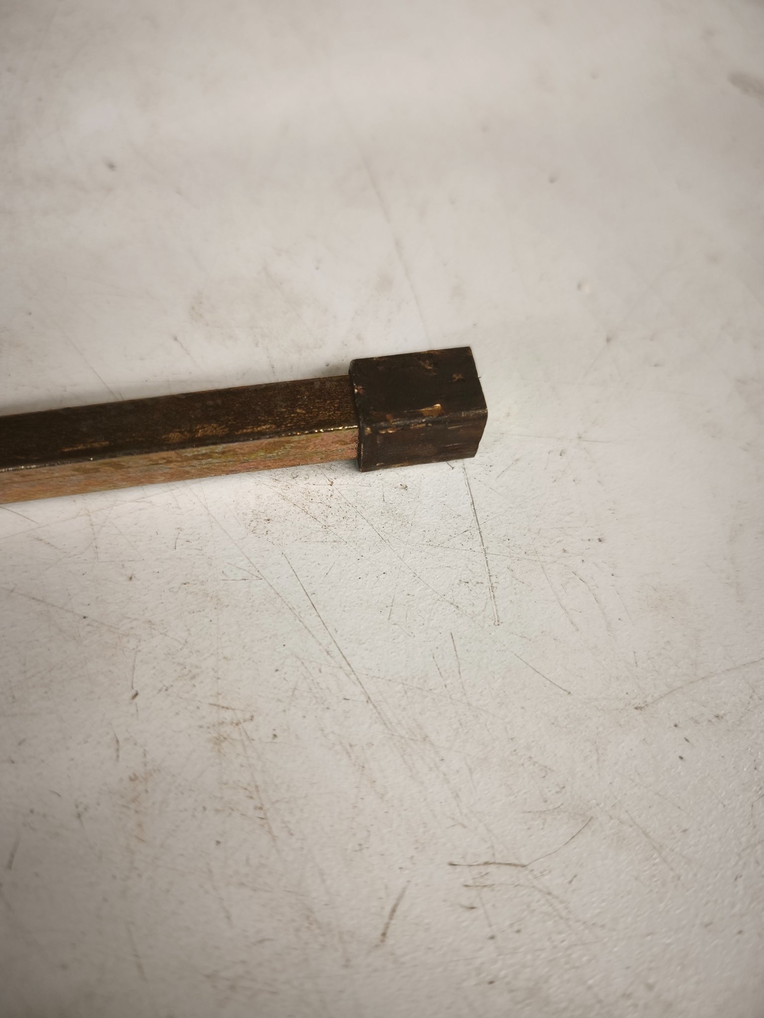

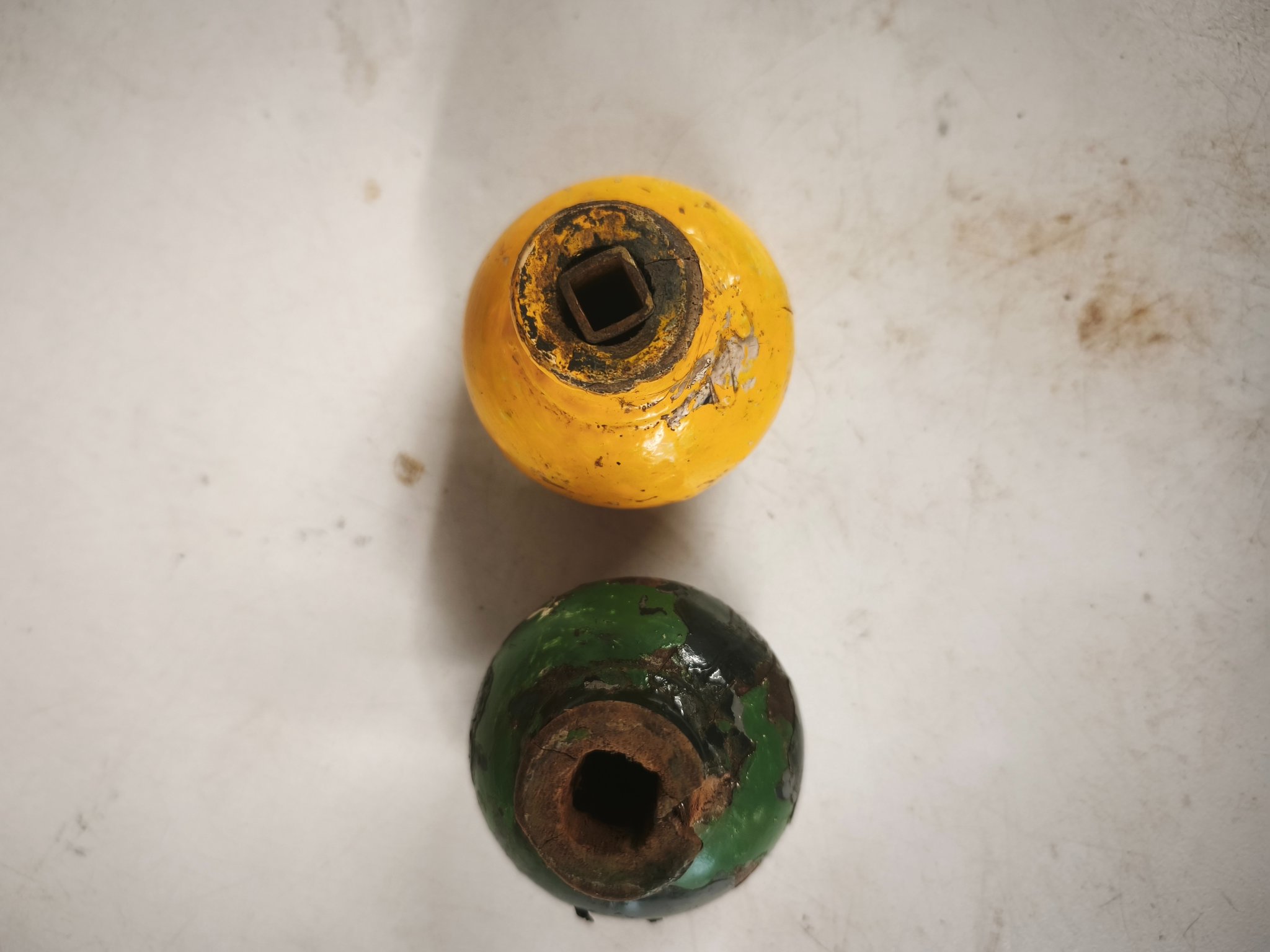

Cheers John. The one that came off in my hand had a spindle with threaded holes and the knobs on each side screwed into it.

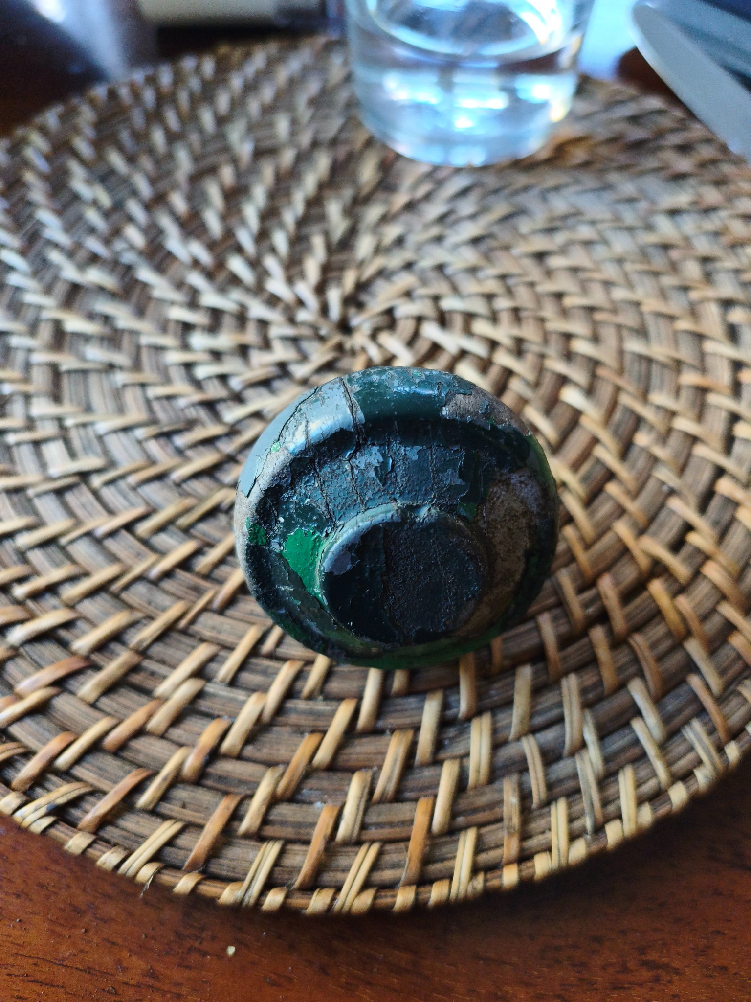

With the help of WD, I managed to get both the yellow handle complete with most of the spindle out of the rimlock, and the yellow knob off the spindle. However, the green knob has the remains of the spindle stuck fast inside it.
I have got a new spindle on the yellow handle, but it is an undrilled/ tapped one. This doesn't matter because it's a tight fit.
I guess the old spindle and knob were imperial and the metric ones are a smidge bigger?
So I have the choice of reusing the yellow handle on the outside (it was on the inside) and fitting a new knob on the inside, or getting a matching pair.

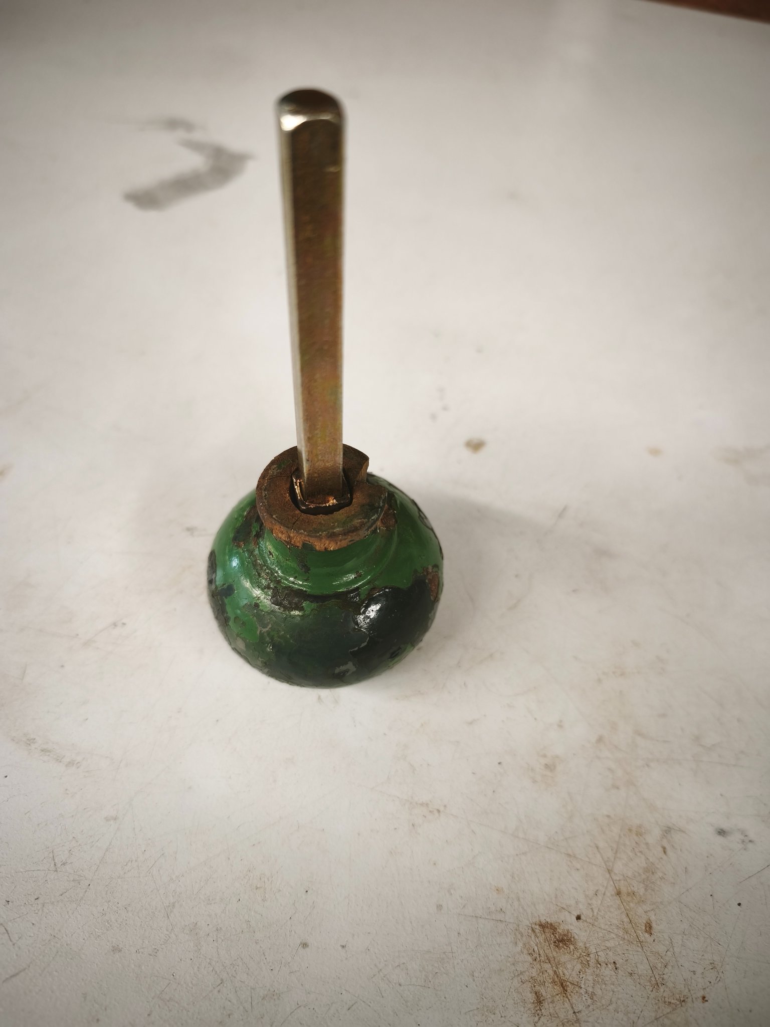

I have had great success drilling out the rusted spindle from the brass keep.
I worked out that I'd get some of that setting two part putty to pack in the door knob cavity and fit the brass keep into that, with the spindle attached.
I thought I was well on the way to resurrecting the existing knobs.
But...disaster!
The spindle is too short! I was sold it as 100mm, but it's not. And, stupidly, I failed to check before it was too late.
I should have known better!
Now it's stuffed tight into the brass keep, I'll never get it out...

These original oak knobs from the 50s have brass inserts in them to receive the spindles.
