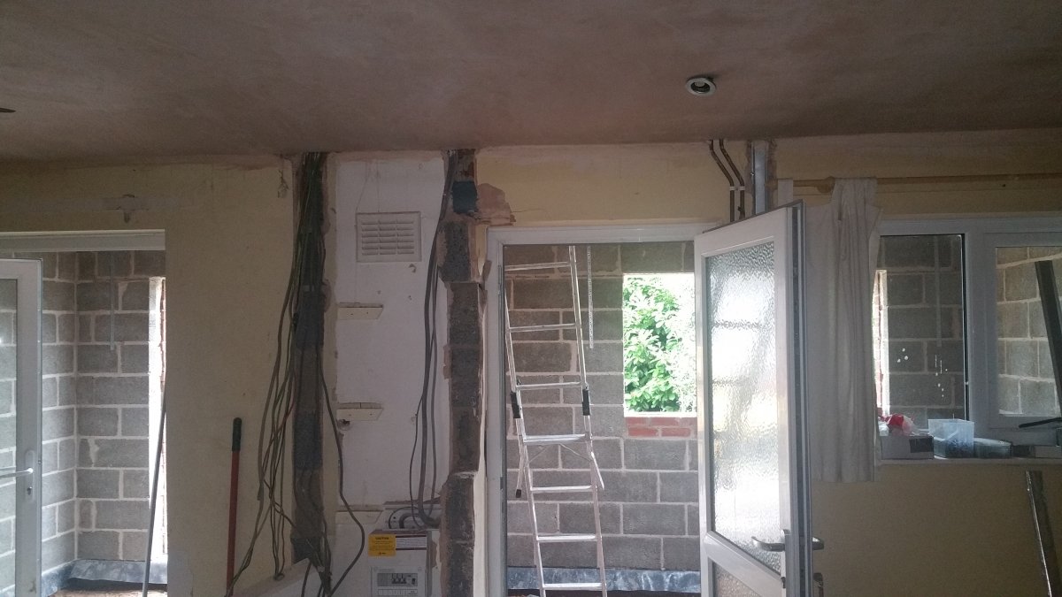

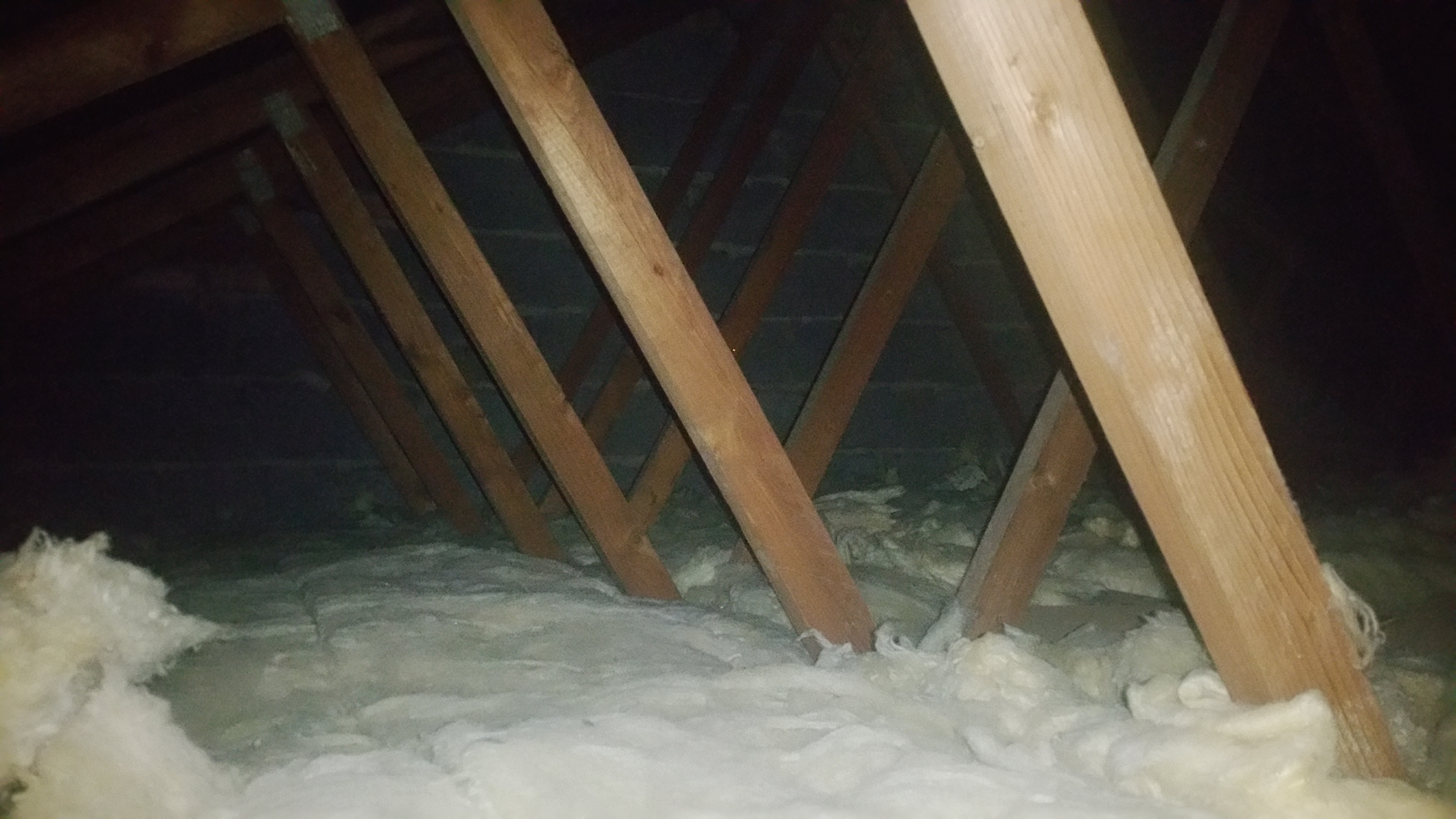

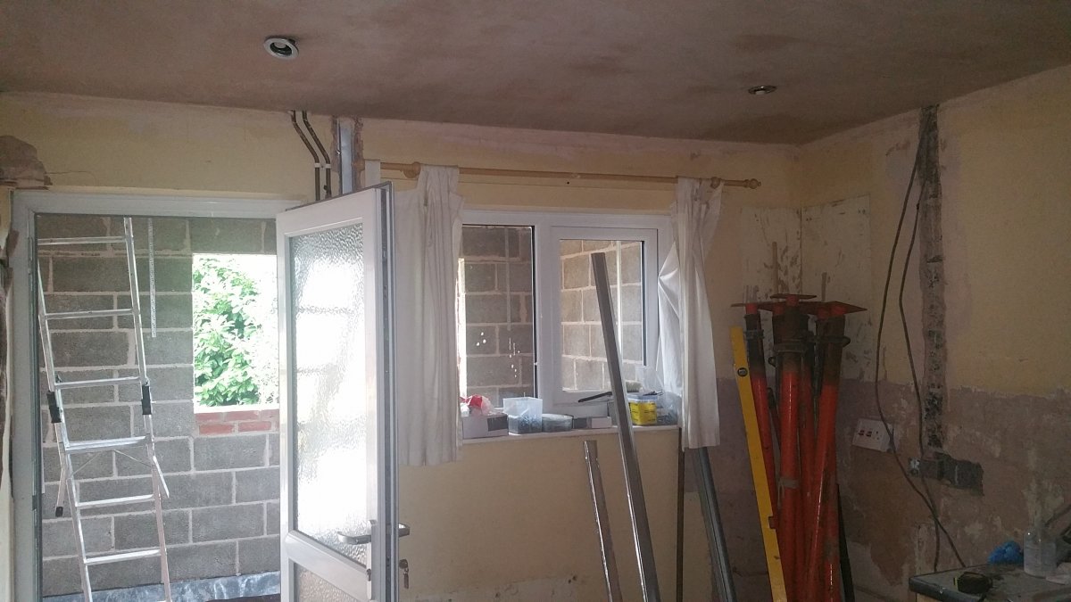

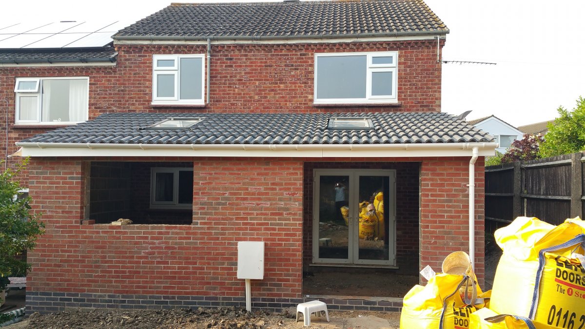

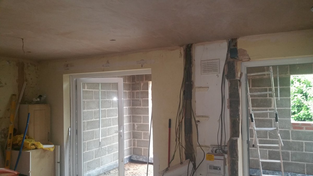

Hi,
I have a 3 bedroom end terrace (ground floor and first floor with truss roof), i have had an extension built to the rear of the house via permitted development (external size 3mx7m with vaulted roof). I now want to knock through the back of the house which is a cavity wall (260mm). The opening will be around 6.5m which i know is a large opening.
I have followed all building regulations regarding the build work and have been advised that i require steel calculations for the opening along with padstone spec and end bearing size/length from a structural engineer, which of course i am happy with.
The SE first stated that due to the opening size i may require steel posts on the sides of the opening, i believe he may of changed his mind now (yes not great). Now he is suggesting that the end bearing walls may need to be 600mm each which is not want i want for a open plan space. i have told him that 600mm is too big for end bearing but he is suggesting that I need to pay his quote so he can conduct the calculation to truly determine how much of the wall i need to leave.
I do not have plans as the build work was done on a building notice, however i have attached some pictures and the SE has modified my estate agent plan.
Sorry for the long post, would just like some guidance. Is the SE advising me correctly.
My building inspector has stated that he doesn't need calcs but as a safety precaution I rather have them and therefore a piece of mind that everything is safe.
Thank you

What your SE suggested at first was a moment-frame (aka 'goal post'). This is a rigid frame intended to provide lateral stability to the house when under wind load.
Frames are expensive and disruptive, and the alternative is to leave reasonable lengths of brickwork in, which also provides lateral stability. This is one of the reasons he had 2nd thoughts and suggested leaving 600mm each side, which of course would look naff. The other reason is that he doesn't want to go to the bother of designing and detailing a frame.
But looking at your house as a whole, and including the brickwork in the extension, I would reckon that you have enough structural walls going across-ways to provide stability, and without leaving big chunks of brickwork in. Small piers - say 200-250 deep would suffice for a bearing.
It would also help lateral stiffness if you diaphragmed the new stud partition with plywood or osb both sides.
But whatever else, you don't need big clunky piers.

That would be a good price IMO, particularly if you could get him to work with 300 piers, rather than 600.
(Strange that your bco has said he doesn't need calculations; most inspectors would ask for calcs for beams with far
shorter spans than that).

It depends partly on the resources the builders has. On that span, it might be easier to have two steels bolted together, so that they can be installed one at a time. One downside is that the inner skin will probably be considerably more heavily-loaded than the outer skin, due to the house having a trussed roof, so that beam might deflect a little more than the other, even with spacer tubes.
