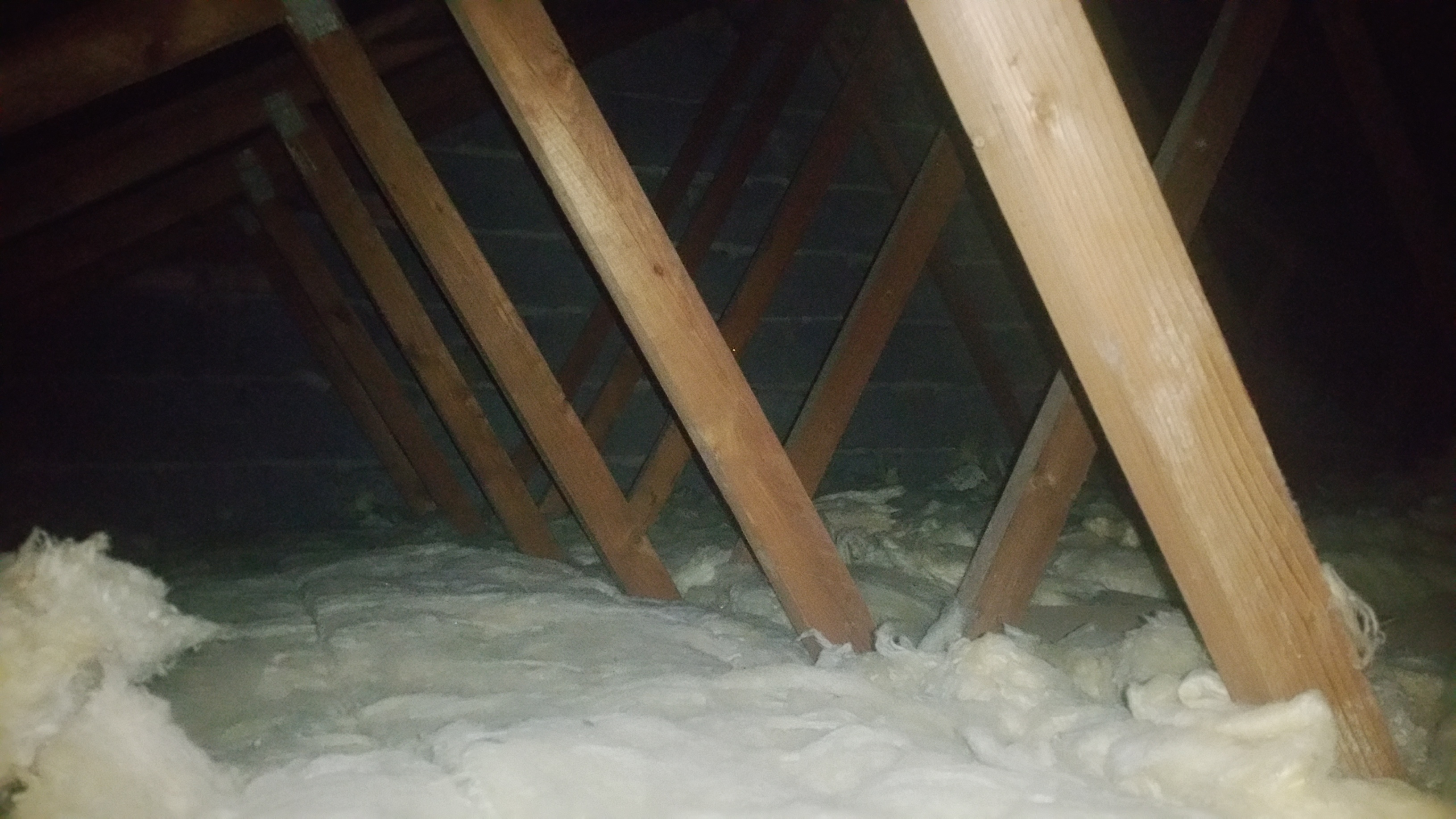

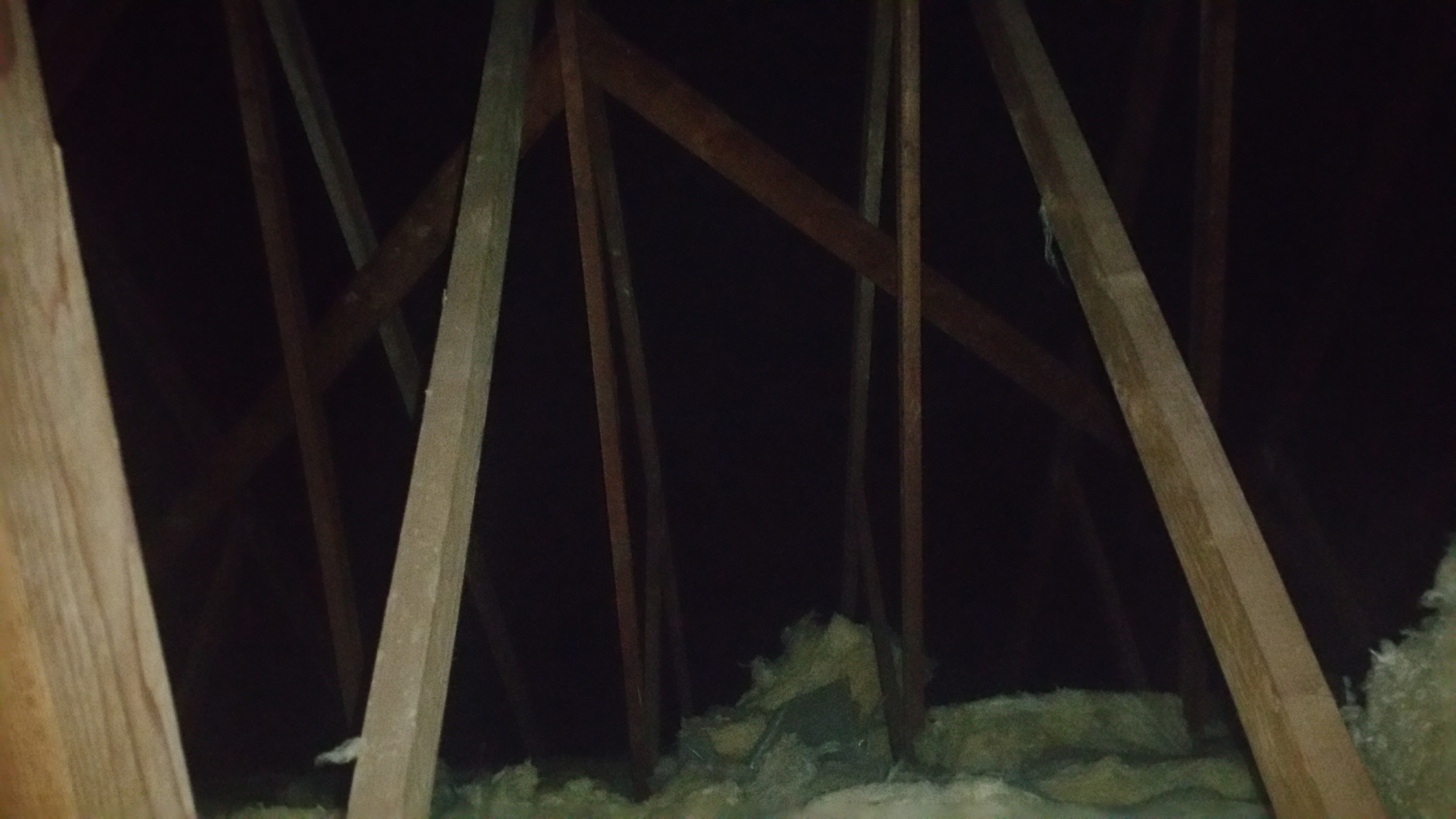

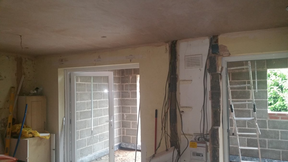

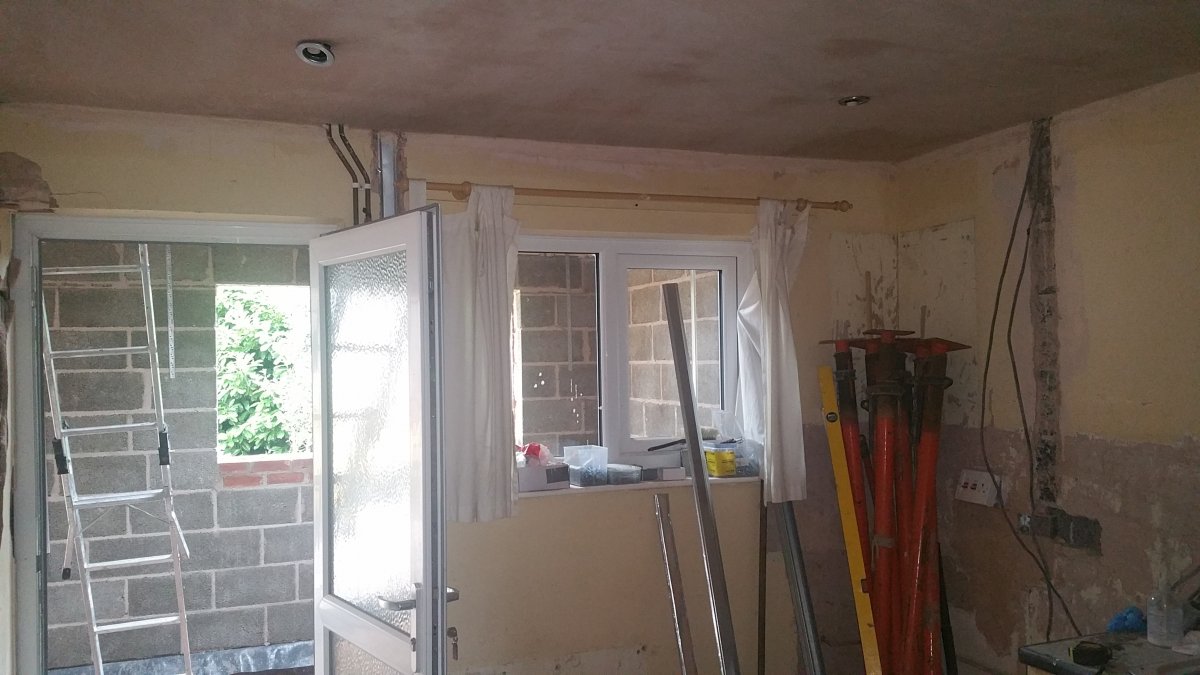

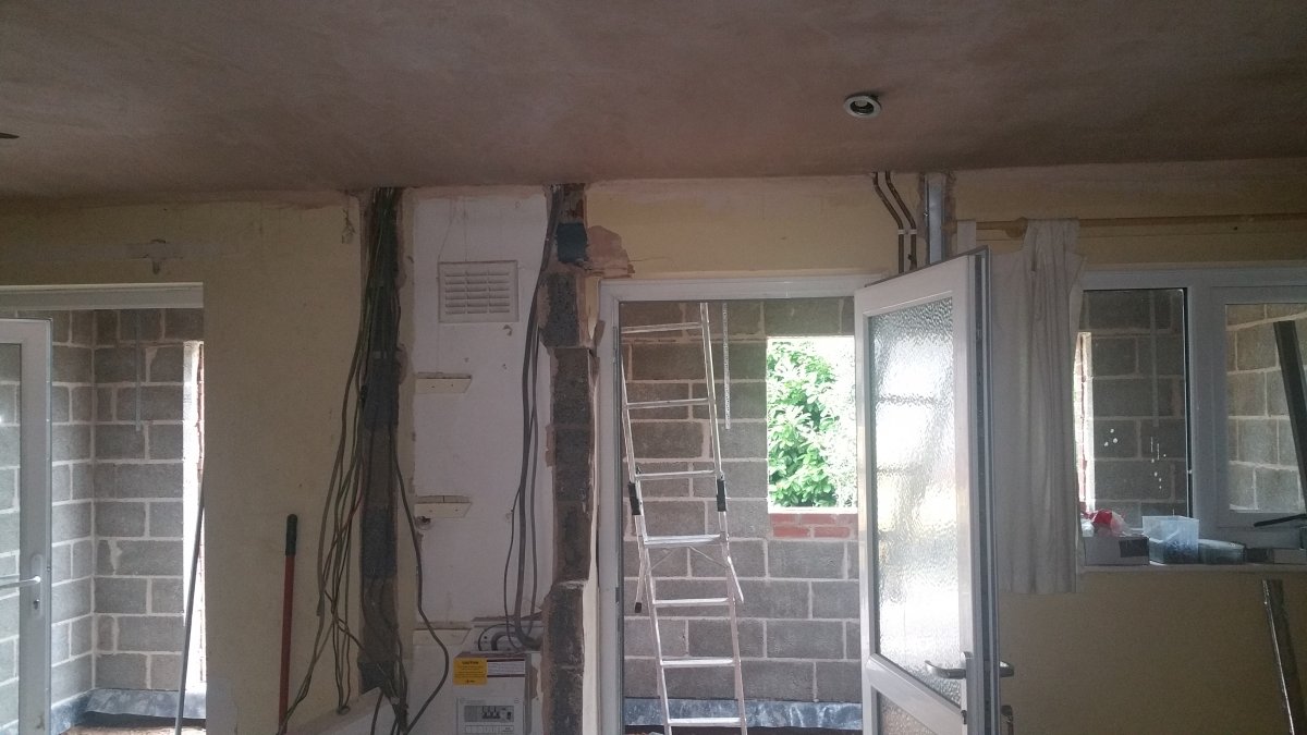

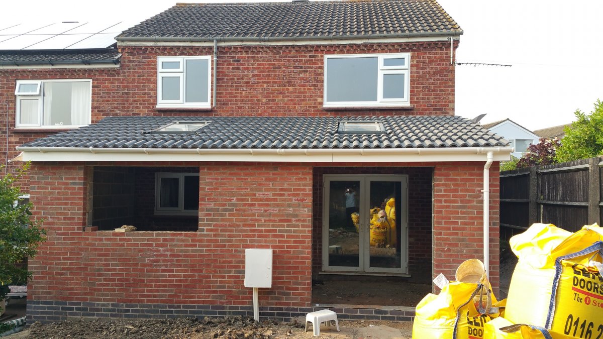

I have a 3 bedroom end terrace (ground floor and first floor with truss roof), i have had an extension built to the rear of the house via permitted development (external size 3mx7m with vaulted roof). I now want to knock through the back of the house which is a cavity wall (260mm). The opening will be around 6.5m which i know is a large opening.
I have followed all building regulations regarding the build work and have been advised that i require steel calculations for the opening along with padstone spec and end bearing size/length from a structural engineer, which of course i am happy with.
The SE first stated that due to the opening size i may require steel posts on the sides of the opening, i believe he may of changed his mind now (yes not great). Now he is suggesting that the end bearing walls may need to be 600mm each which is not want i want for a open plan space. i have told him that 600mm is too big for end bearing but he is suggesting that I need to pay his quote so he can conduct the calculation to truly determine how much of the wall i need to leave.
I do not have plans as the build work was done on a building notice, however i have attached some pictures and the SE has modified my estate agent plan.
Sorry for the long post, would just like some guidance.
Thank you
