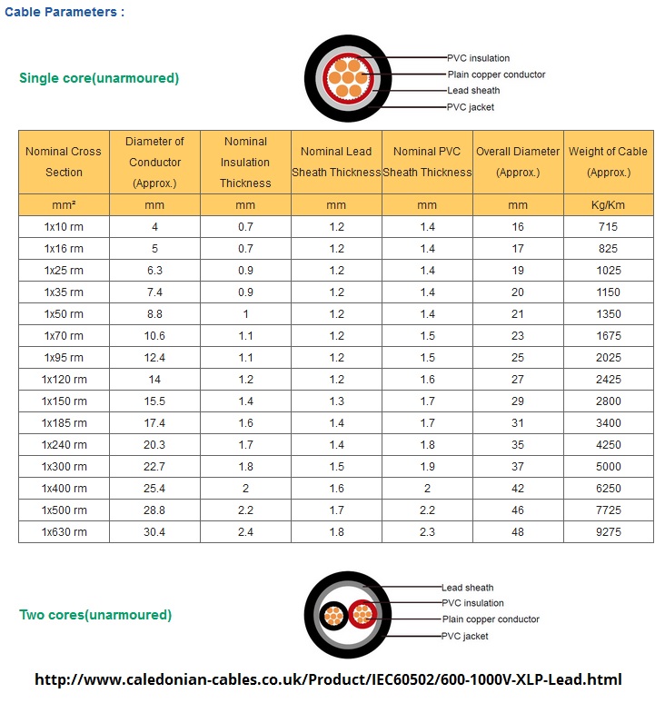

Lead sheathed cable is still available albeit with a PVC outer jacket
caledonian-cables.co.uk said:
They are suitable for installation in indoors and outdoors, in cable ducts, under ground, in power and switching stations, local energy distributions, industrial plants, where there is no risk of mechanical damage. The lead sheath brings an enhanced resistance to aromatic hydrocarbons.
Given there is a cinsiderable amount of cable to be replaced it might be cost effective to ask if a quantity of cable could be produced without the PVC jacket.
Interesting, I didn't know any would still make a lead sheathed cable. Smallest size there is 10mm csa..

I did see that the smallest listed stock cable was 10 mm. That said it is not impossible that they could make lead sheathed cable to the size you require.
Being a renovation project they may be prepared to manufacture a special size at cost in return for a mention on the list of sponsors of the project.
There is (was about 10 years ago) another specialist company that makes ( or supplies ) lead sheathed telephone cables but I cannot recall their name.
It may also be that lead sheathed cable can only be legally supplied with a plastic jacket which could then be removed at installation as it is a historical restoration project.
