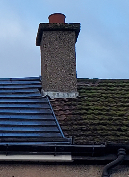

A new roof was put on my neighbour's house recently and now there is a leak into the loft at my chimney. It seems the roofers haven't done the best of jobs and you can see the big gap between the tiles and my chimney. I want to try and resolve this myself if possible as the neighbour is very elderly and unwell so I don't want to bother him.
What kind of options could there be for fixing this?
The leak is not big, but it is soaking the timbers and boarding inside the loft a bit. Shining a torch through I can see it's wet in the neighbours loft too.
Firstly, congratulations on gaining about 12 inches of your neighbours roof as that join should be down the centre of the party wall but is clearly in your favour and secondly it looks like they have used the old lead and tiled rather badly around it so it is a good bet they have not done the soakers and sealant correctly. My opinion would be to contact the roofer yourself if you can and tell them your concerns and that you had no leak before but have one now and so does the neighbour. See what they say and fingers crossed they will be decent about it and sort it out.
just a though it seems to be a single pot that is centrally placed on the i assume applying to a single property stack so to me suggests a on the edge on the boundary
If that guttering is new too and it's supposed to drain to the right and into that downpipe, then someone is going to get water pouring out and down the wall as it is fitted below the line of the adjoining guttering.
The lead channel running up the side of chimney looks like its running back into the roof. It needs stripped out and done properly.

Yes I am in Scotland. It's that gap between my chimney and the new tiles on the neighbour's roof that I think is the problem. So if I could get new flashing put on that side to cover over this gap then maybe that will solve it.

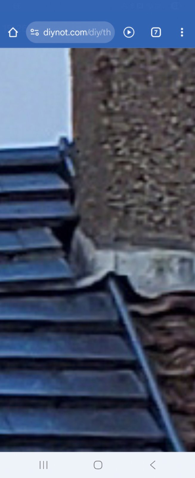

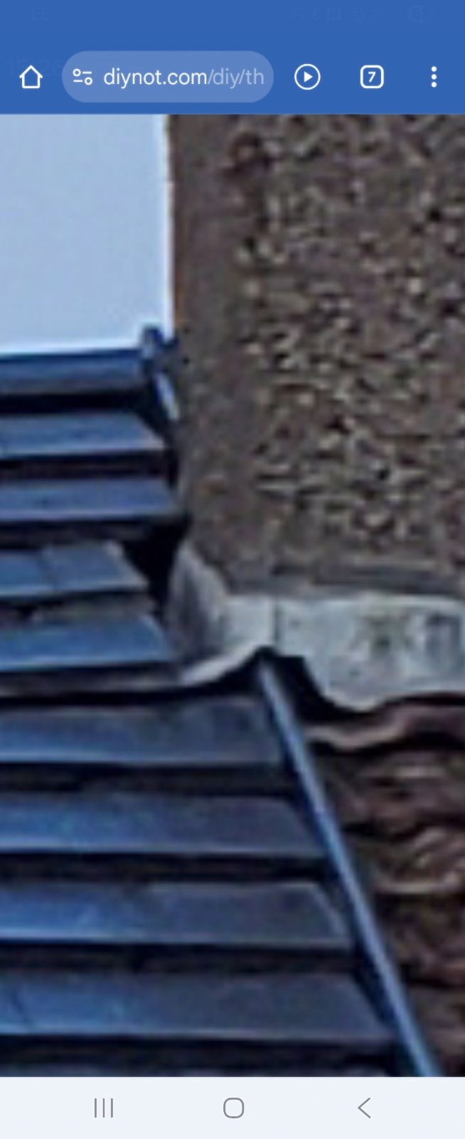

No it's not the gap, the rainwater is running back into the roof from the lead channel. The new tiles have raised the front of the lead.
It's a simple enough fix to a competent roofer, the tiles around the chimney need removed and the leadwork done properly. A roofer would allow a days work.
