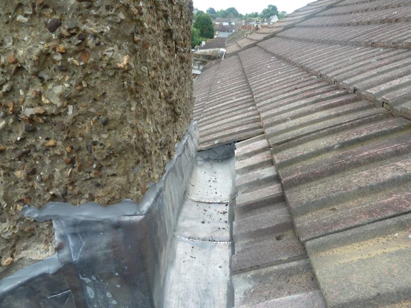

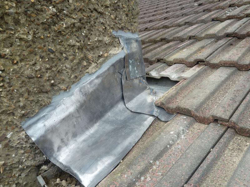

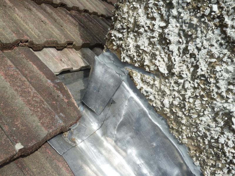

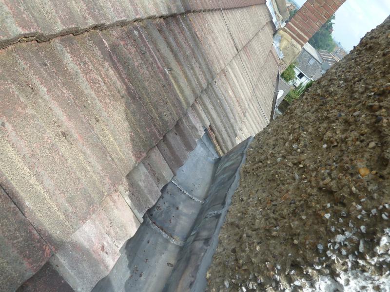

So I have now had the back gutter done. Apparently the wood wasn't rotten underneath.
Here are some photos
I think it looks good. What do you think?
It has rained really heavily a couple of times now, and the leak seems to be well and truly gone.

Thanks for the new pics. The job looks fine. But must be 100% no leaks.
Somehow you must examine the lay boards under the back gutter (for any kind of fungal damage), and that wall plate running across your rear elevation. The roofing felt should be above
it, and so allow inspection from below - either from in the loft or from a ladder in the stairwell.
I should ignore the "weird mound" - what i thought was a projection, was the parapet wall due to the angle of an earlier pic.
