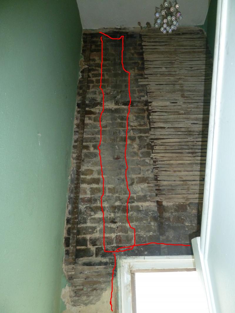

I have a leak in my roof at the back of the property. I'm planning to get it sorted by professionals, but I would really appreciate any feedback/thoughts to help me properly diagnose the problem and get the right people in to sort it.
When we moved into our property (July of last year) we found that the previous owner had covered an entire wall of badly water damaged plaster with drapes. We spent £200 on a damp surveyor, who told us that it was caused by a leak in the roof and that it was historical .
Over the winter the plaster got worse, and so I decided to take it down, as it was ruined anyway. Low and behold, as soon as I did there was a drip of water from the roof. It was raining very heavily at the time, and the amount of water coming through was a small but steady drip.
Here is a photo of the back of the property, as well as a photo of the affected wall from the inside of the property. I've tried to highlight in red the affected area. I've also highlighted a window in both as a point of reference.

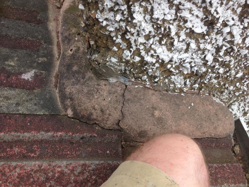

I've now had a roofer come around and have a look at the roof. Here are some photos he took while he was up there.
The first photo is at the back of the chimney stack, at the point where the chimney stack meets the roof. The second is the same, but this time from the side of the stack.
In the first photo you can see that the tile directly behind the chimney stack has cement in the grooves. While in the second photo you can see cracks in the mortar.
The roofer told me that this tile is no longer functioning properly, and as a result water is making its way through the cracks in the mortar.
This seems reasonable to me, and it is roughly in line with the location of the leak, but any expert feedback would be much appreciated. Does it seem reasonable?
His suggestion is to
To remove existing defective tiles and mortar from around chimney stack
To install new leadsheet back gutter and side flashing detail dressed to correct code of practise
To tile defective area back in using Redland 49 interlocking tile
To fix GRP termination bar to newly installed leadsheet
Again, is this reasonable?
I am pretty sure that some of the timber underneath will be rotten, as the laths we well rotten when I took the plaster down. The roofer said that in regard to the timber we would have to play it by ear until the tiles come up.

The chimney stack should stay - its a valuable feature of an older house and helps to give the property some distinction. Have your flues swept and vented.
The sand and cement fillets that have been used around the stack (presumably on the neighbour's side as well), of course, require removing and making good with new tile and lead flashing.
Termination bars are unnecessary, and might actually cause further leaks. Lead stepped cover flashing and soakers, with a lead back gutter - wedged and pointed into beds - are sufficient.
Does some kind of roof parapet run up behind your stack?

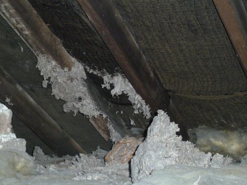

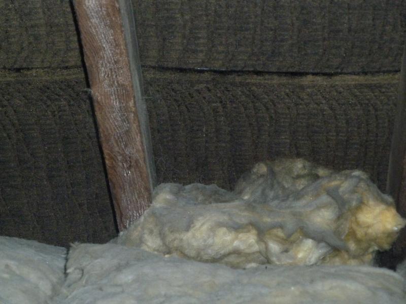

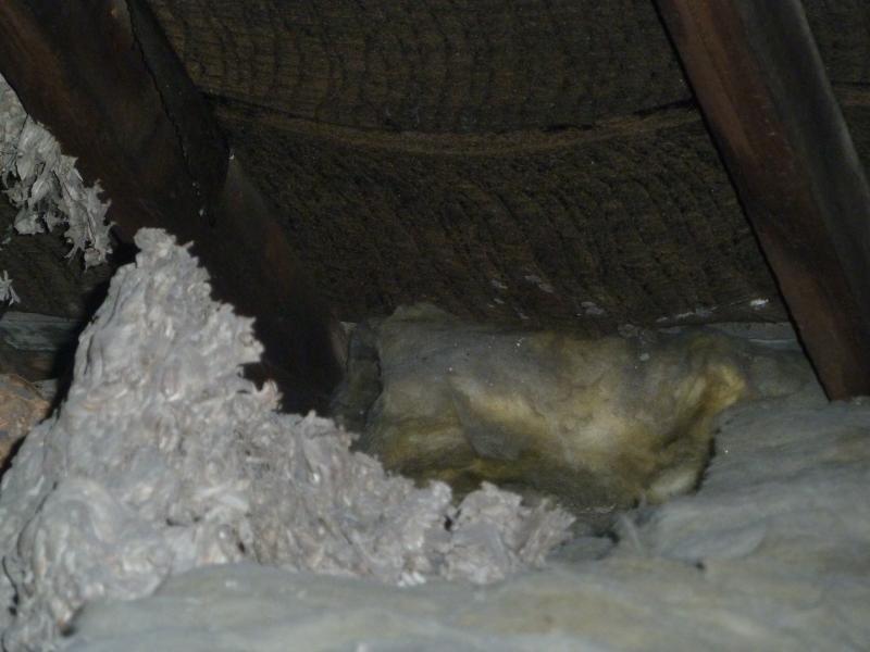

I'm not sure if the joists in the loft were designed to take the weight of a person. I didn't want to risk it, so I took some photos from the loft hatch. It looks like a mess, but I don't know what it is. Fungal growth of some sort? Here are the photos.
Here is the view from the hatch
and here are some close ups

Its difficult to say what the substance is:
1. possibly fungal bloom hat has been sprayed with anti-fungal chemicals. The dark staining on the rafters suggests this.
2. some kind of earlier insulation
3. dont know.
The joists will be strong enough to support you; whoever installed the insulation in the joist bays had to stand or crawl on them.
Perhaps use crawl boards?

OK, so it seems that the S&C fillet and defective tiles are the likely culprit of the leak, which is good to know.
The roofer did mention about bedding the flashing, but said that it would difficult on that chimney stack. I can't remember what reason he gave. I will ask him. Would this bedding (which I assume would be mortar) go on top of the current render, or would the render need to be removed first?
Anyway, it seems from peoples comments that termination bars are not really appropriate for this job.

OK, so it's not dry rot?
I will look into getting into the loft area.

Venting a stack with ridge tiles will eventually cause further leaks - the typical stack flue vent is an insert that goes into a chimney pot.

As emphasised above, all S&C fillets must be replaced by lead flashing.
I didn't say it was not Dry Rot. You must get in and probe the timbers and pic the stuff close up.

The stuff on the rafters looks like a wasp nest that's fallen down.
if if feels like paper and there is "honeycomb" discs inside, it's a wasp nest.
