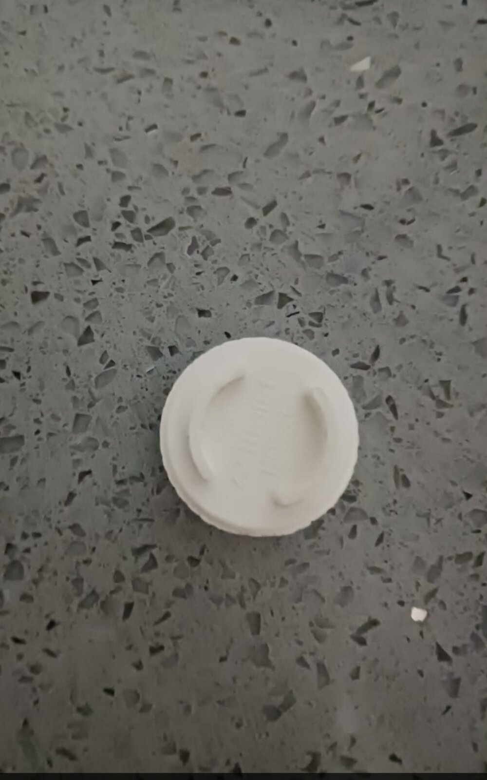

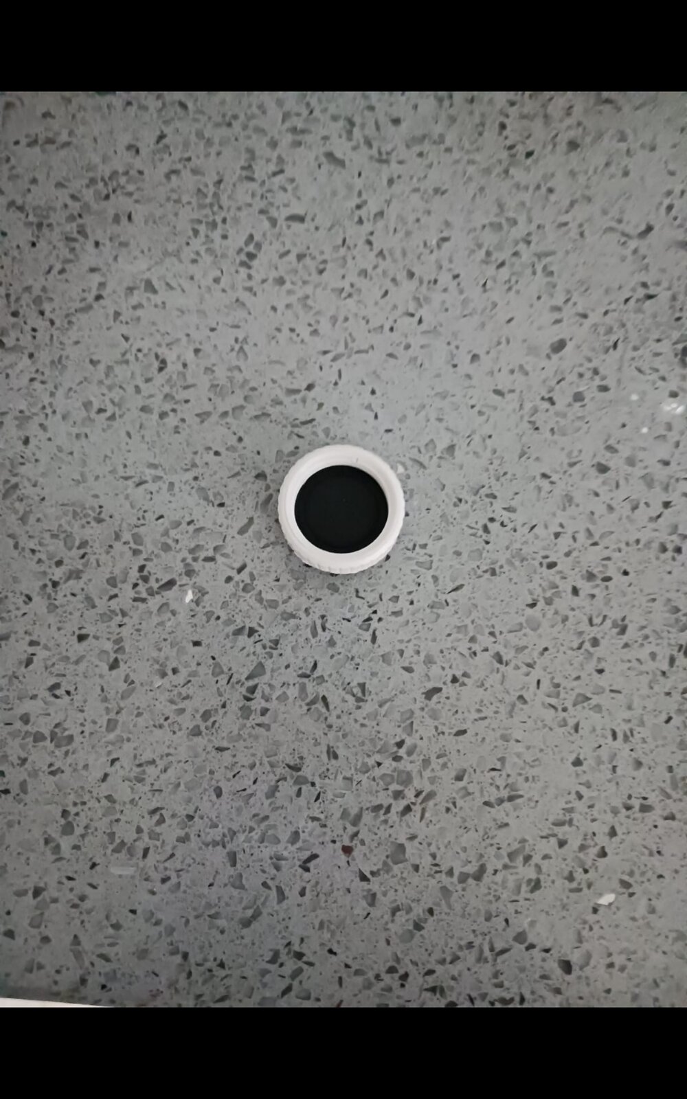

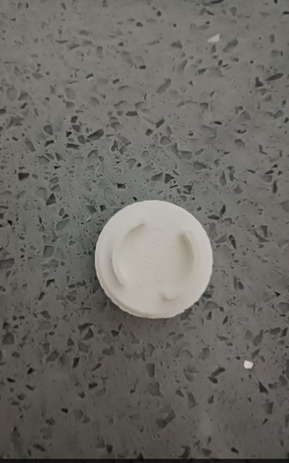

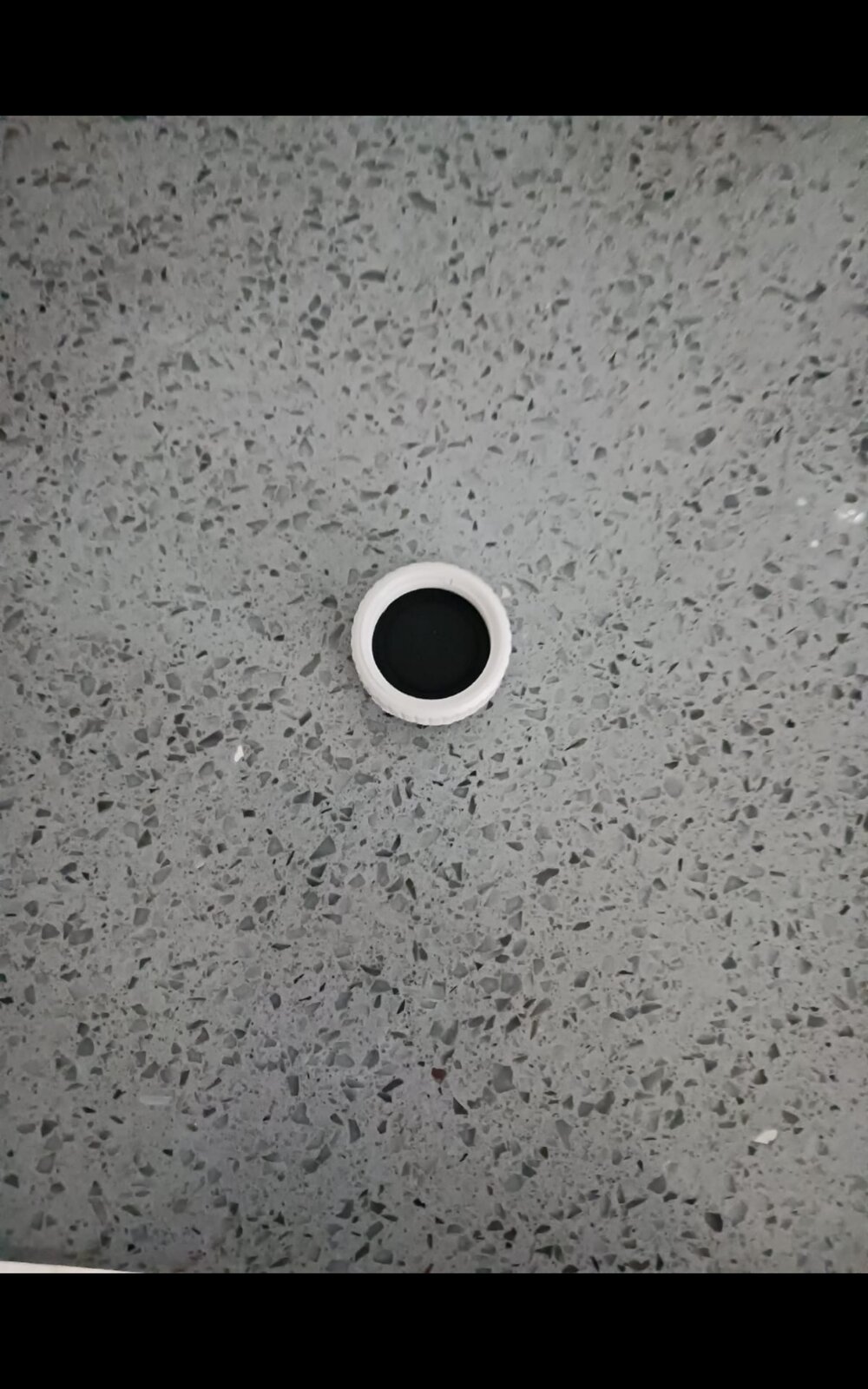

Some advice needed please re a 3 year old Worcester Bosch combi gas boiler. The hot water works but no heating. A gas engineer was already booked to do the annual safety check before the fault developed. He said the boiler is ok with no fault. He said there must be a leak under the floor boards causing hot water to escape and that is why the boiler is contiually running as it thinks a hot tap is open. I have 2 questions please..
1. If there is an underfloor leak shouldn't the boiler pressure guage be dropping? but it is not..it is constant at 1.5 to 2 bar.
2. The engineer left this part behind after he did the safety check (see photo). Is it part of the boiler?..i have pictured it from both sides..many thanks!

Oh dear, look at the top of the boiler, where the flue comes out the top of it, You should see to 2 openings in it, one with a wee blank and the other that may be just an open threaded hole at the moment, if so that cap screws onto that open threaded hole, get it on there straight away.
something like this

Many thanks ..any idea what the bits are in the photo in my post?.. i think the gas engineer left them behind when he did the annual safety check..bit concerned if they belong in the boiler!..thanks
