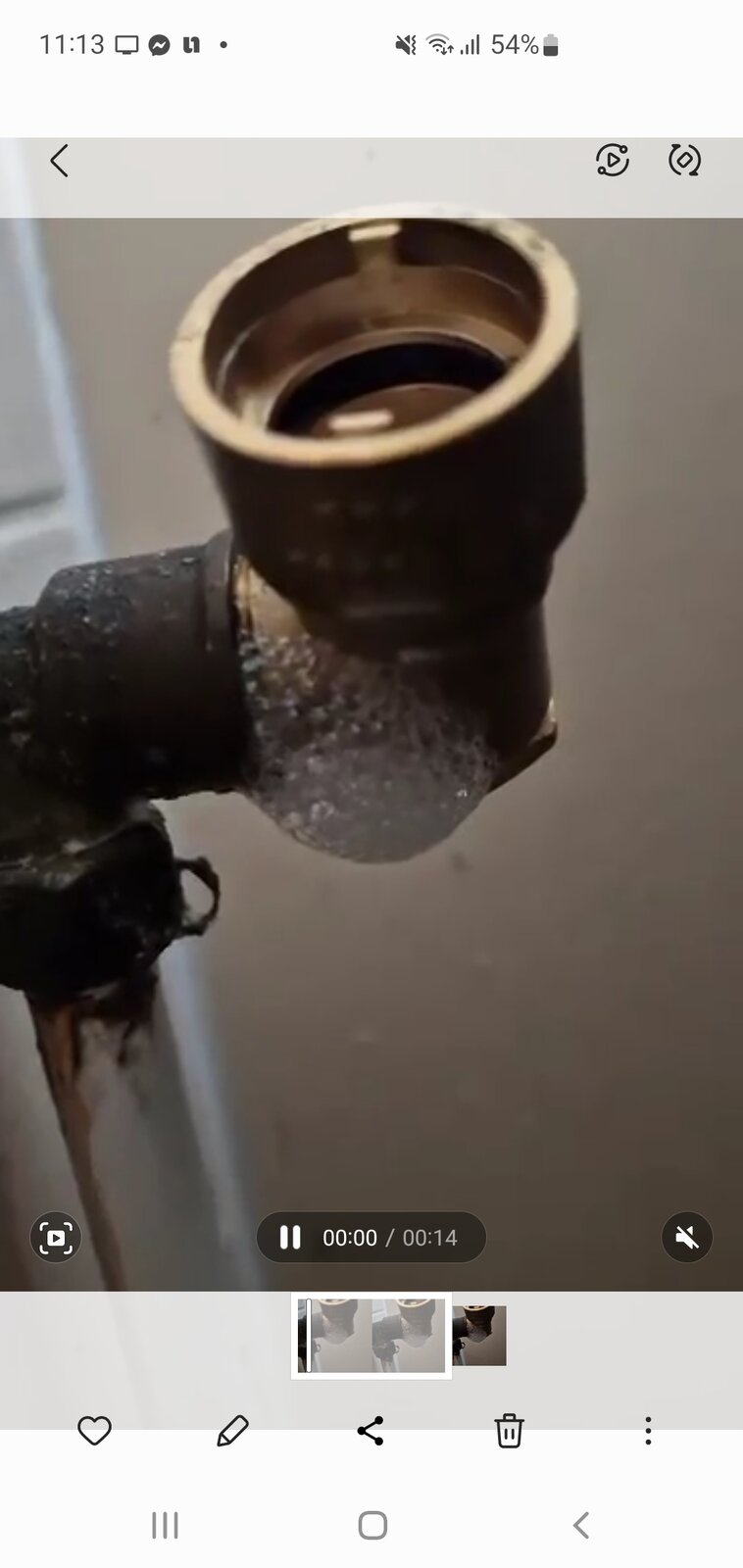

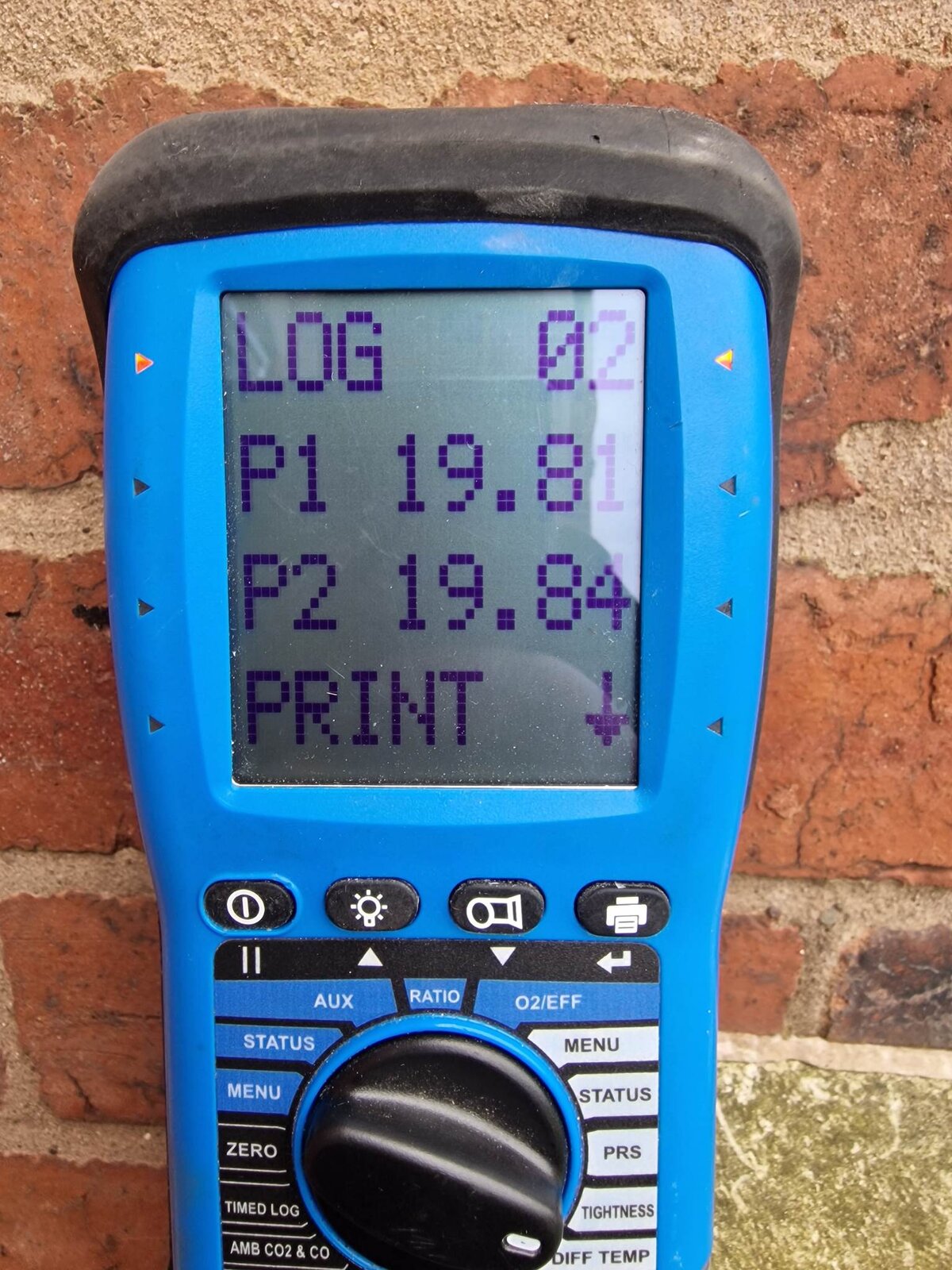

Hi so basically I had a brand new gas cooker installed in my new property 7th Jan 2023 by a gas safety registered engineer, come April time (can't remember exact date) my boiler (unrelated to this I think) broke down so had no gas over the weekend until parts was ordered by my landlord (Housing association) so I did a creep test on my gas meter to see if there was any issues with the gas in the property as my gas bill each month is nearly £300 since moving here (3 bed semi detached house) my meter reading was going up even though I hadn't used any gas appliances ,so I rang my energy supplier who said call cadent it's a gas leak (couldn't smell a thing) turns out there was a leak at my meter and one on my cooker ,they cut the supply of at the property and I now had to pay someone to fix this leak so my landlord could fix the boiler ,because of this gas safety can't investigate his work, the guy I got out to fix the leak was also gas safety registered and said there was hardly any ptfe or paste which caused the leak which couldn't of been caused by me? The guy who originally installed it is having none of it, won't refund me or pay for the work I've had to pay for to fix it or admit he's at fault ,he seems to think I've cause the leak, can I go to a solicitor about this as this isn't fair that he's still allowed to carry on working knowing what he did ,thanks
This is the test

You calling that a gas leak?
What was the test time
So the pressure has ‘risen ‘ from 19.81 to 19.84 or gone the other way and in what interval?

If that’s the only evidence you have, then there’s not much a solicitor would do, imo. However, I know Cadent usually always leave paperwork, but this again doesn’t prove much. As per @DP - that may have risen by 0.3 mbar. Who did that test?
Are you a qualified gas engineer? Is this a joke? If you're not and this isn't a joke, then what why are you doing your own TT?
Is P1 the start reading and P2 the end reading after the allotted time has passed?

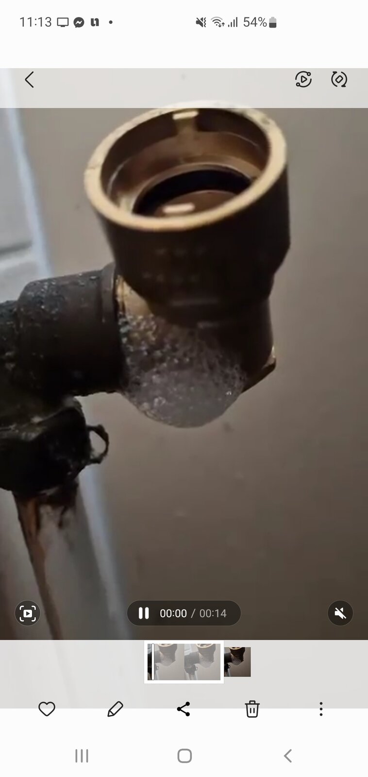

I am not a gas engineer I haven't got a clue what this all means ,I'm just showing the tester he came out with ,i cant attach a video it wont allow but il screenshot the video and atach it of the gas leak at the cooker , possibly they could , but he's made it clear and sent all photo and video evidence to me that this isn't something I have caused

No I an not gas registered and no this is not my tester. I will attach the photo of the leak , video won't upload , I do have proof of the other gas safety guy who rectified his mistakes , it was something I couldn't of caused as the guy who installed it is trying to claim, the way he's acted about me asking for him to come and fix the leak, fully refusing to take alot saying he's been doing the job for 20 years I must be lying, gas register can't look into as I payed someone else to come out , so yes my next option would probably be solicitors ot trading standards if that's something I can go to for this, I don't really know but i am not happy about just leaving it when he quite frankly could of killed us.

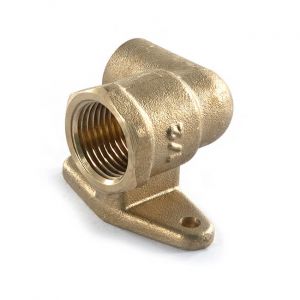

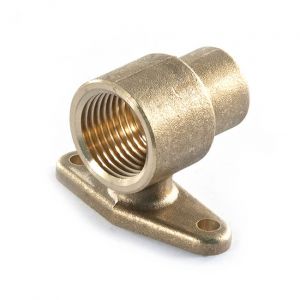

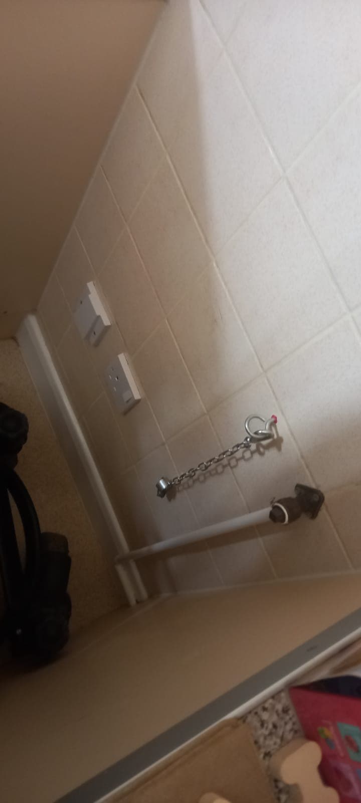

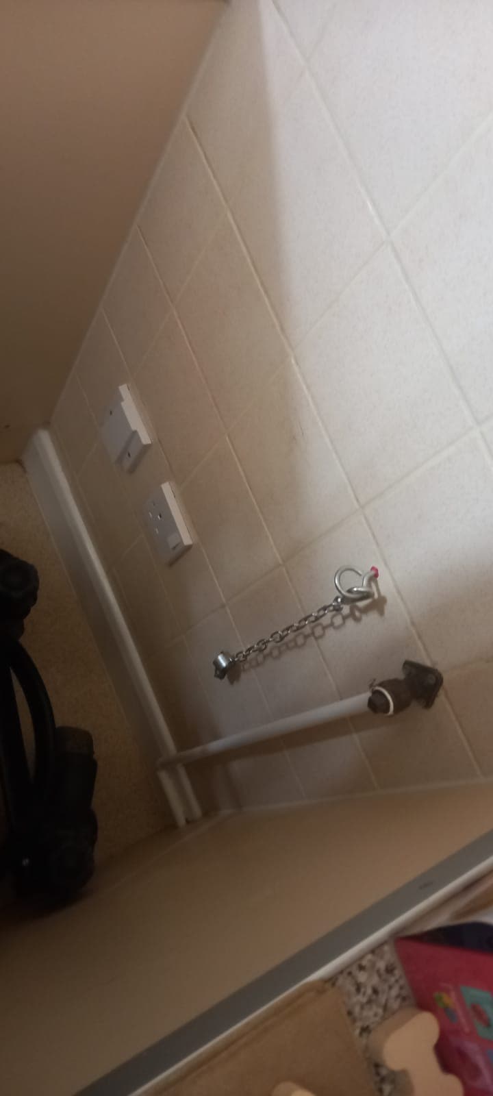

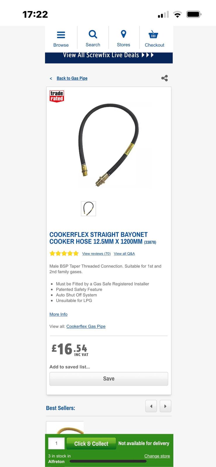

is that bayonet facing up the way ? was the pipe it was attached to properly clipped to the wall as that elbow is not the fitting that should be used when fitting a cooker .
should be using either of these
Have you approached the original guy who did the work.
The tester readings and the leak ( shown in the picture) make no sense ie if the leak is there then the tester should have shown a much lower reading, unless the last chap was covering his tail with test and photographed the final readings, after fixing the leak he found
View attachment 303115View attachment 303116
