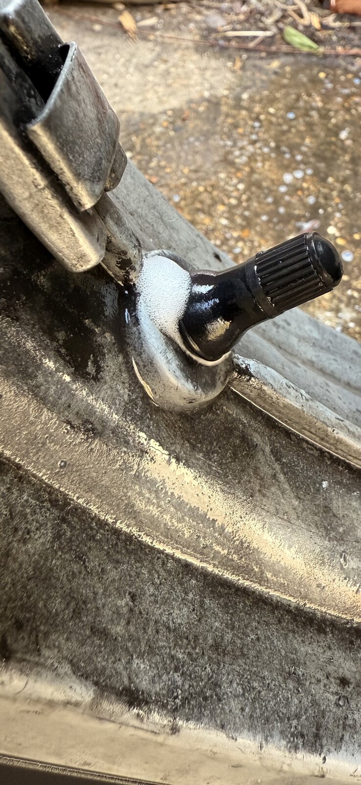

You probably won’t. Lay the wheel down, use some soapy water and put it around the rim. Wait. If you have a slow leak at the bead, you will see a 'froth' build up. It could take 5 minutes or more. Don’t forget all around the valve and of course, check both sides of the wheel. If you find a leak, see Harry’s post, above.
Here’s a leak I found on my bike. It would take a week or more to start going soft. It took a few minutes to get to this state.
