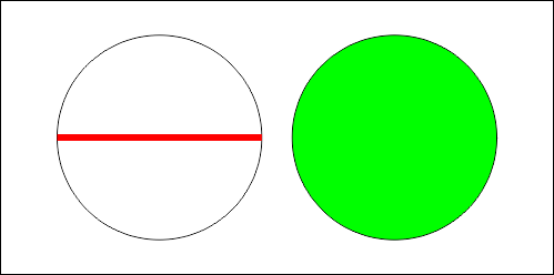

Sorry, am confused, what is the difference between the cross section of a circular/round conductor and the diameter (of the said conductor? Perhaps you assumed that when I asked about the diameter of the flex I was referring to the diameter of the flex including the insulating material- I was referring to the diameters of the conductors in the flex.
I did - but it's the same difference.
Diameter is the length of the red line.
CSA is the area shown in green.
Two entirely different things.
Cables are specified by csa, not diameter.
Duh, thanks guys.
I now get it, although EFLImpudence clearly said "cross section area", my brain interpreted that as "cross section".
Feeling a tad silly now, for what it is worth I did take my A'level maths a year early and studied advanced calculus as part of my economics degree. I blame my english teacher ;)
