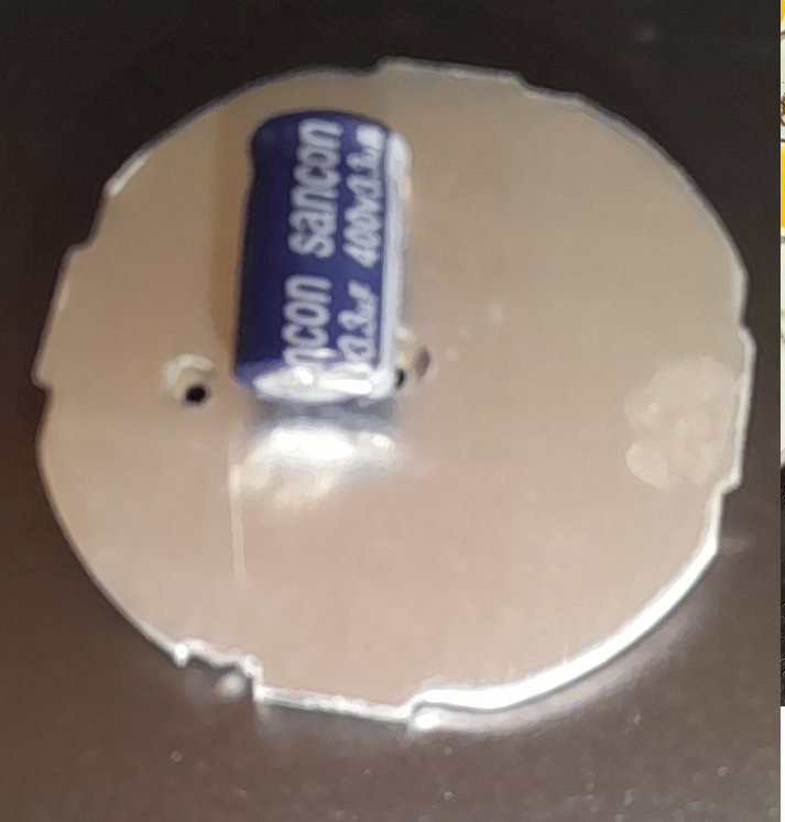

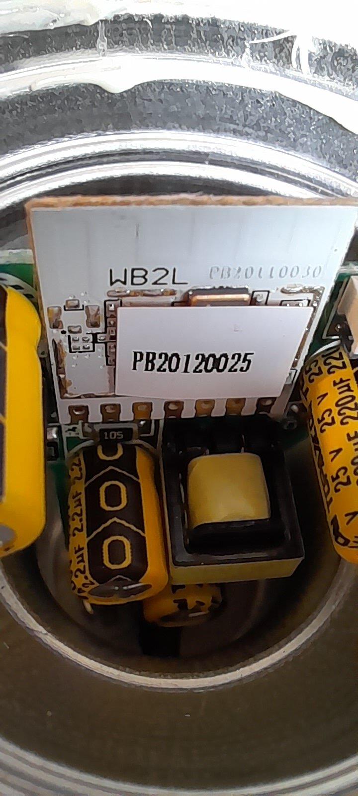

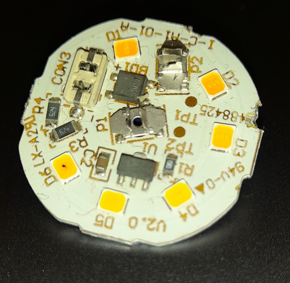

My GU10 spot lights will start flashing when ready to be programmed in. Not a fault as such. Inside the lamp it can be complex 20220603_113820.jpg but it can also be rather simple bulb inner1.pngbulb inner2.png so there is no one cure fits all. And the complex bit can be inside the lamp, or part of a power supply.

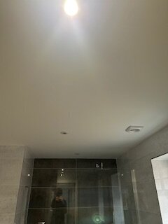

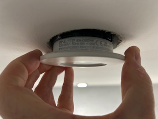

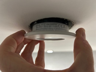

This is the light working, this is the light that was initially flashing.... the other 2 (further away, roughly in line) are the 2 that no longer work, but did when the initial problem of flickering started in the light that now works.....

The flashing light needs replacing
Thank you - can I just check you mean the one that was initially the problem but now appears to be working as it should - thats the one I should replace? Even though that original flickering one has resulted in the other 2 (that were fine) not working at all?
If the flicker one is now working properly and the other two not working you need to check the connections. Please switch off the circuit before you try anything
