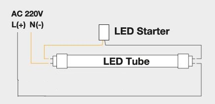

Hi group, going all ECO friendly I decided to replace the old fluorescent tubes in my strip light for the newer LED equivalent, the ones I purchased come with their own starter, however my luminaries don't have a socket for a starter. When I try to switch them on I don't get any light, it's a double tubed light which feeds another 2 in my workshop which I was hoping to also replace.
Any advice would be really appreciated, the pictures show the unit working with the old tubes in it.
Thanks...
The electronic ballast needs removing, the LED will work with a wire wound ballast but not electronic.
The pins either end need wiring in series, one end of the LED tube is 230 volt feed into the tube, the other end is a direct short, so to be able to fit the tube either way around the two ends are wired in series, removing the ballast even with a wire wound does make them more efficient.
I note it was a twin tube, when rewired the two tubes are independent of each other, when I got the LED replacement it had instructions in the packet, the new starter is really a fuse, not really required, but I will look for wiring diagram.
A "LED Starter" for a replacement to a conventual fluorescent tube is actually just a (2 A) "fuse". which is designed to fit into the Socket previously occupied by the "Starter" - in series with the Inductive Ballast.
If there was only an Electronic Ballast, there will be no "Starter Socket" - so the protective "fuse" cannot easily be installed.

When I fitted one I powered one end only, but if you fit tube wrong way around then short circuit.

Your fitting is an Emergency fitting, it is not suitable to convert it yourself.
A new led emergency fitting is recomended
