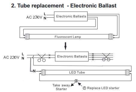

If the start method uses an electronic ballast, then internals need re-wiring to get rid of the ballast completely.

This wiring diagram
for the electronic ballast is dangerous, as the tube has supply to one side, and short circuit the other side, so if put in wrong way around it is a short circuit, also if the magnetic ballast is left in place, it reduces the power reaching the LED tube, so although it may use 18 watt, it is likely not at 230 volt, but a lower voltage so amps go up, so with ballast left in place as a whole unit it uses more than 18 watt.

The main problem is the electronic ballast when removed needs a re-wire like this
This means it does not matter which way around the tube is placed, and the fuse replaces the starter so if some one fits a fluorescent instead of a LED it simply blows the fuse, as two heaters will not take 230 volt they need the ballast to reduce the current/voltage at the starters.

The main problem is the electronic ballast when removed needs a re-wire like this View attachment 278736This means it does not matter which way around the tube is placed, and the fuse replaces the starter so if some one fits a fluorescent instead of a LED it simply blows the fuse, as two heaters will not take 230 volt they need the ballast to reduce the current/voltage at the starters.

I've just realised a confusing error in that drawing
