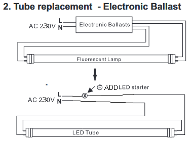

But 'take away starter' ?

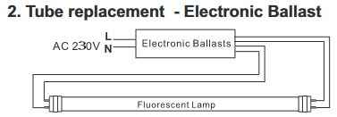

Are you perhaps misinterpreting what it is says? I take it to mean (with my red additions, hopefully to improve clarity) ...
Take away the starter and then Replace it with the LED starter
Other than for describe the fuse as an "LED Starter" (which seems an almost universal practice), that seems clear and correct enough to me.

It is not correct. It is wrong and needs to be corrected quickly before it becomes universal.

The LED replacement for starter is really a fuse. So not really an error.
Ahhhh I see some confusion here...
I was working from the drawing from post #11 which is wrong.
This may be a little less wrong:
I do understand the convenience of adding the 'LED starter' into the cut wires between the tube ends.
However Fluo fittings almost invariably contain a fuse so perhaps the need for an additional 'LED starter' doesn't actually exist, we just need to verify the correct fuse is fitted if there is an existing fuseholder.
I would think in the main the starter replacement is there for ease of wiring when converting, since one end of the tube is a short circuit the pins simply connected together, moving the position of the fuse hardly matters.
I'm afraid you're missing my point

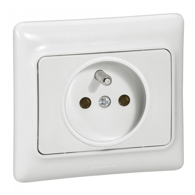

I see the problem an electronic replacement for a wire wound ballast is not technically a ballast, we have this throughout the lighting industry, the electronic transformer is nothing like a toroidal lighting transformer, and most GU10 and G5.3 LED lamps are not MR16 as they have no multifaceted reflector, bulb refers to bulbous shape so a GU10 is not even a bulb. But neither is it a lamp, historically we had a spigot on the wall, and the lamp fitted on the spigot, the lamp had the oil reservoir, the wick and wick adjustment, and the globe which fitted over the wick.
This 1662642533916.pngis a plug socket, the earth is reverse to lives, but in the UK we have a socket, but so many people still call it a plug socket.
The problem is once one gets pedantic where does one stop? I see a problem calling extra low voltage low voltage, there is a massive difference between 12 and 230 volt, but if it looks like a duck and swims like a duck then it's a duck, even if technically a swan.
Ahhhh I see some confusion here... I was working from the drawing from post #11 which is wrong.
It sounds as if I made the mistake of thinking you were referring to the drawing you actually included in post #14 :)
Kind Regards, John

This View attachment 278987is a plug socket, the earth is reverse to lives, but in the UK we have a socket, but so many people still call it a plug socket.

Plug socket is a funny one as it is a socket for a plug as opposed to a socket for a ball (such as hip joint) or socket for a vaulting pole or fence post etc. I certainly don't get hung up on people using the wrong terms, such as plug socket, plug top, fusebox etcetera as long as we both know exactly what is being said and intended.
To me a plug has pins, a socket (strictly a jack {and the origin of the popular connectors known as jack plugs and sockets}, although a jack also pushes against or lifts things) has holes
