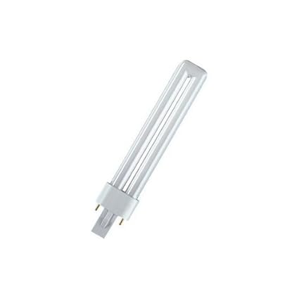

Mine can't be quite same design, as noted they make the fan in the same room look as if it's turning slowly, so don't think they have the smoothing capacitor. I think I have just one CFL bulb replacement left in service, in the garage so not used much, however I also have a folded tube reading lamp. It uses a PLS Compact Fluorescent Lamp 11 watt Warm White 830 these are still considered as CFL even though only one fold in the tube,
these are rated 900 lumen so around 82 lumen per watt, with a 11W Phillips LED bulb you can get 1055 lumen 96 lumen per watt, but many are a lot lower output, with the scrolled tube an 11W is down to 600 lumen so with the standard CFL the LED wins, but with the one shown it still gives the LED a good run for the money.
