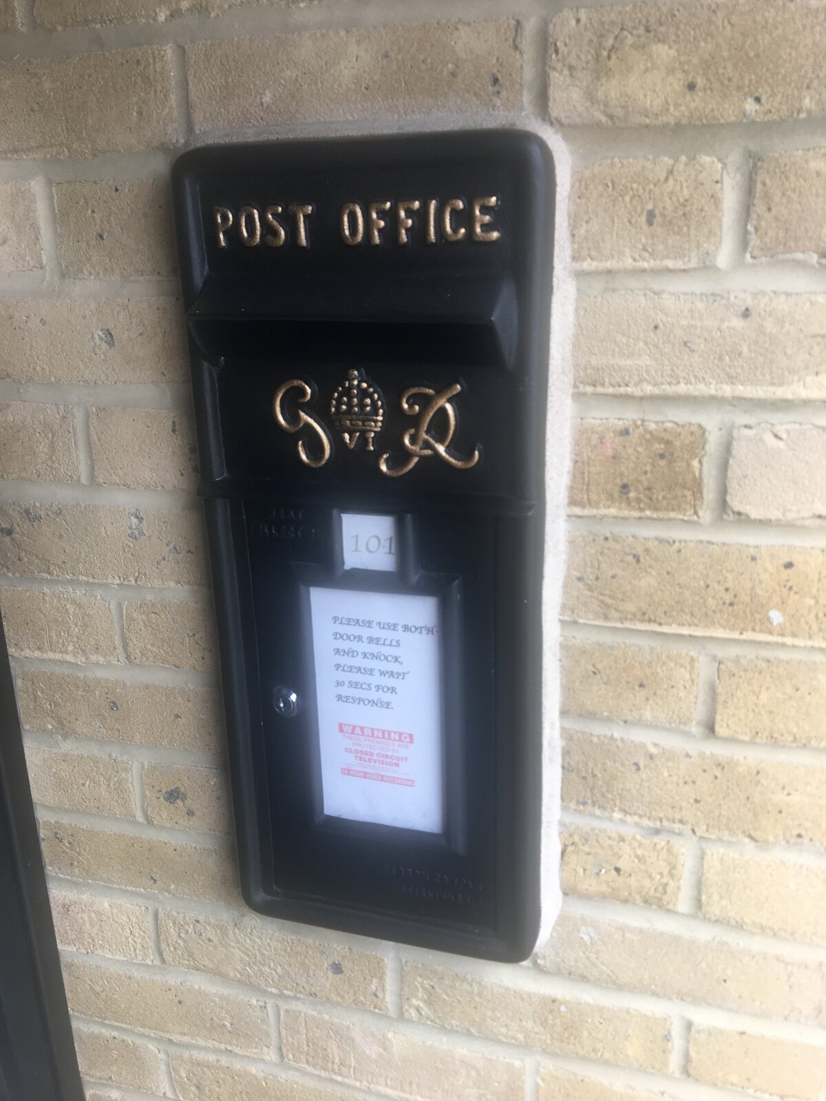

good morning.
I like to pick your brain on what letter box or letter box plates (inside and outside) I can have to replace existing draughty letter box in porch wall built in single brick wall.
external letter box plate is metal and non-sprung so it rattles at windy days or night. it is fixed to metal bracket inside the opening.
The opening in the wall is about
265mm (width) x 65mm (height), the wall thickness is about 109mm.
https://imgur.com/IX5Ovt9 shows the letter box location and porch.
thanks a lot for your help.
you can copy and paste photos into your post. No need for a link to other sites.
your pic is not very clear, but I can see the letter flap is in a bad position. It is close to the door handle so that a simple home-made tool can be used to open the door and even turn a key from outside. Children with small hands and thin arms are sometimes used for this job.
So I think you need at least a cage on the inside, preferably a box. In your case, the letter slot is on the inside of the wall, so a small cupboard can be used and look quite neat (with the hinge on the door-handle side to frustrate attempts to open it)

image.jpgI used large mail box , you could then seal the inside removing any chance of draughts.

most letterplate/box 's sleeves can only accommodate a depth of 80mm when two sleeves are connected together, it is still shorter than my wall thickness of 109mm.
how can I get around this issue ?
You could make a liner out of UPVC or thinner plastic. You might be lucky and find extractor trunking that's slightly bigger that you could modify
