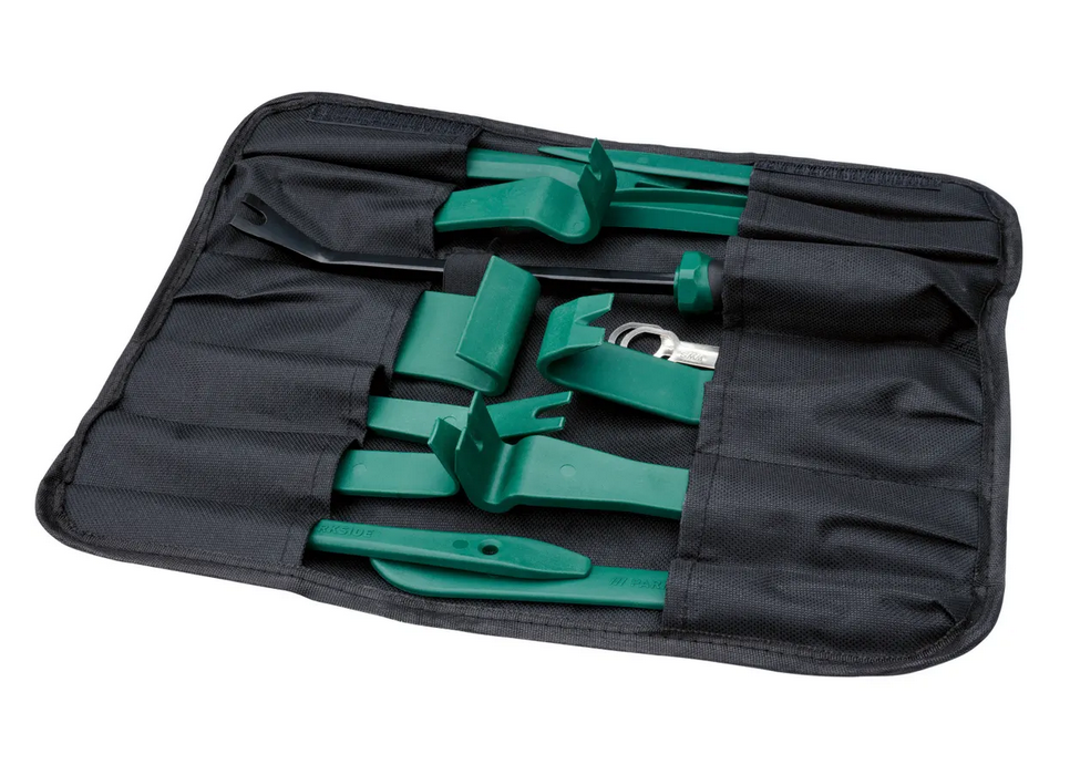

The car trim panel removing kit is in our Lidl atm too, that's £8 too, looks like a bargain for anyone in need.
