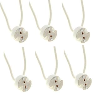

2. The sockets seem to fail all the time - I seem to be replacing them almost on a monthly basis. This is a pic of what I'm replacing:
Every time I have to take the recessed fixing out, it damages the ceiling plasterboard more and more. I'm getting fed up of this.
3. Bulbs failing all the time. I have noticed that when I take a blown bulb out, almost every time one of the two pins is gleaming & the other one is deeply tarnished. Sandpaper the tarnish off & put the bulb back in, bulb half the time is working fine. What's going on?

Your SELV lampholders are burning out.
Are they overheating?
One issue often overlooked is that of a fitting being fire-rated, and the fitting has the incorrect type of lamp fitted. If you have this kind of fitting, you need special aluminium-backed lamps. They throw as much light (and consequently heat) out of the front of the lamp and less out of the back.
Ordinary lamps send more heat out of the rear of the lamp, thus overheating the lampholder. This can cause serious overheating and damage.
If you do not have fire-rated fittings, you may have cheap lampholders or insulation over the fittings or a combination.

Lampholders - standard cheap recessed ones - but new install, so should be fire-rated. Bathroom lights have been particularly bad. They're IP-rated but don't seem all that steam-proof - maybe the the steam from showers is affecting them?
