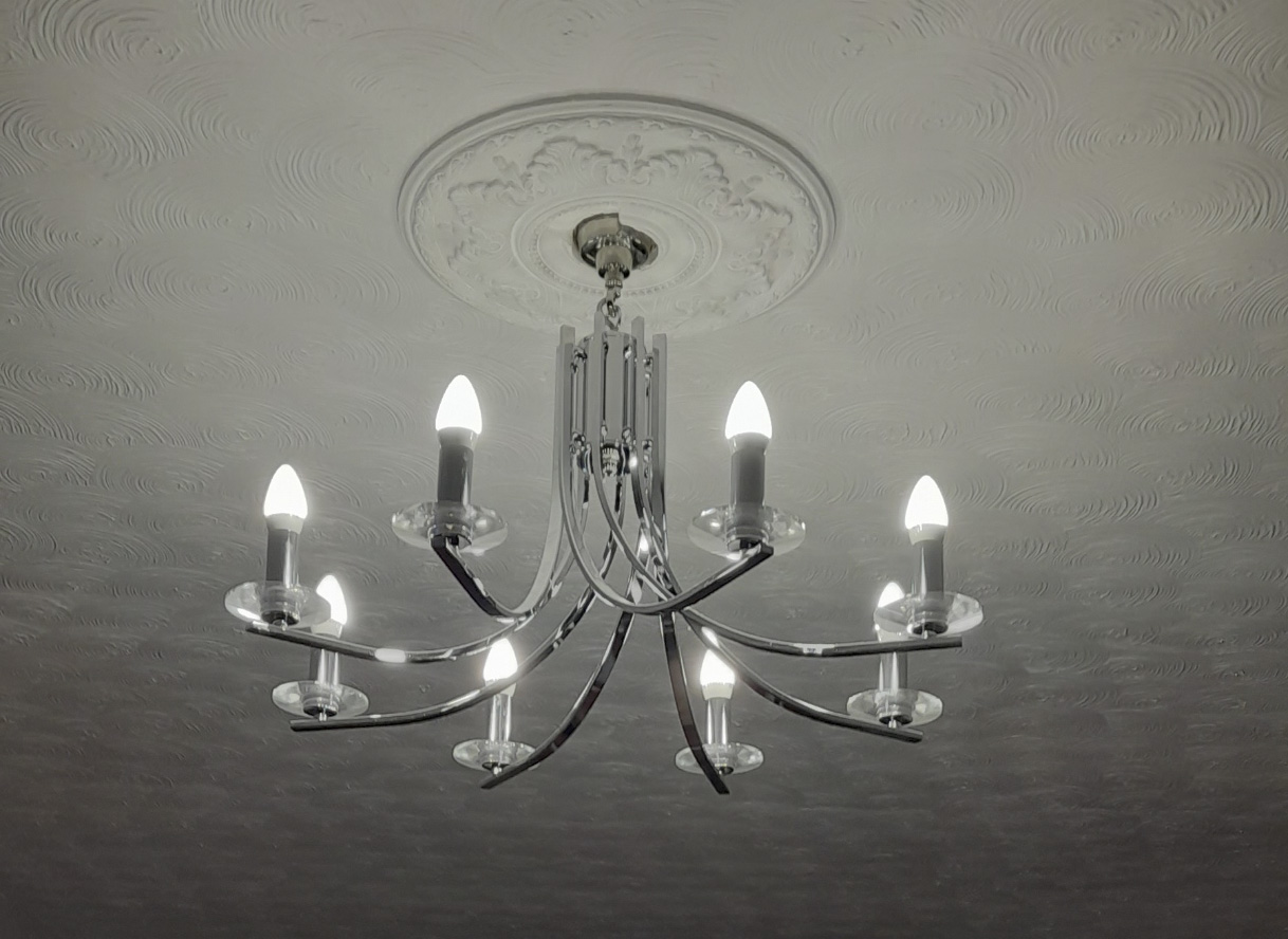

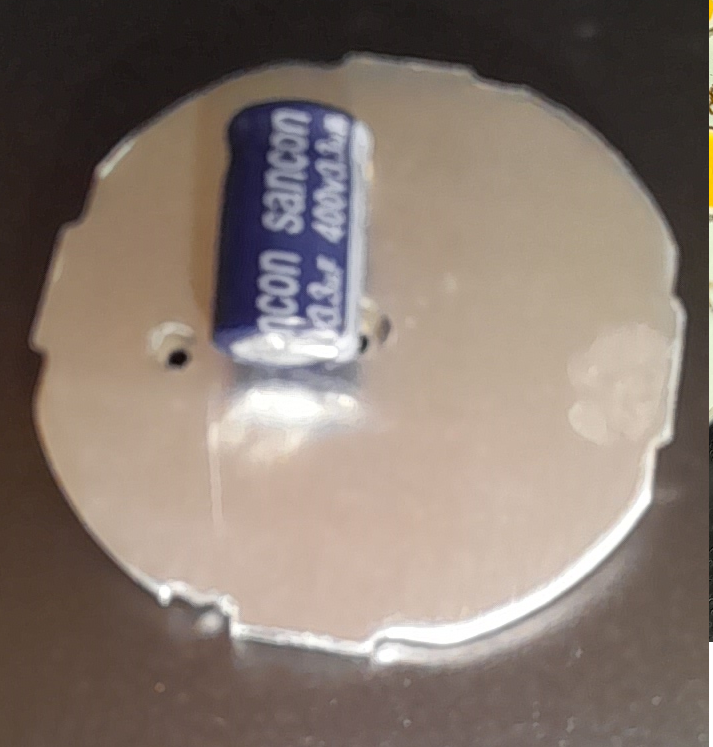

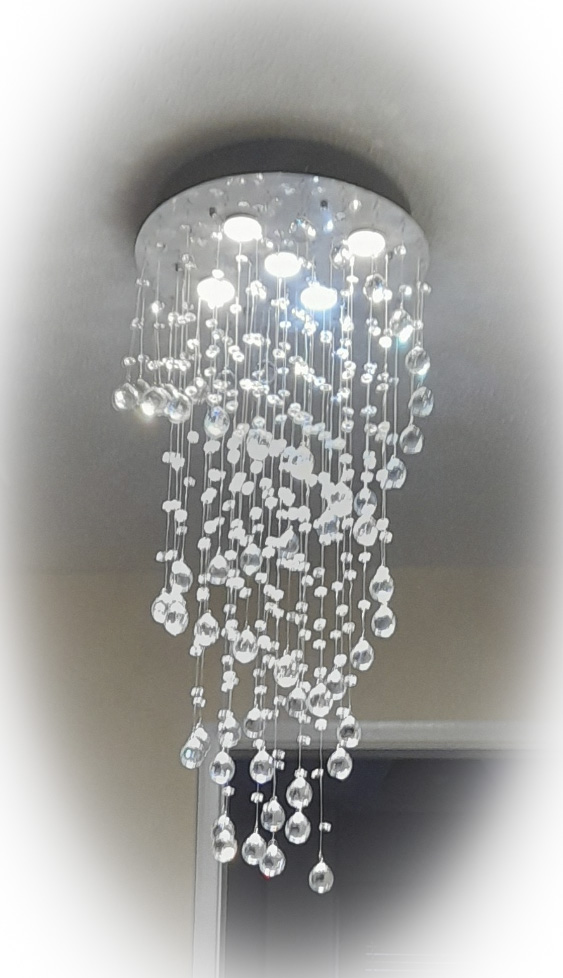

I think there is a problem with LED bulbs over heating, the typical LED bulb has a composite printed circuit board, bulb inner1.png which can shield the heat from the electrolytic capacitor on the other side bulb inner2.png and with the base to the bottom, as shown here20220415_000328_1.jpg with this chandelier the capacitor is kept cool, and the light reflects from the white ceiling giving a good spread of light, but with same bulbs facing down, one the capacitor gets warmer, and two the light is absorbed by the dark floor. Add to that and put the lights in a tube in the ceiling, and the bulb will get even hotter, plus of course in the ceiling in the hottest place in the room anyway. I use GU10 lamps, but mainly in pods, so better cooling and aimed at parts of the room which would otherwise be dark.

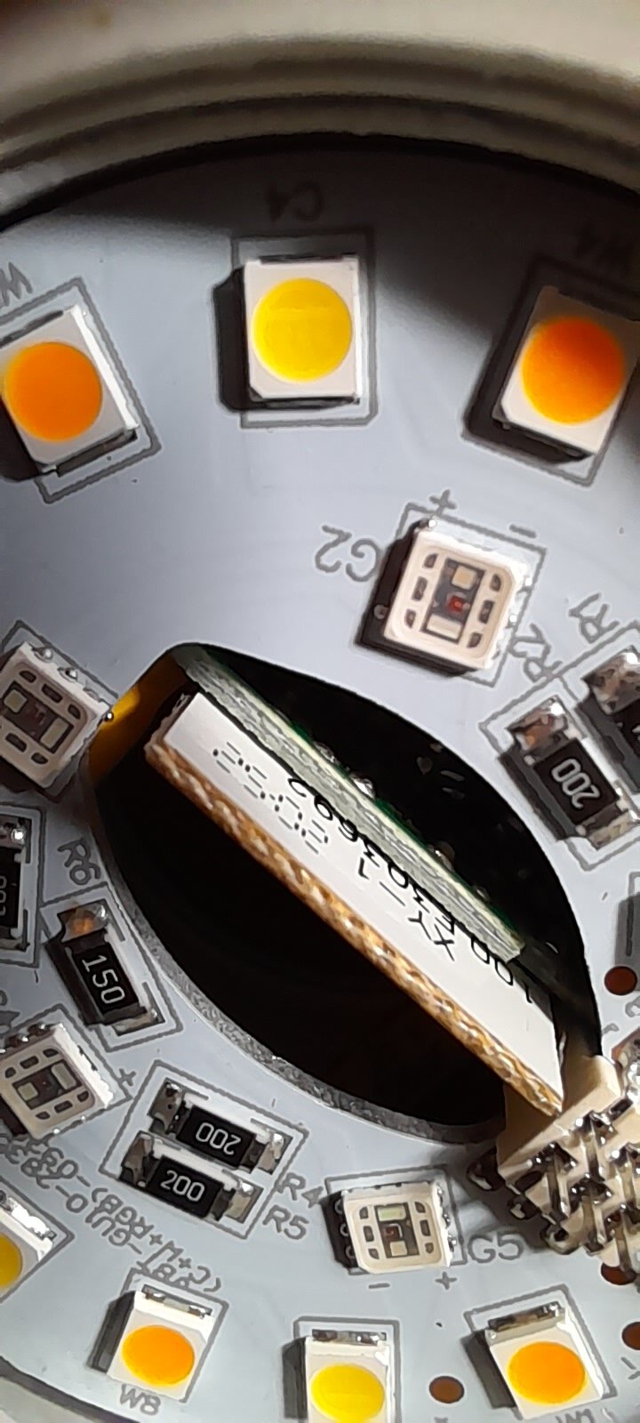

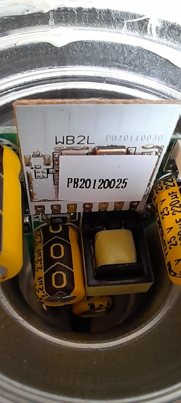

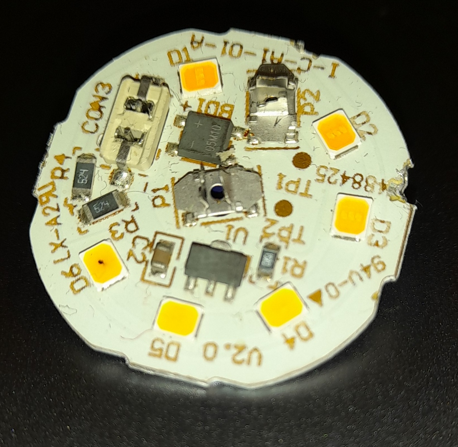

I do have one lamp where the bulbs are recessed, lamp-landing_1.jpg but there is a large space around the bulbs to allow them to cool. I opened a GU10 (failed) to see what was inside 20220603_113820.jpg and there was far more than I expected, 20220603_113222.jpg once I removed the plate with the LED's on it, so one can understand why they don't like getting hot with all those electrolytic capacitors. But in the main it is luck, the centre bulb in the GU10 chandelier was one of two, first one used in kitchen, lasted around 4 months, second in chandelier now around 4 years old, so in the main just luck, some last years others just months.
