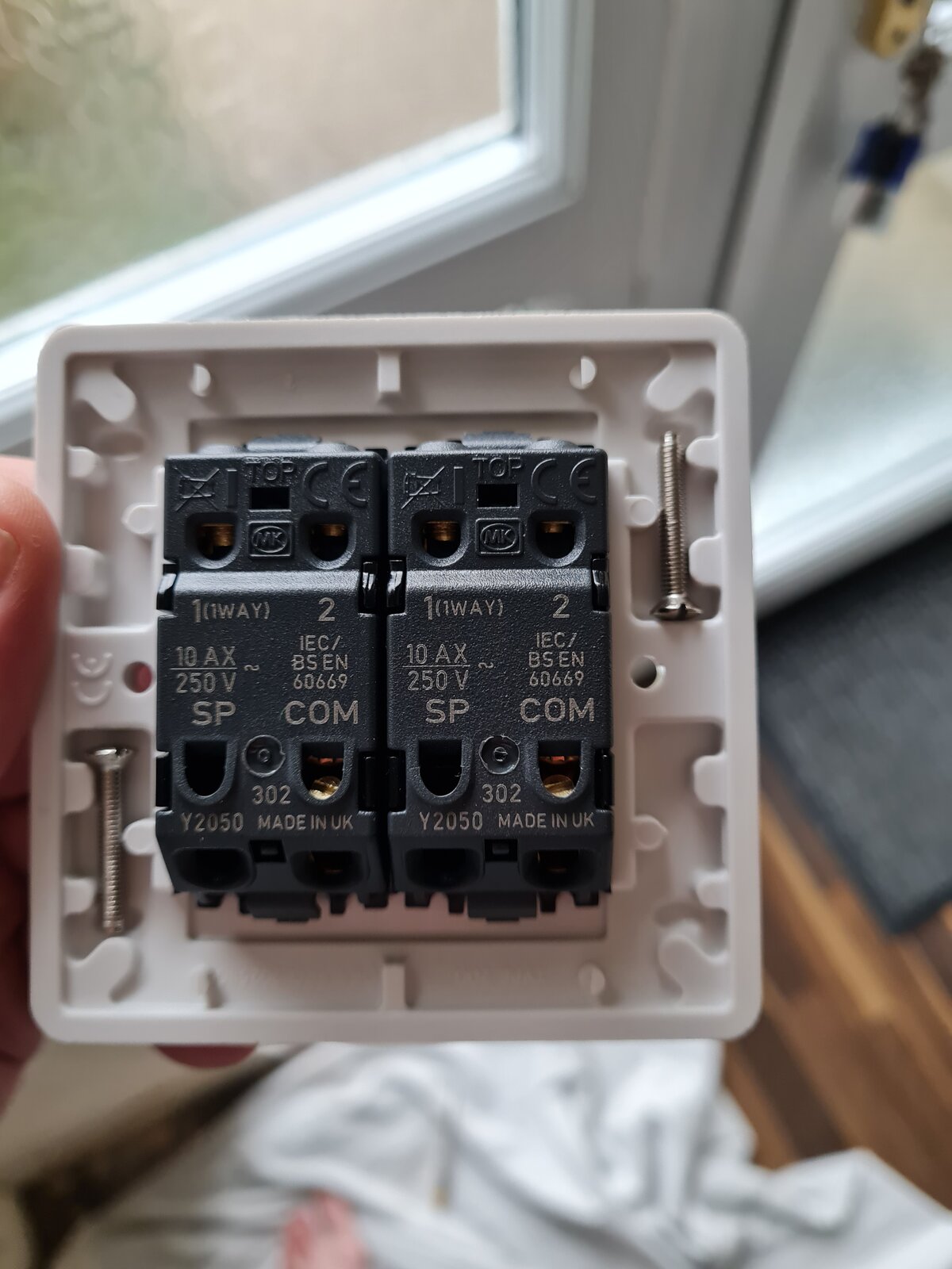

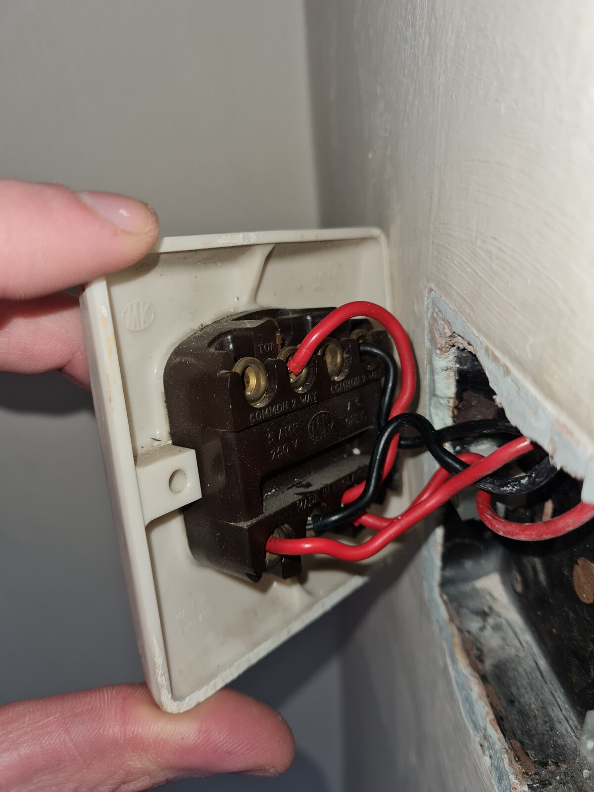

I'm just swapping out some old switches and I'm trying to understand the wiring and how to wire in the new switch.
It's a double 2 way switch, so one controls a light downstairs and the other controls one upstairs. The upstairs light has its own single switch upstairs aswell
Thanks for any help. I've tried reading other threads but still struggling to understand the correct way of wiring it in

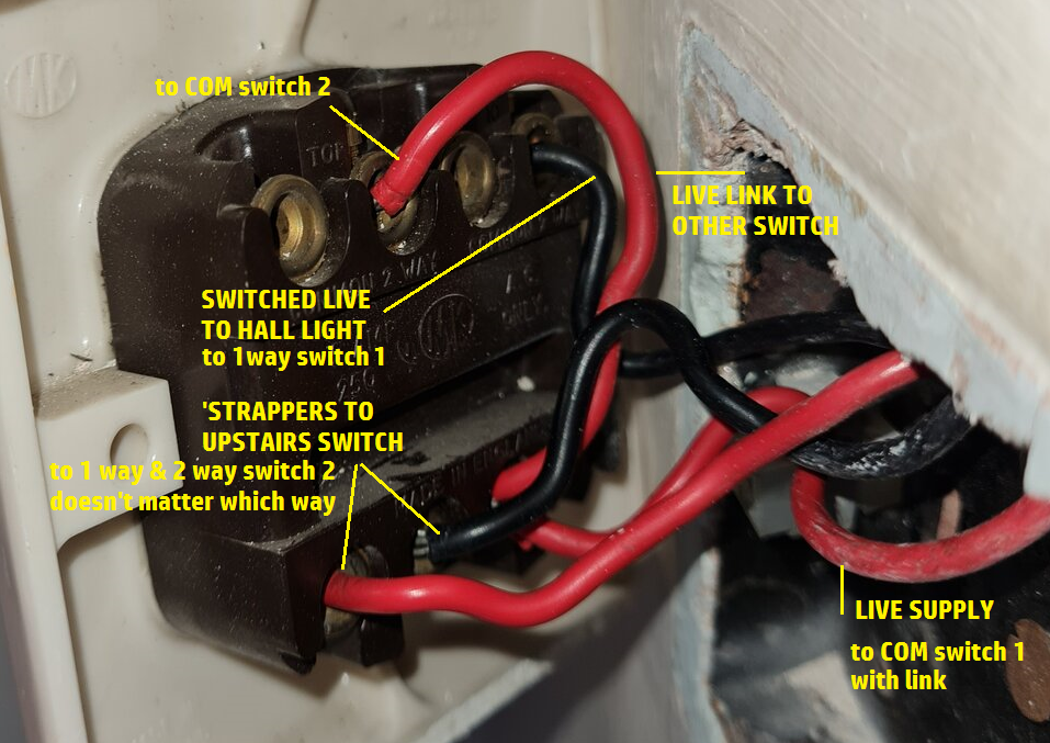

Well, this will be the usual way going by the wires present but -
I am a bit puzzled by the markings on the old switch.
