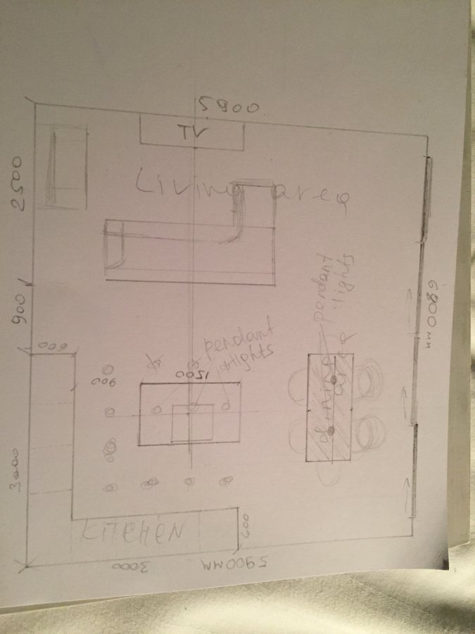

Hi guys, hoping someone can give us some ideas about our lighting.
We have a 6m x 6.5 extension which is an open plan kitchen/diner and living.
The wife wants 2 pendants over the dining table, and over the island. But we arent sure what to do about the spacing in the living room and kitchen.
The ceiling height is 2.5m, we also hve large 6.2m patio doors at the back, not sure if that will effect anything
I was thinking the livingroom lights will be 1.18m apart, 8 in total. Then with the kitchen, have 2 pendants over the island and then 3 or 5 spotlights running along the walkway of the kitchen if that makes sense.
Any advice welcomed

How is the extension roof constructed? I mean, is it a single story extension with a flat roof, or is it a pitched roof/ceiling, or are there rooms above?
What state is the extension in, is it fully constructed, plastered etc or is it ready for first fix electrics?
Also, the corner L shape marked "kitchen" is this just worktop, or are there wall cupboards all round on the walls?

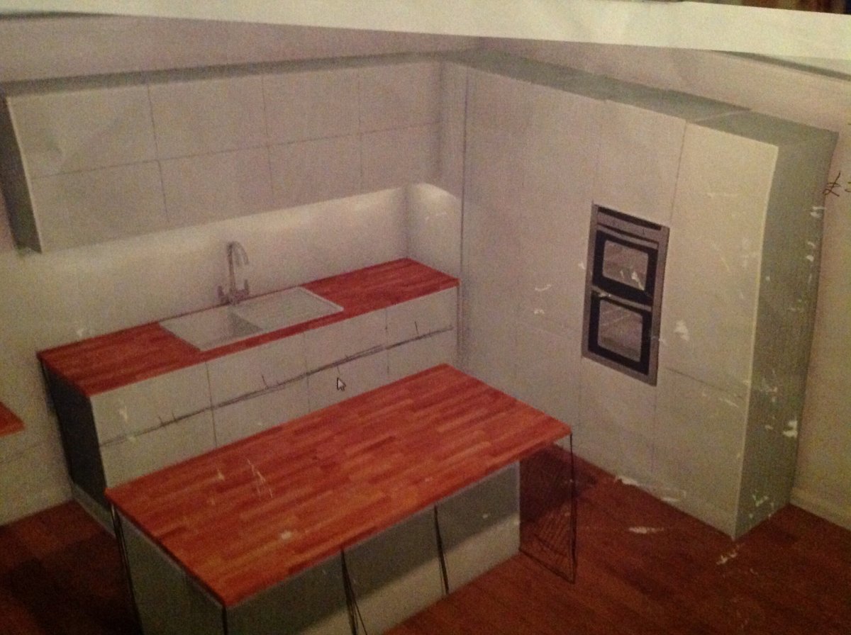

Its a flat roof extension, at the minute the roof is on and we are waiting to decide on light positions in order to continue, ring main wiring has been done. There will be wall units there too, heres kitchen plan in picture

We have something similar is size and function. We decided that the kitchen area would use spots and under cupboard lighting, plus a variable height pendant over the table. The 'living' area is lit by a set of lighting sockets, all controlled by one wall switch. So we can arrange plug-in lamps as required to give a reasonable lighting effect. It works for us.
Peoples reactions to various lighting arrangements varies.
If it is a flat roof, then you have a serious problem with any recessed lighting, unless the roof has been designed as a 'warm roof' construction.
Normal/standard flat roof/ceilings are designed as cold roof and are provided stuffed full of thermal insulation. You will incur the wrath of building control if you go chopping great big chunks out of the Kingspan, and the moisture barrier, to enable your downlights to be sited.
Time for a rethink on that, maybe?
What about concealed LED strips around the perimeter of the room?
You don't really want pendants in the kitchen, as they'll pick up grease and dirt. I assume that the island has the hob in it, so how are you venting the cooking fumes. A pendant over the hob isn't really a good idea. Looking at the picture of the kitchen, you've got lights under the cabinets which is good, as the position of the ceiling lights means that you would be working in your shadow.
But you haven't mentioned what sort of lights you're going to use. LED downlighters don't throw much light sideways, so 1.18 may be slightly far apart. If they are LED downlighters, then find out the beam angles, and see what the coverage would be.
