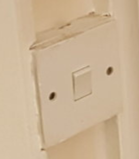

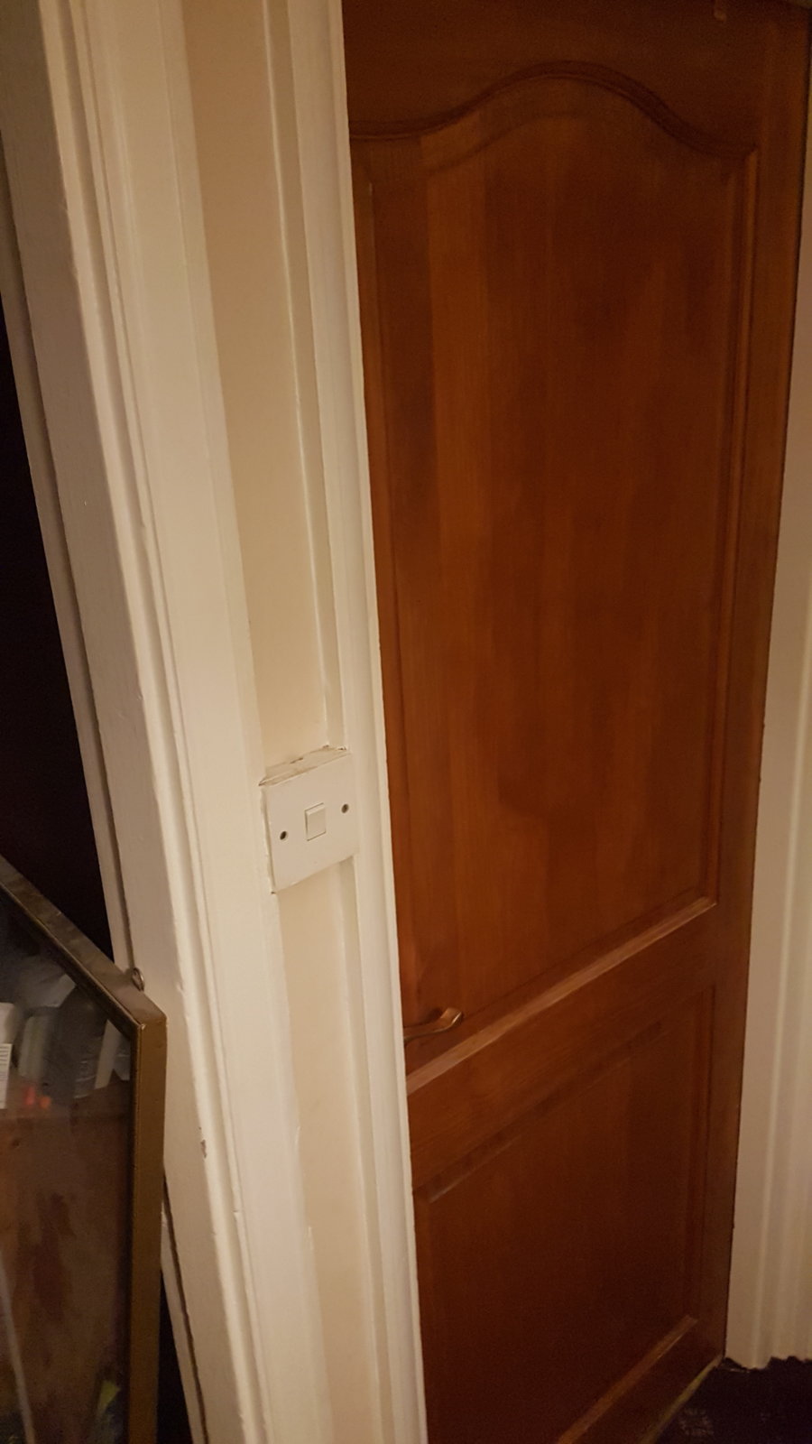

Upstairs landing light switch doesn't fit between the architrave. (See photo)
Options are fit architrave switch, although once flush mounted might be hard to operate or make a wooden square for a standard light switch to flush mounted to. Or move the switch, although it's current position makes the most sense.
The only other logical place has a socket directly below so would be difficult to route the 2 way switch cables to the downstairs switch

Well fitted and filled block of wood - or two pieces, one top and one bottom of switch.
It only looks poor at the moment because of - what is it - dirty caulk?
IMO it looks poor because the architrave has had to be cut away.
And even if cleaned up and done more neatly, IMO it will always look poor.
Either an architrave switch (which will be fine to operate unless you're wearing boxing gloves), or replace the architrave with narrower mouldings. The two where the switch are will need replacing anyway if an architrave switch is recessed into the wall.
Yep well spotted that's the reason, should have taken a better photo... probably half asleep after nightshift
I can be very handy with filler, and would like to avoid replacing the architrave due to difficulty sourcing matching.
If using an architrave switch for 2 way switching would there be sufficient room in the backbox for this?
I'm also tempted with the idea of a 2 gang architrave switch so i can operate the hall light from upstairs
