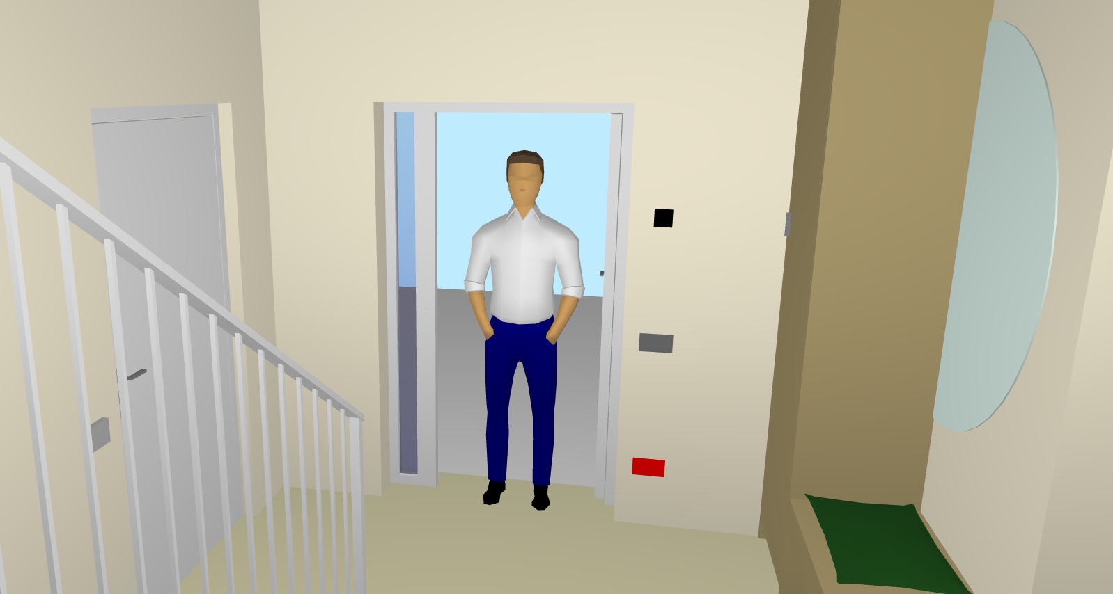

Would like to revive this topic. Have the same headache for a few past months regarding placement of light switches/windows roller shutters (grey), smart control/alarm panel (black) and power outlets (red).
There are two places where it is hard to decide: main entrance and main pathway to kitchen(upper zone)/living room(lower zone). Would like to have a proper placement practically and visually. As for the main entrance door, there is no such so far, hence some corrections can be made such as door-window placement on the other side.
Tried everything aligned verticaly, also control panel on the next perpendicular wall, light/roller switches on the wall inside, etc.
Any recommendations would be appreciated.

Front doors open inwards, so if you want to be able to reach a light switch on the way in don't have it on the hinge side.
In our country most of the modern houses' front doors open outside now. Can't say exactly why, but some suggests it was taken from a commercial buildings fire hazard regulations. What if I made them open inwards? Practical aspect, but would take inner space and probably disturb zone near the wardrobe.
The thing I've learnt and now offer as advice is to observe which hand you automatically use to open a door, for most people it's the opposite hand to the lock for a door opening towards youView attachment 393081, that leaves the other hand freeto find the switch.
Yes, I'm following this logic except that the door may be too wide/heavy and I will have to make a narrow window on the right of the door, hence the switches are a bit farther and harder to reach..
Up to a point, but I'm not sure that makes much difference since, even if the door opens outwards, the interior space immediately inside the door becomes essentially unusable (for a wardrobe or anything else).
