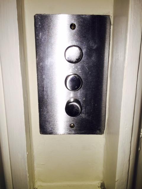

This is my first post here, I have a basic understanding of electrics.
I have a 3 gang dimmer light switch in my living room, i just moved into the flat 6 months ago. The top button/dimmer no longer activates one set of lights. There is a separate toggle switch which also turns on/off the same set of lights but it also no longer activates the lights. The fuse switch was not "turned off" hence it doesnt appear to be an issue with the fuse. The same fuse switch appears to control all lights in the same room, some of which are now working some are not.
The bottom button/dimmer on the same 3 gang dimmer is still working and turns on/off another set of lights in the same room. The middle button/dimmer has never turned anything on/off hence I think it is not wired up.
Do i need to buy a new 3 gang dimmer and get an electrician in to replace it, or could the wiring from the top dimmer be moved to the middle (unused) dimmer?
Any help would be appreciated.

Dimmers do die - sometimes just because a bulb/lamp dies. If the dimmer is the problem and middle dimmer of the 3 really is not connected to anything, then the electrician could probably move the light in question to that. If it is wired up, the electrician will be able to advise and supply whatever replacement is needed - or trace the cause of the fault, and rectify, as necessary, if the dimmer is not the problem.
Do I take it that you've checked that it's not just the bulbs/lamps that have died?
Do you own your flat? If it's rented, then it would really be for the landlord to get this problem sorted out (and you might not be allowed by your tenancy agreement to arrange/do it yourself).

hi john, sorry that link isnt working for me. its just a basic 3 gang dimmer switch, mounted vertically. if there is a fuse in the dimmer that has blown then why is the bottom button still activating lights but not the top? or are there three fuses inside. I havent opened to check.
3 gang...top dimmer.
Have you got something like this:
http://www.screwfix.com/p/varilight...g - Lighting&gclid=CIC4oKqH2sECFcKWtAod_G0ATA
mounted vertically?
Could there be a fuse in the dimmer?
The one you describe with a separate rocker switch might be Volex branded and have a BS546 fuse fitted.

In that case, it's functioning would probably be dependent on the dimmer switch remaining 'intact' - so if (as we suspect) the dimmer died, it's probable that the toggle switch would also stop working.

Hi SBU
Very few dimmers have fuses built in. But the switch you described sounded like one of them.
There is one fuse per dimmer.
Can you post a picture of your switch?
hi again, can the 3rd button/dimmer still work if the fuse is blow? i'm not sure it would work if there is one fuse for the whol gang. Or are you saying there are 3 fuses in a 3 gang dimmer?
picture is attached, thank you!
