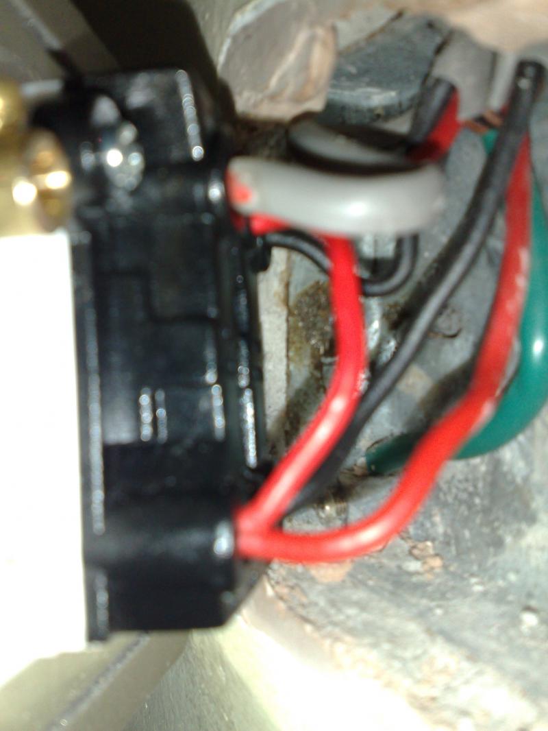

Hi,
Well in the process of changing the light switches to new silver switches.
However the double swithc is being a pain.
I have tried wiring it and it doesnt give the right result, Anyone have any ideas how it should be wired.
It is a double socket.
Its in the living room.
Controls the light in the living room-> Thers also another wtich in that room the contorls the light.
This switch also controls the upstairs landing light.
The upstairs landing switch also has a switch upstairs.

How was it previously connected?
Was there an extra link wire which is now missing?
It seems odd that you can get the landing light to work from upstairs AND the living room light to work perfectly from both switches with what you have there.
Yes, It was previously connected and running pefectly.
I took the old switch off without looking at the way it was wired.
What a silly mistake!
Yes there is an extra wire, And extra red wire which links two wires together, Im aware of that.
That extra wire is being used but is not show in the picture.
Do you no how it is to be wired?
Thanks for any replys!
What config has worked for you so far? It's not possible to know from the wires you have there without testing, but there is a chance the single red is the permanent live (COM) which will also be where the link wire goes, and the red/black pairs are the strappers (L1/L2)
Well. Hers another picture:
Top Row:
COM: Grey Sleeved/Red
L1= Black
L2= Red Also another red that links to the other L2.
In that order.
Bottom row:
COM: Nothing
L1= Black
L2= Red Also the red that comes from the other L2.
With this setup.
The living room lights work perfectly from both sockets in that room.
But, The upstairs landing light does not work with this switch.
But if i go upstairs then the and use that scoket then it turns on.
Thats the best setup, Obv theres something connected wrong.
Thanks for your replys!

The method I suggested in my previous post should work. (i.e. the link wants to connect COM-COM, all others the same as you have them)

Aptsys: Your suggesting i should take out the link from the reds and link it in the Com terminals,
Should i leve the grey sleved red also in the com while linking them?
Thanks!

Would suggest single red to com along with a link wire to the other com terminal, L1 and L2 to one red/black pair and repeat for the other switch with the remaining wires. I would, however, dispute your comment that you understand what the wires are for - if that were true then you wouldn't be having this problem :)
Thanks!
Yes that's right. Leave the red/black pairs in the L1/L2 terminals.
