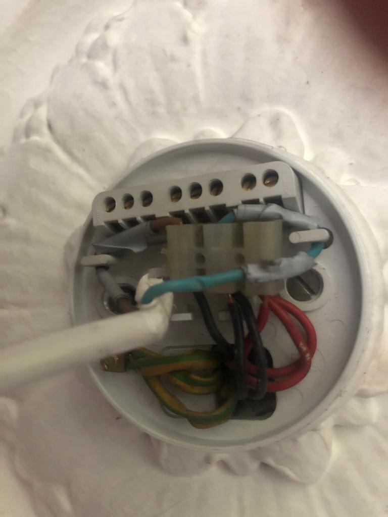

a light switch used to work but one time the light stayed on when we tried to switch it off. We replaced the light switch (two different switches) but the light won't go on. Electricity is coming to the switch. Any suggestions? here is a photo of the ceiling rose.

Why have you shown a picture of the ceiling rose when you are having trouble with the switch?
Are all the wires making proper contact? They must have been otherwise the light (or others) would not have been working.
Presumably there are only two wires at the switch so not much to get wrong.
Put them both in the same terminal and see if the light works.

fair comment about the rose. we put both wires in the same terminal and the light bulb doesn't go on.
Ok. Fair enough.
Assuming the bulb is alright, check all the terminals in the rose and light and make sure the wires are all secure and terminated properly.

yes, changed the lightbulb. we've gone and bought a new rose and going to change just the flex part. I'll report back later
What instrument are you using to verify the voltages present at the switch ?
You need to do some testing at the rose and the switch .
Neon screwdrivers are not suitable for diagnosing electrical circuit problems.

It may be something like the original had
L3, L2, L1 and the replacement has
L2, L1, C or Com or
2W, 1W, C or Com
The colours indicate the different lable on different makes for the same terminal.

Surprised no one has suggeted to the OP to make sure the connections he has made are actually to the bare wire ends and not onto the insulation.
