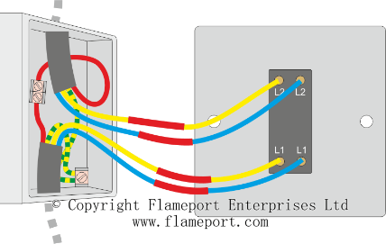

It looks like the the first picture is of an Intermediate switch, and the second a 2-way. Which is the old, and which is the new? IIRC intermediate switches "cross over" the four terminals, so would need the red and black cables connected top left-bottom right or top right-bottom left.

Either way, didn't he join the wires at the switch to see if it the lamp worked?
They do one way - cross X, the other way - straight ll.
I have read that several times and still can't figure out what you mean.
As long as the two wires from one cable are at the top and the two wires from the other cable are at the bottom, it doesn't matter which way round the colours are - although it seems logical (not sure why) to fit one colour on one side and the other colour on the other side.
