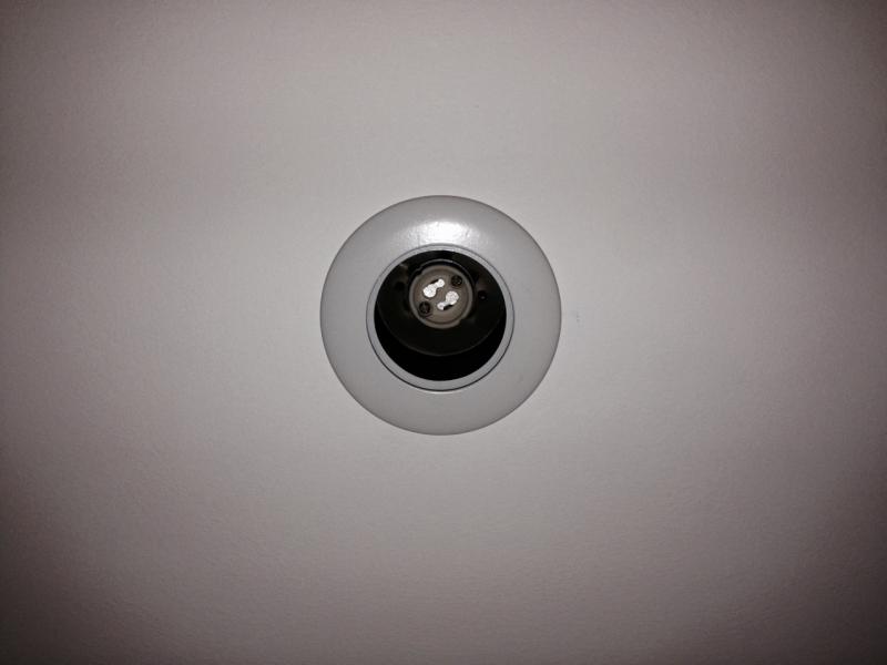

Can you post us a picture of one of the fittings without a lamp in it?
There should be a direct LED replacement available, which will come on to full brightness straight away, be brighter and use even less electric than your existing lamps.
hi this is a pic of fitting.
an led one would be good, ideally it would be good to get one that just fits existing fitting..
I think the lamp iggifer links to will be a bit short for your fitting and may sit too far inside as the lamp holder is fixed in place.
If you go for something like a 9W LED, you can see they are much longer, so should be more suited to your fitting.
Unfortunately they're out of stock at tool station, but I'll have a look else where and get back to you.
