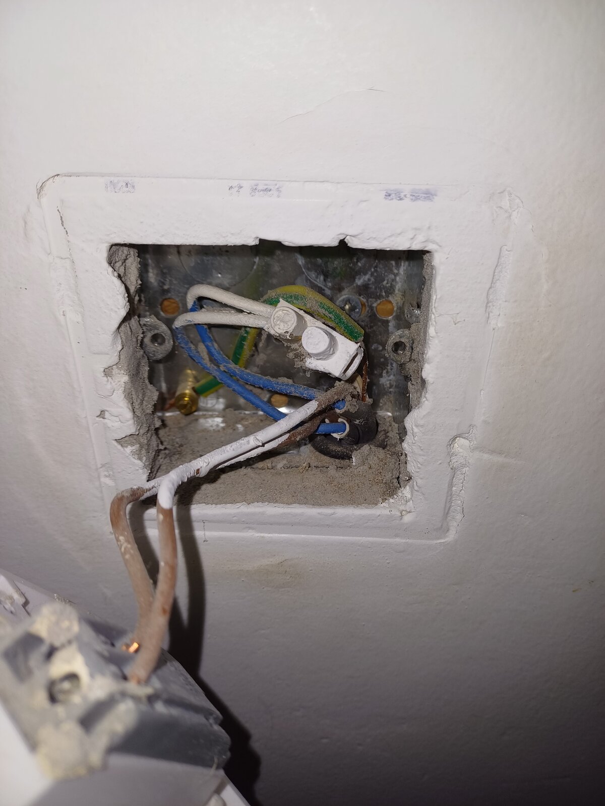

In 1930s extended bungalow. Just found out that the lights in the two attic bedrooms are wired to a 2-gang socket in one of the rooms. Is this usual, safe and legal?
Look for a fused connection unit ,follow the cable from the donor socket.

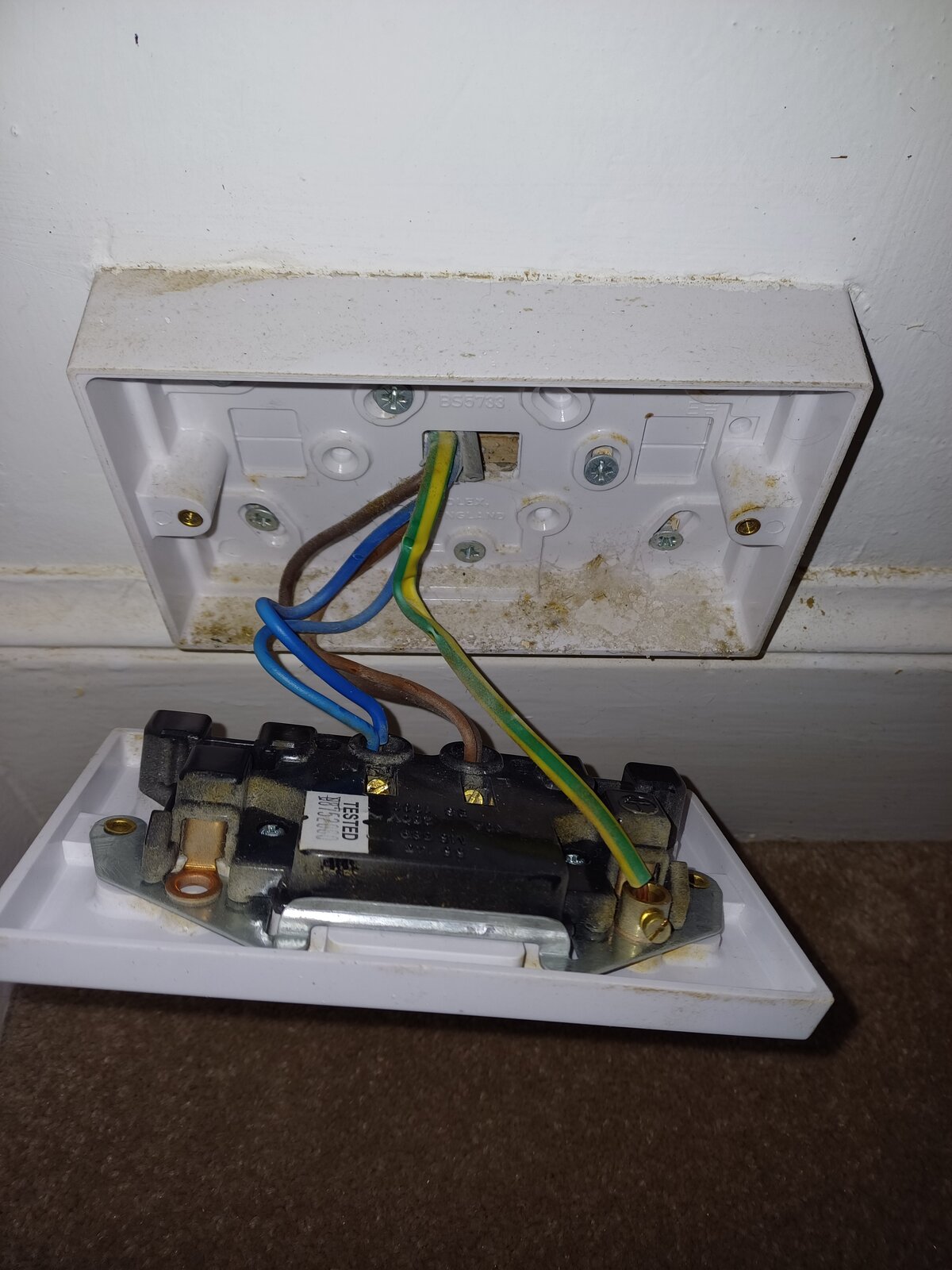

All I can show you is the light switch wiring and the socket wiring. I might have to remove the surface box to see what's behind it. I was trying to replace the surface box with a buried one.
The light switch requires re-terminating as you can see bare copper on one of the terminations. If you do decide to install a sunken back box you may find you'll need to fit it at least a couple of inches above the surface mounted box as where it is you may find it difficult to plug equipment in as the leads may snag on the skirting.
The wiring inside the light looks 2.5mm T&E but I maybe wrong which is oversized for lighting but an FCU would make it easier for maintenance.

I think I see 2 different sized cables in the socket and assumed 2.5 & 1.5mm²

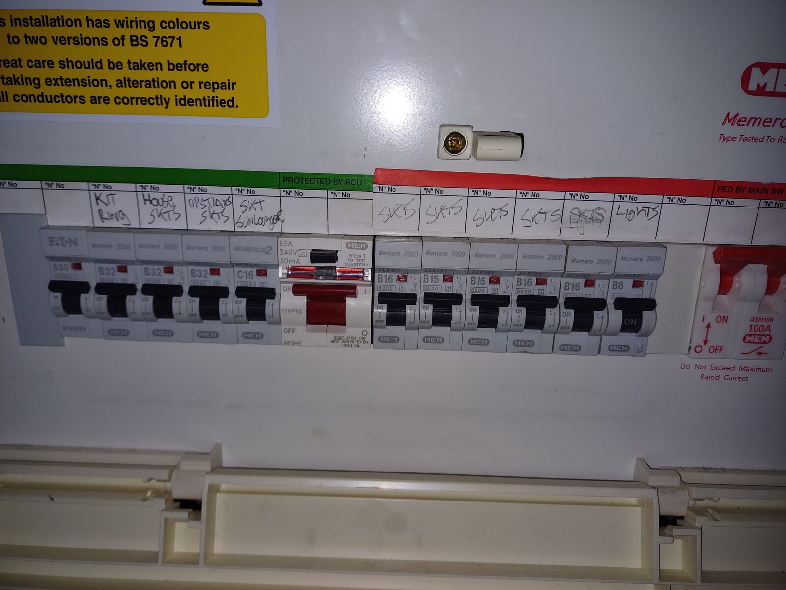

do you know what size fuse or MCB protects that socket? It wouldn't be the first time we find a socket on a lighting circuit.

Thanks for the advice about the socket position. It's old lathe and plaster walls, so using a sucken back box might be a challenge. I've re-terminated the light switch.
I think the light wiring is 2.5mm T&E. Same as the socket. Are you saying this will be OK though if I replace the standard light switch with a fused one like this?
Is the socket on the lighting circuit or the light on the socket circuit?
I'm not sure about the MCB, as the labelling on the box isn't overly helpful. I'll have to try each breaker one-by-one tomorrow in daylight.
The house has a more recent extension, with it's own consumer unit. I think the 50A breaker is for that.

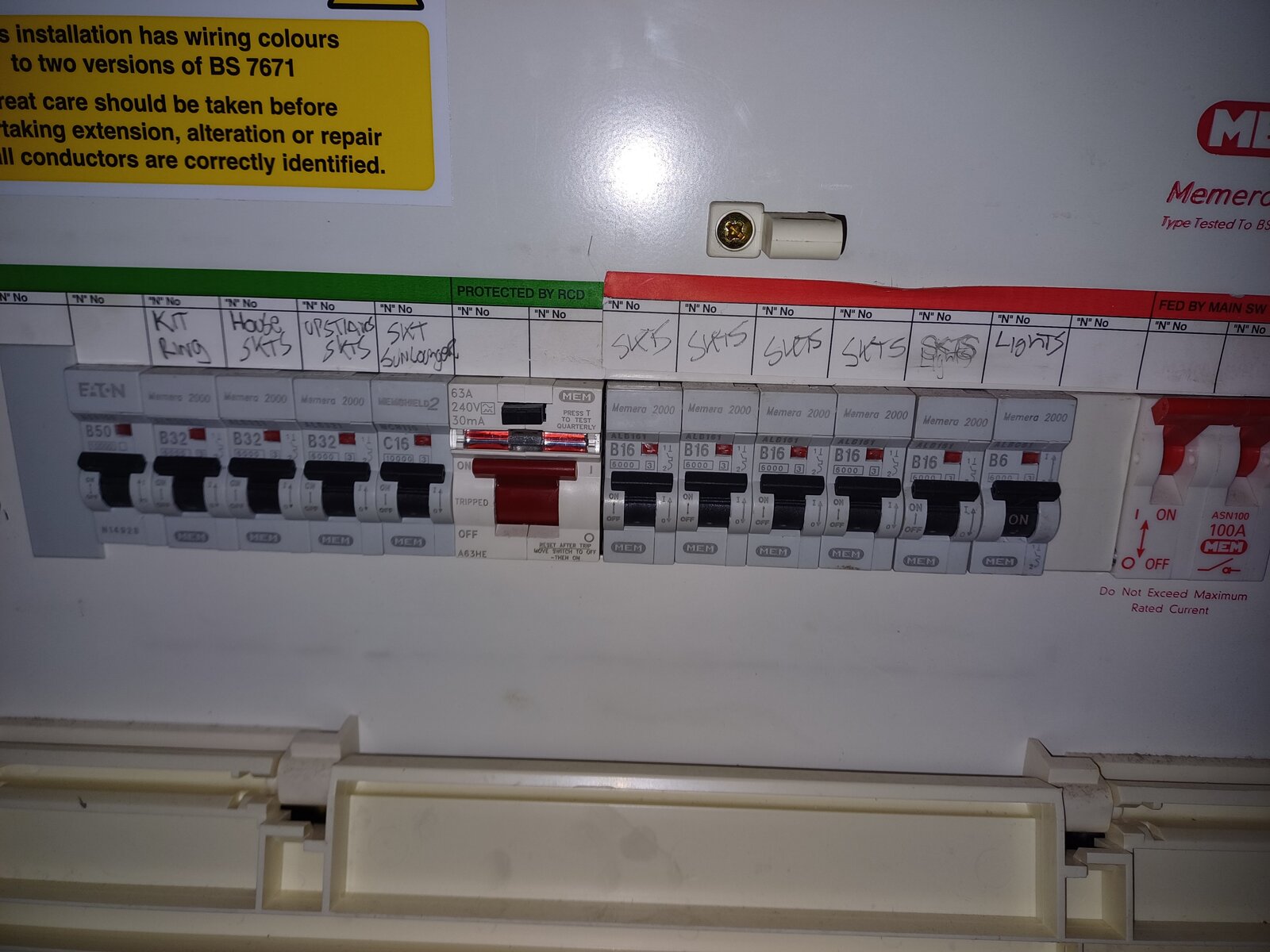

That is a very popular solution and I have that twice in my kitchen for under cupboard lights.

Which circuit breaker protects the circuit that the socket is part of ,and what is its amperage rating ( B16 = 16 amp, B32 = 32amp ,for instance) ?
