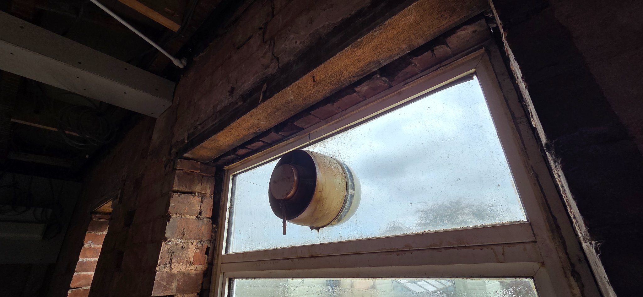

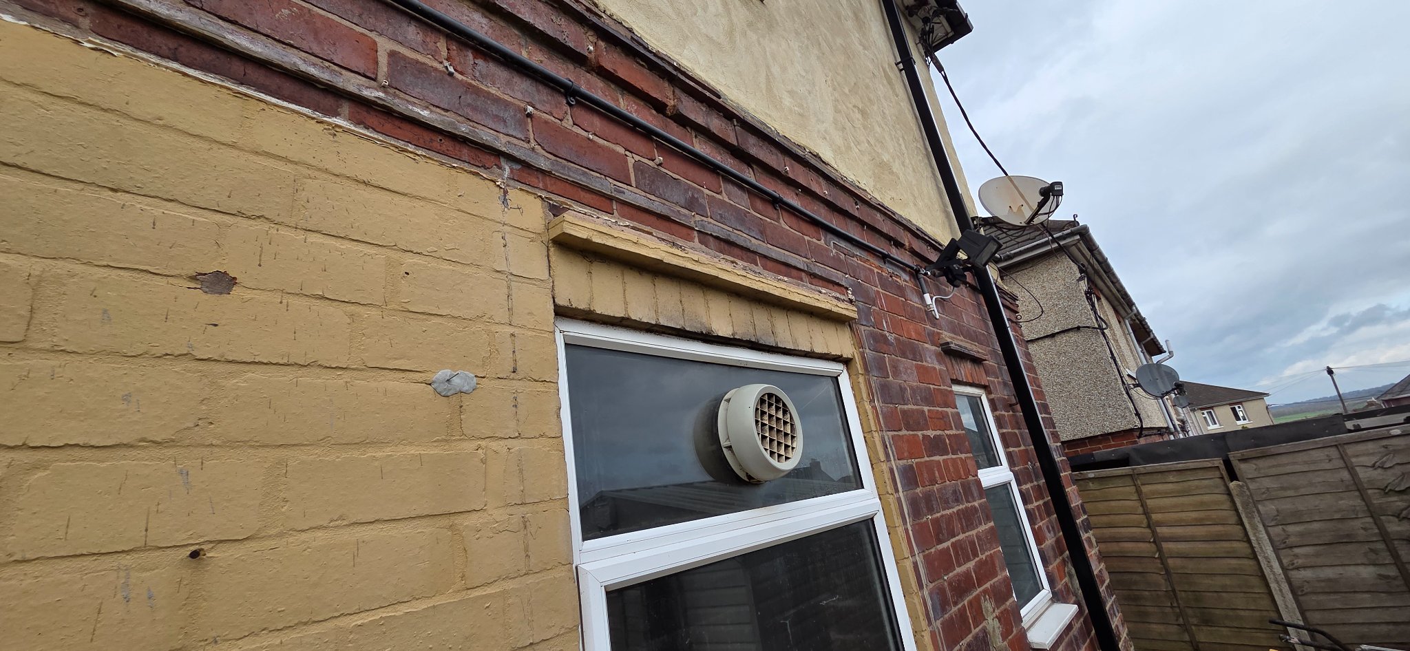

The kitchen lintel construction looks different from the rest of the house. On the inside, it also has a timber lintel. On the outside, it looks like there is a single brick course over the window (not forming an arch) and then a small triangular section of brickwork above it. My assumption is that there is a piece of steel built into that area supporting the brick course above (rather than a visible concrete lintel like elsewhere in the house).

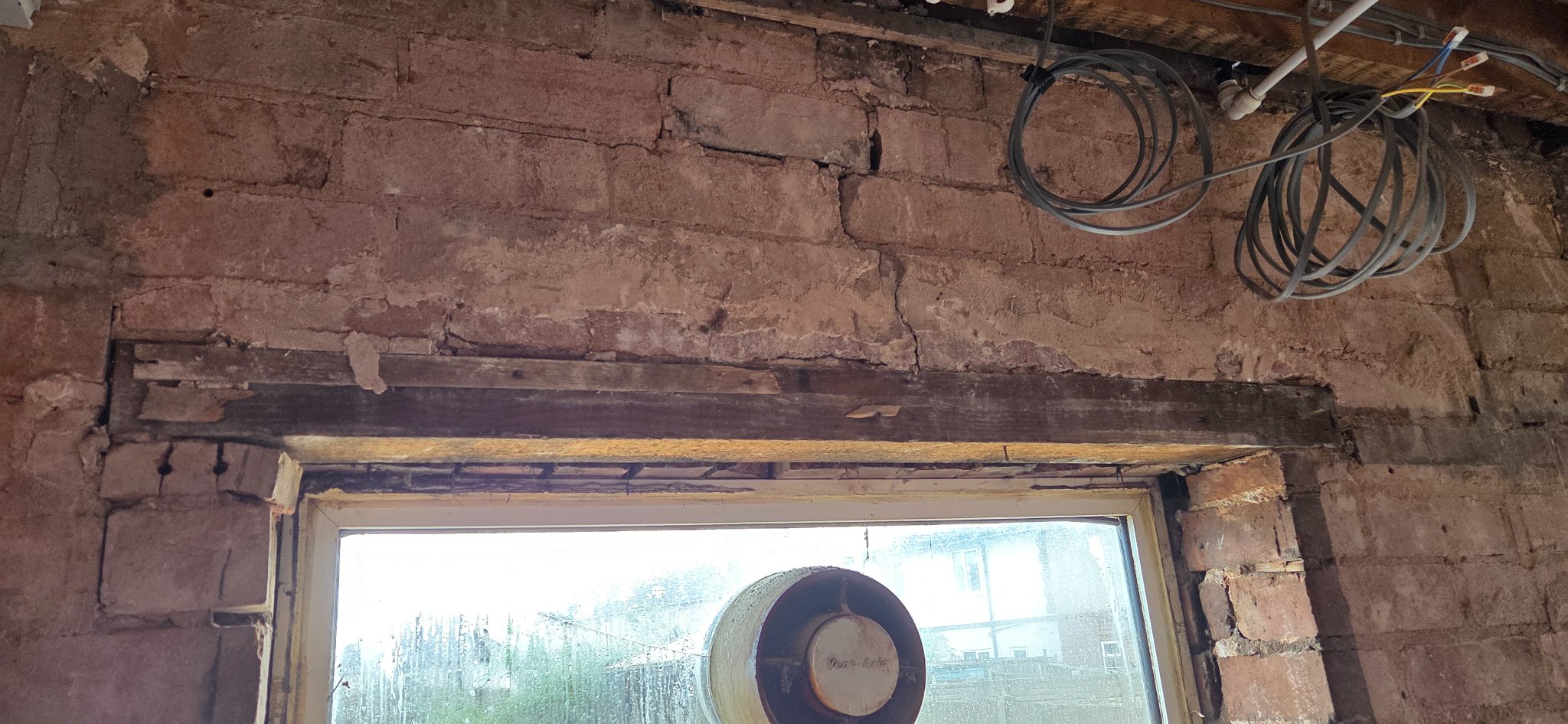

On the larger window (1100 mm), I have just removed the old plaster internally and found that the timber lintel is loose enough that it looks like it could be removed by hand. There're also some signes of movement/subsidence (probably as old as the house itself). The timber itself is actually in good condition (not rotten and not visibly bent).
At this point, I believe I need to replace the lintel arrangement on this window. Is the proper cavity wall lintell supporting both inner and outer leaf the only option?

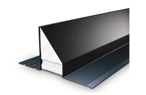

Belt and braces would be to fit a proper cavity lintel/cavity tray, or may get away with just an angle iron lintel on the outer. If you had access from outside you could try and form a tray with dpm and still keep the inner skin as it is. And add weep holes.
Thanks for the reply 23vc. I decided I will fit one of these.
Don't have much experience with cavity walls so I thought it's better to trust the experts. I think I may have 2 strongboys xl with some props laying around in the garden so seems like plenty for such a small opening. Thanks.
Often happens with timber lintels, as they shrink across the grain. The brickwork then self-arches. It does not mean the lintel is now useless as wind and other factors could soon convince the masonry to 're-load' itself.
Leave the internal timber lintel if it's sound, just point and gap fill. Fit something like and IG L10 or Catnic ANG lintel to the external leaf only, not angle iron - which will rust.
You'll need to either lift the lintel and fit a knock on to the top of any new frame, or give some thought to the bearing and cutting bricks nicely.

I suspect the reason there are no external lintels, is that when the house was constructed, the old timber window was sufficient to take the load as the house was being built. Now those have been replaced by plastic, the old timber windows with the structural element have gone with them.
