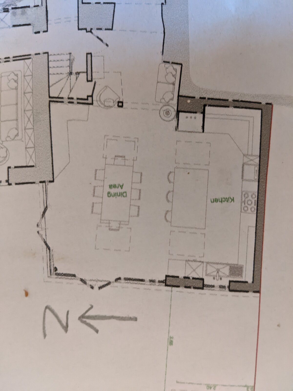

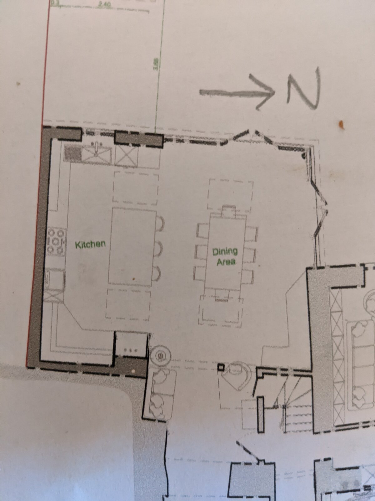

Hi all,
I wondered if anyone had any insight as to the best location for rooflights in a flat roof..... We want to maximise light into our proposed kitchen /dining area...
I don't much like roof lanterns, so am thinking perhaps 4 rooflights .....
Any ideas?

I would just have 1 reduce the risk of leaks in a few years time.
I've rethought this and am now keen on a roof lantern! Still got same question about sizing though...
How big does it need to be?
I find roof lanterns ugly
What is the orientaton of the room? If it get's direct sun it will be like a green house with all that glass from the solar gains

Bear in mind the upstands to the roof lights will be around 350 to 400mm if a warm roof, so a single lantern might look better.
Yeah, and look a lot taller from within....
