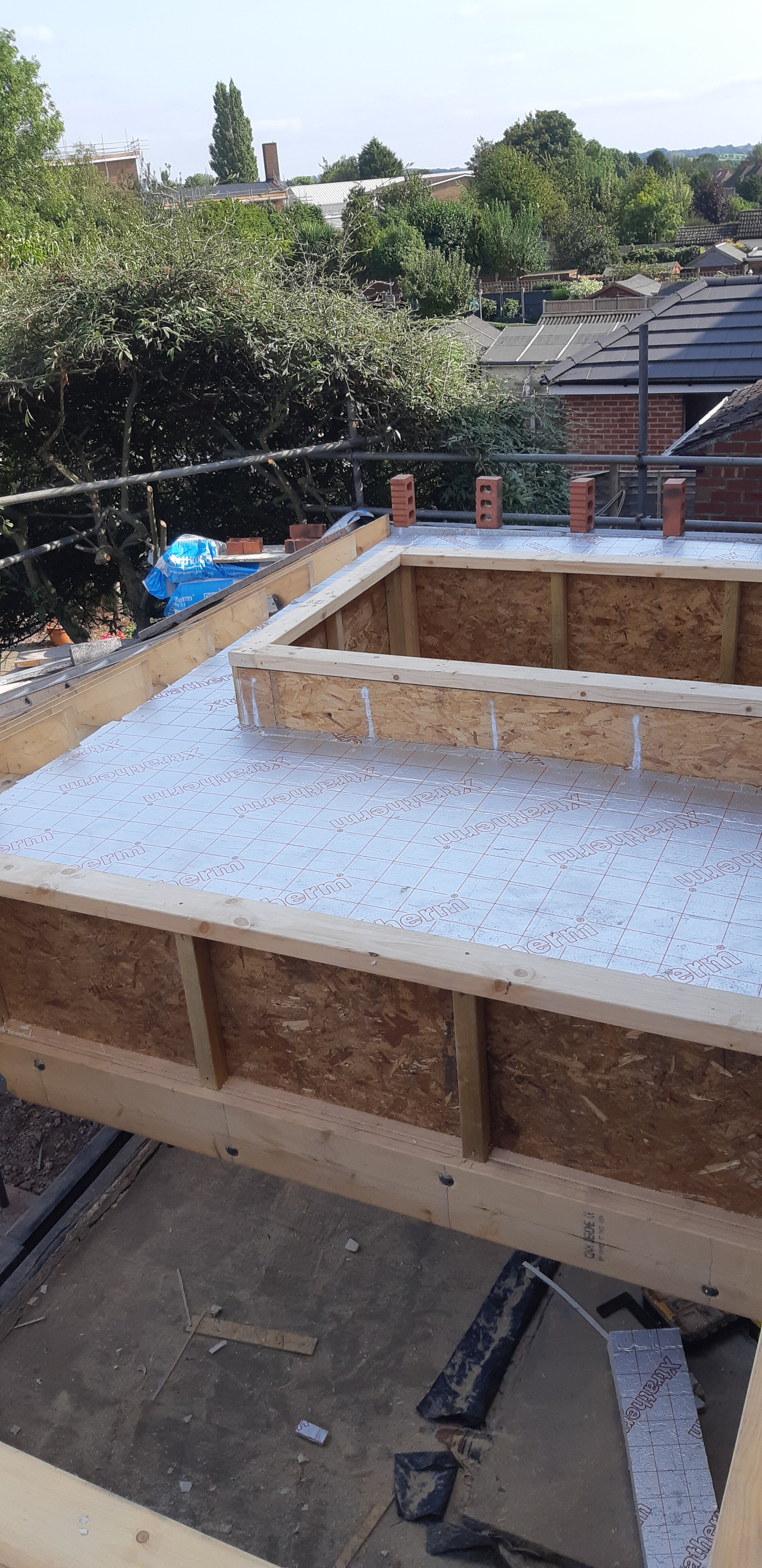

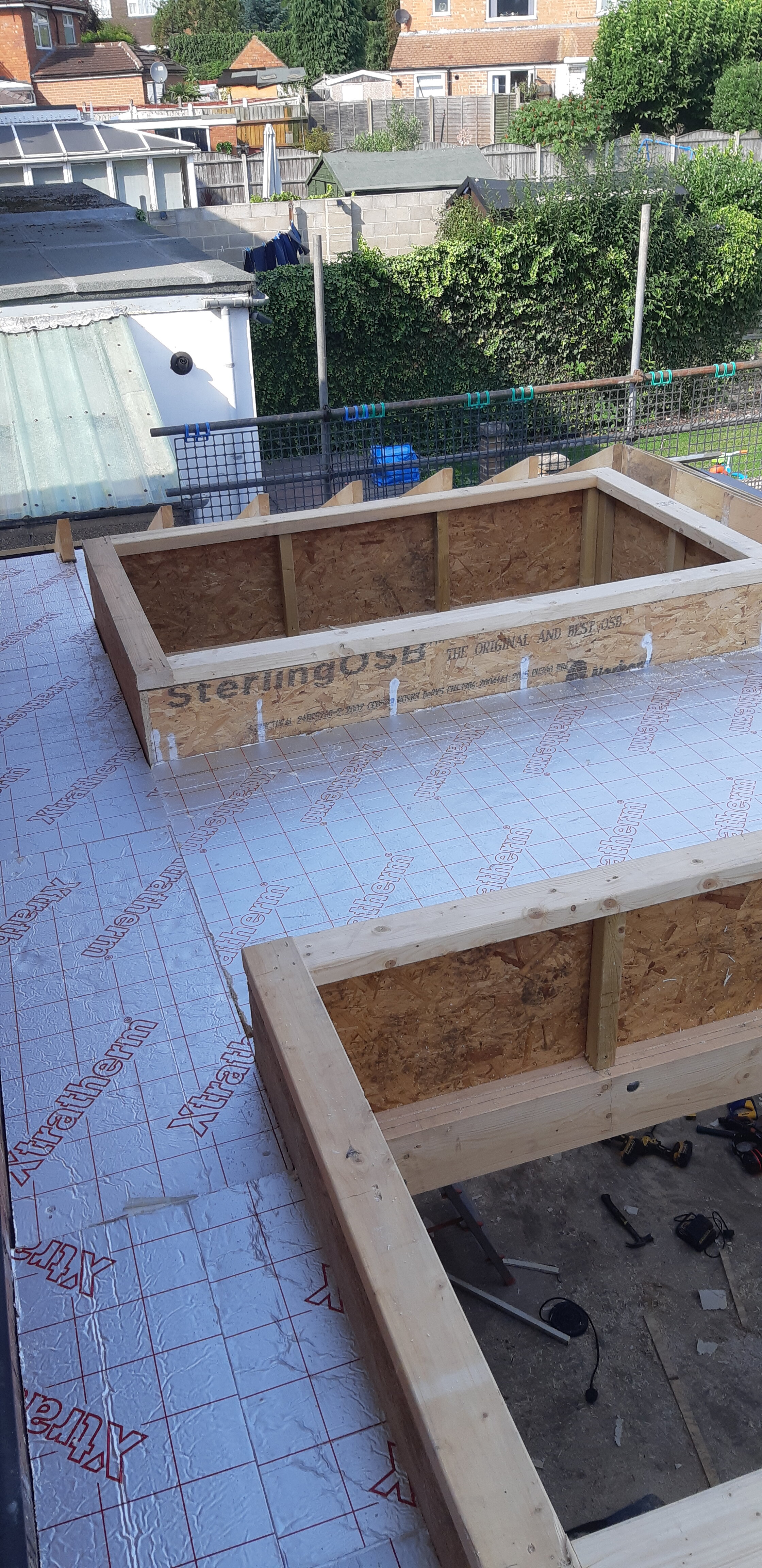

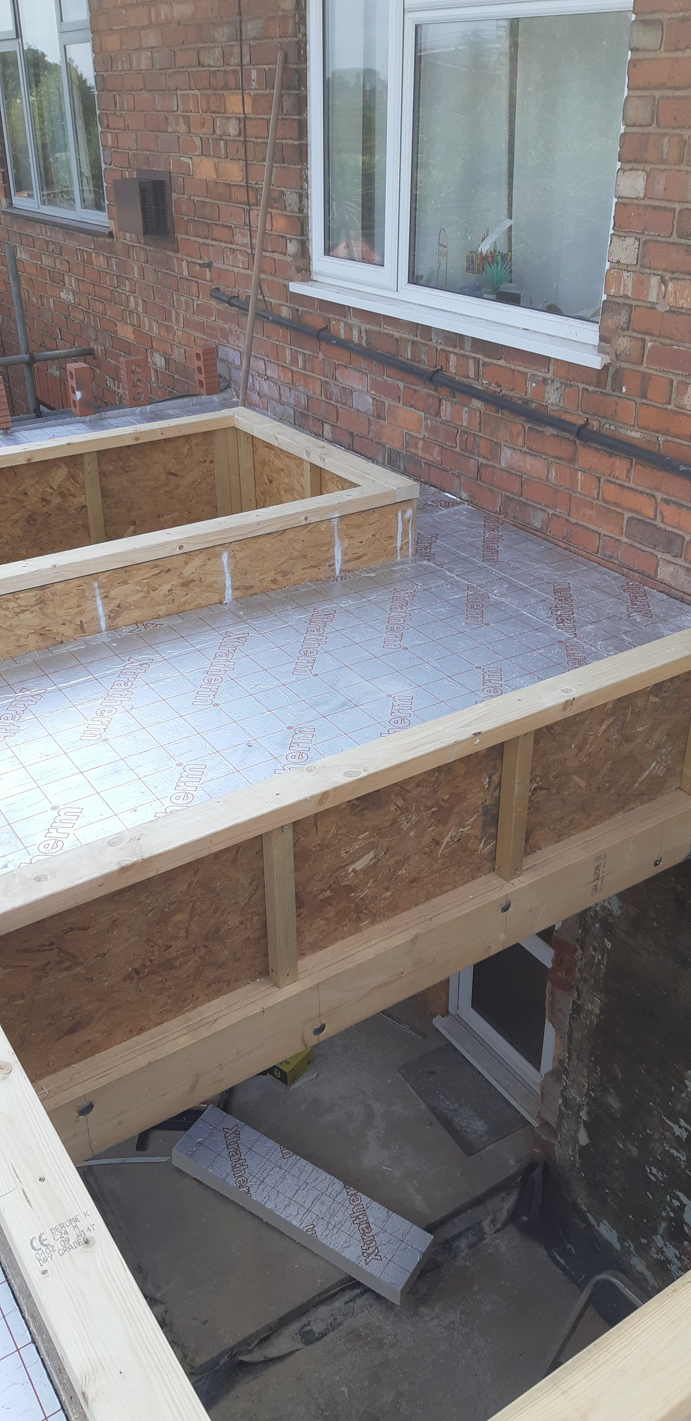

Those eagle eyed amongst you will have noticed I used 50mm timbers for the upstand uprights so that I could add another 25mm to face of the internal uprights (as well as stuff between the uprights) so as to help with the thermal resistance.
Nice. I'll be copying this insulation detail....
